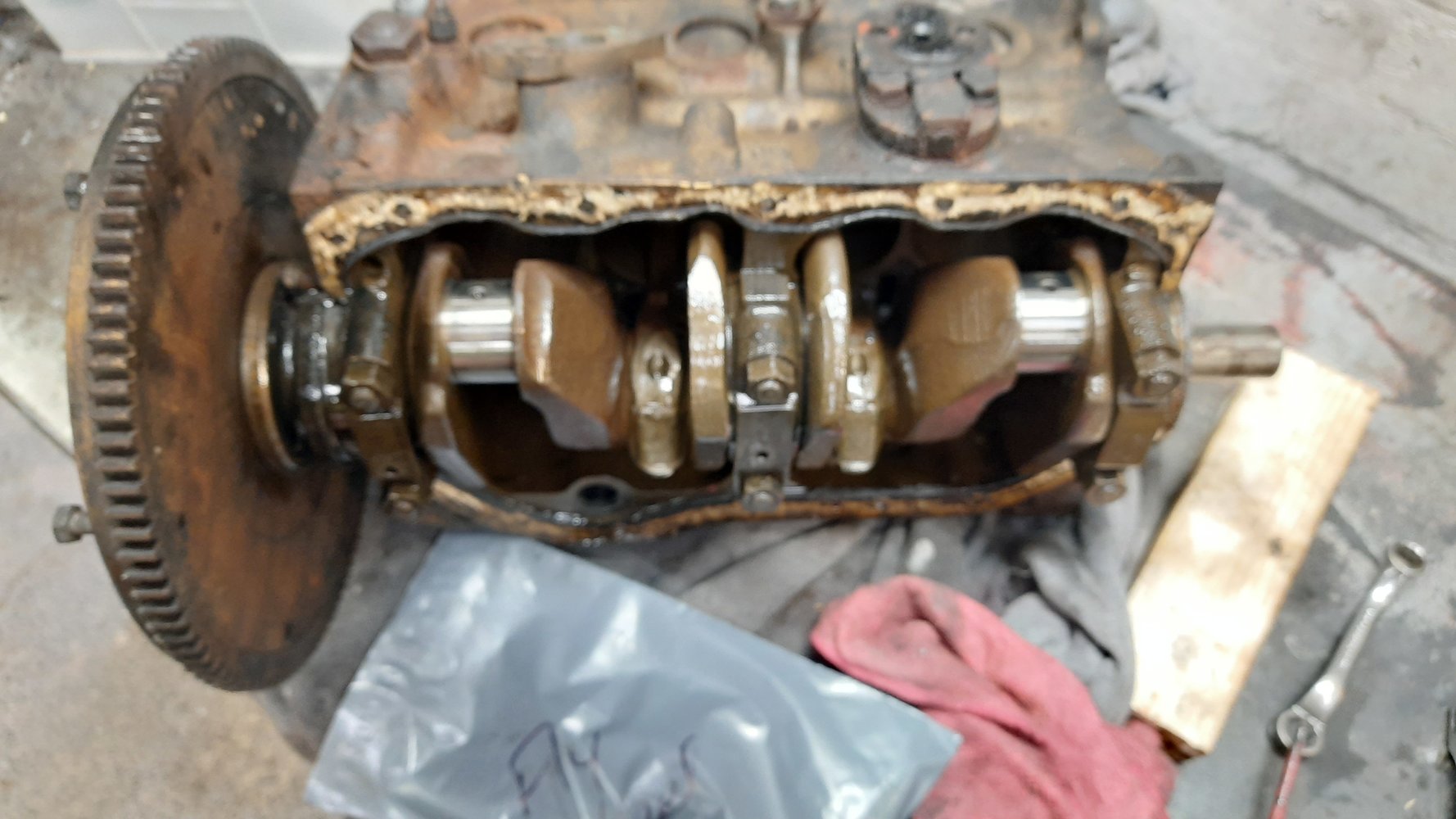

I recently had a K series that was solid, starter wouldn't turn it, breaker bar on crank wouldn't. I knew there was a head gasket issue so it was coming apart anyway
I stripped the engine and found the coolant and oil had mixed, flowed round the system and then set solid when it cooled
Every bearing was coated in a thin and very sticky brown gunk which cleaned off easily with wd40 but was locking the crank solid
It isn't always pistons!
