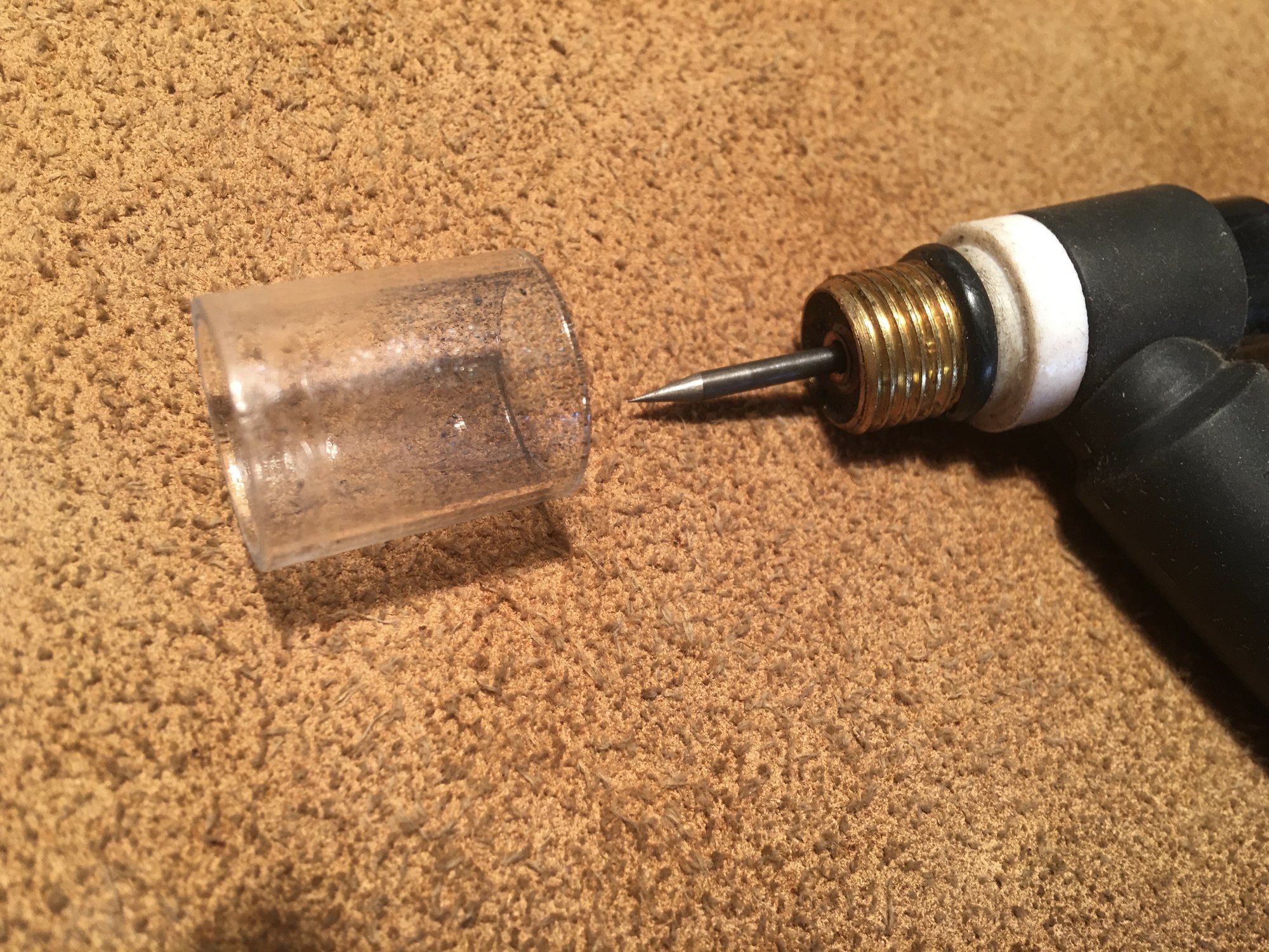

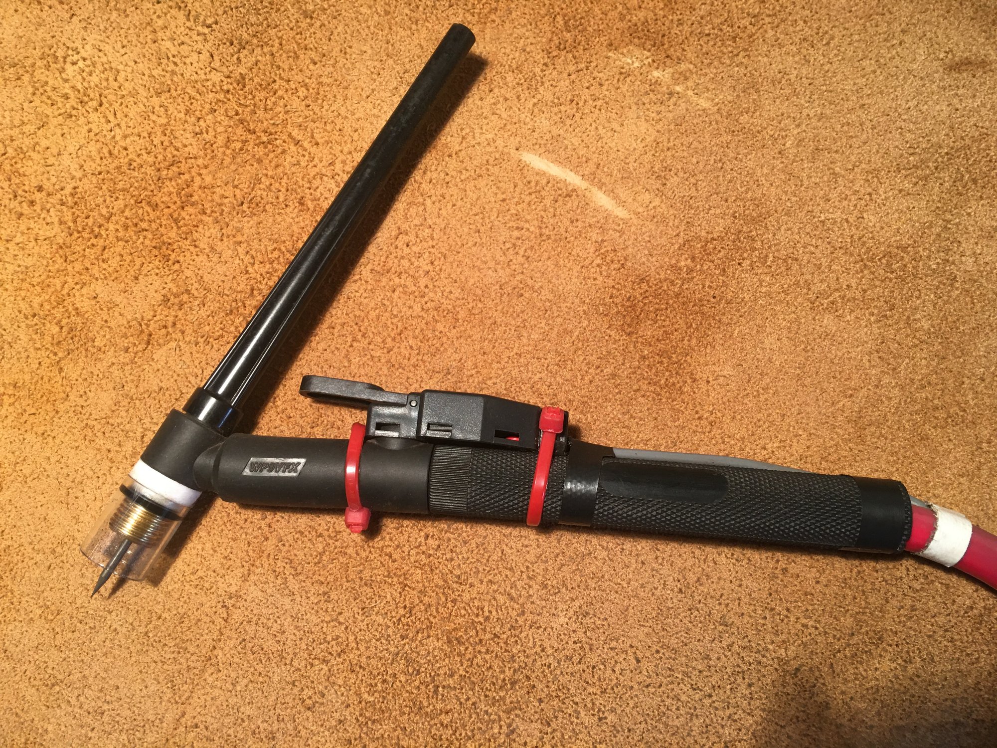

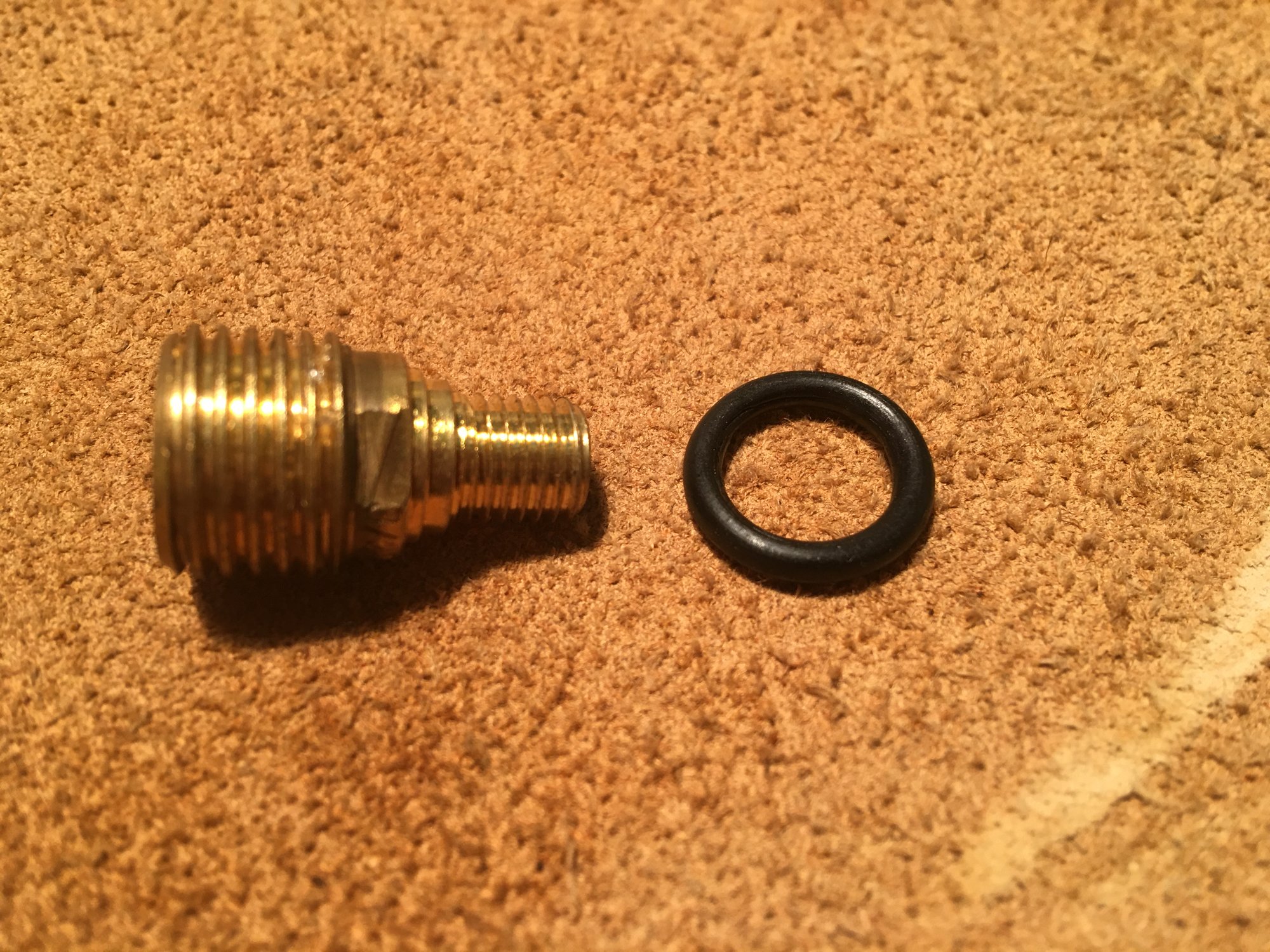

I think that I mentioned this quite a while ago, But here are the pic's, I recently shared this with another member but thought others may be interested, WP9 tig torch adapted to take a clear/Pyrex shroud,Just required a heat resisting viton 'o' ring and a replacement tank from a vape cigarette, Both available from ebay, It turned out well.
