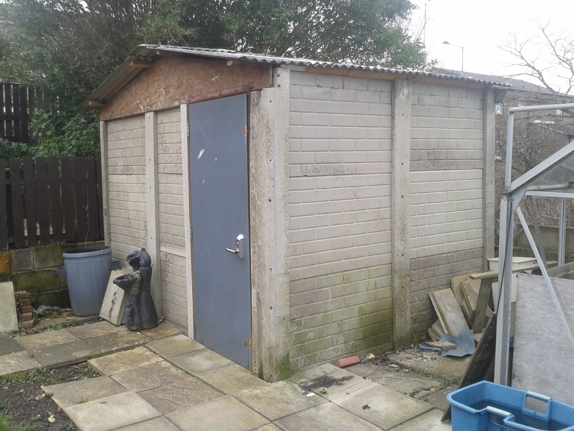

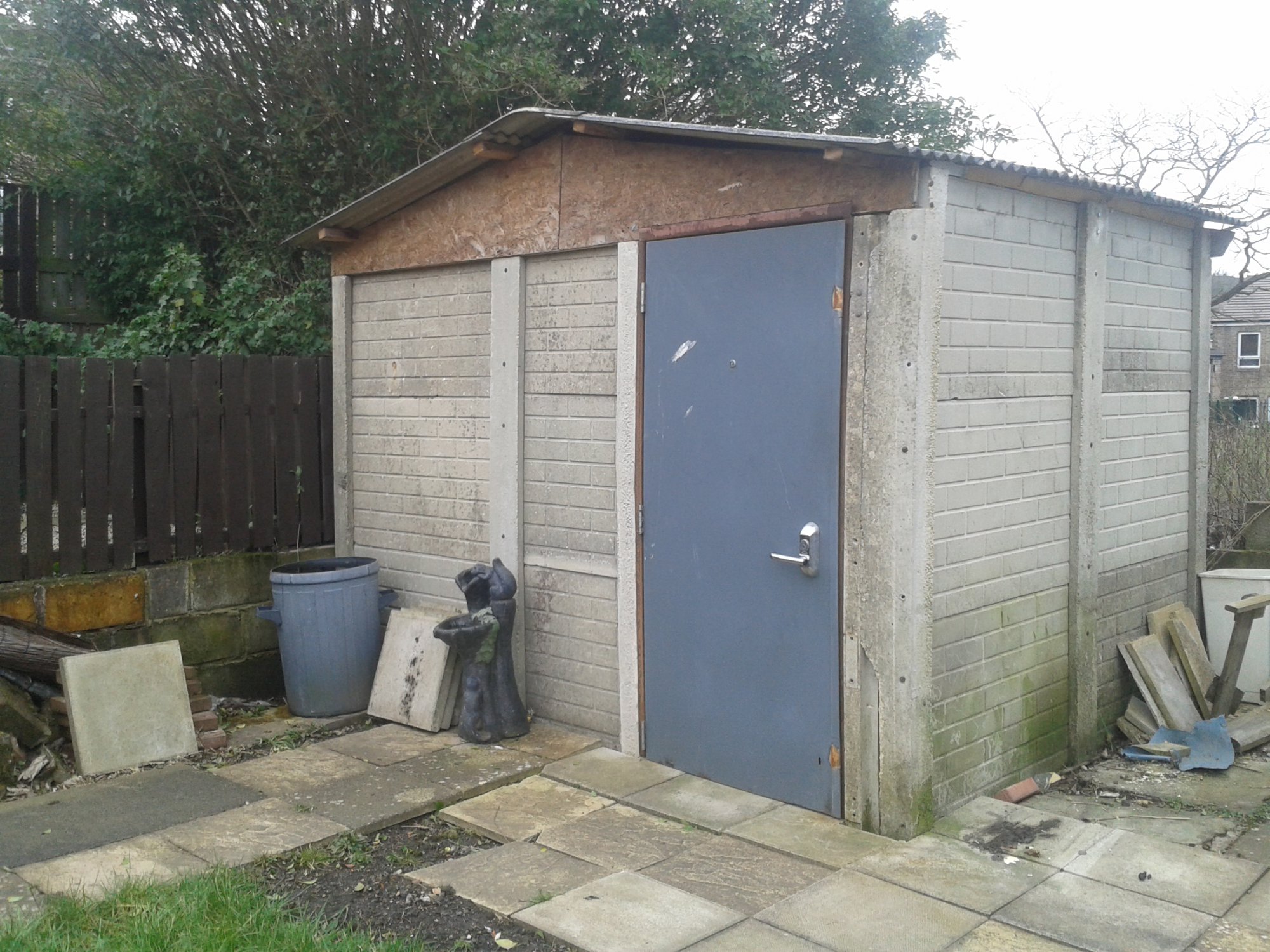

Gonna put a new roof on the garage (again..) and am gonna do it properly this time.
I'm basically gonna do as someone else on here did, I forget who, and build a kind of shed inside the garage if that makes sense? So the roof will rest on timber posts, not on the sectional walls. Currently the joists consist of five lengths of angle iron which span the walls and the tin roof is bolted down to these. I want to remove them, but am concerned that they may be holding the walls together, like a spreader bar type thing..? Does this seem likely or am I being thick?
