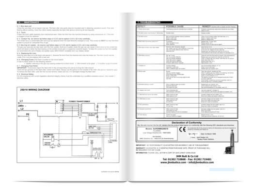

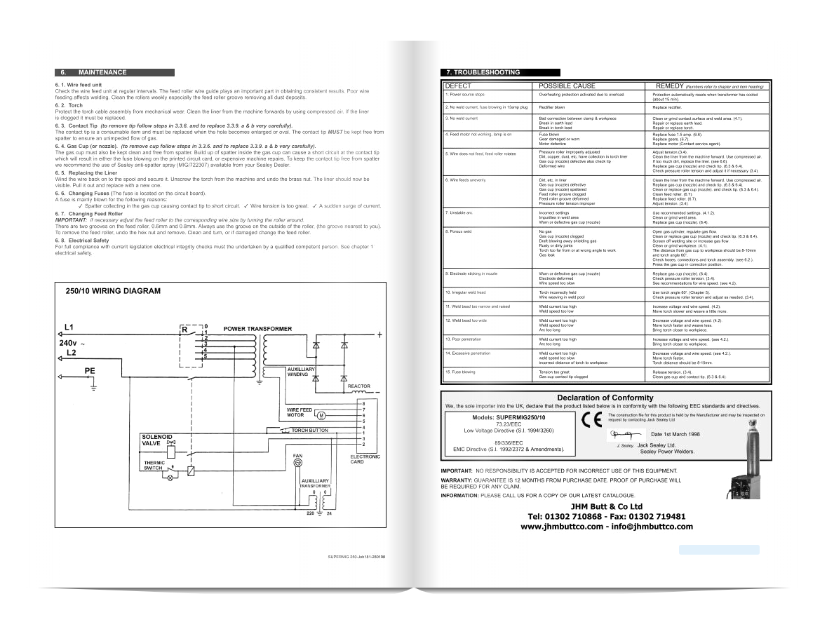

My friend has a sealy supermig250/10 and unfortunately the main switch has gone. It has on it bremus series 12. I have contacted sealy but as helpful as they are as its quiet old they don't have a manual they have suggested a switch but carnt guarantee its correct.
Does anybody know were a can purchase the correct switch and have a manual with a wiring diagram please as my friend has made the silly mistake of not taking photographs before removing it. Long shot I know thanks in advance
