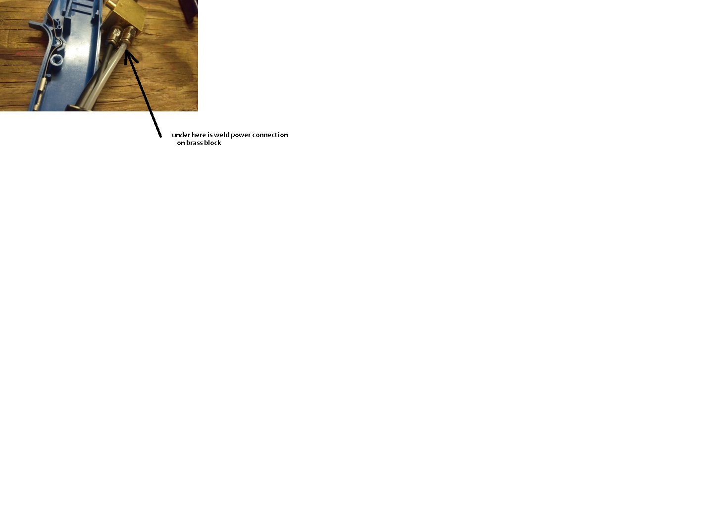

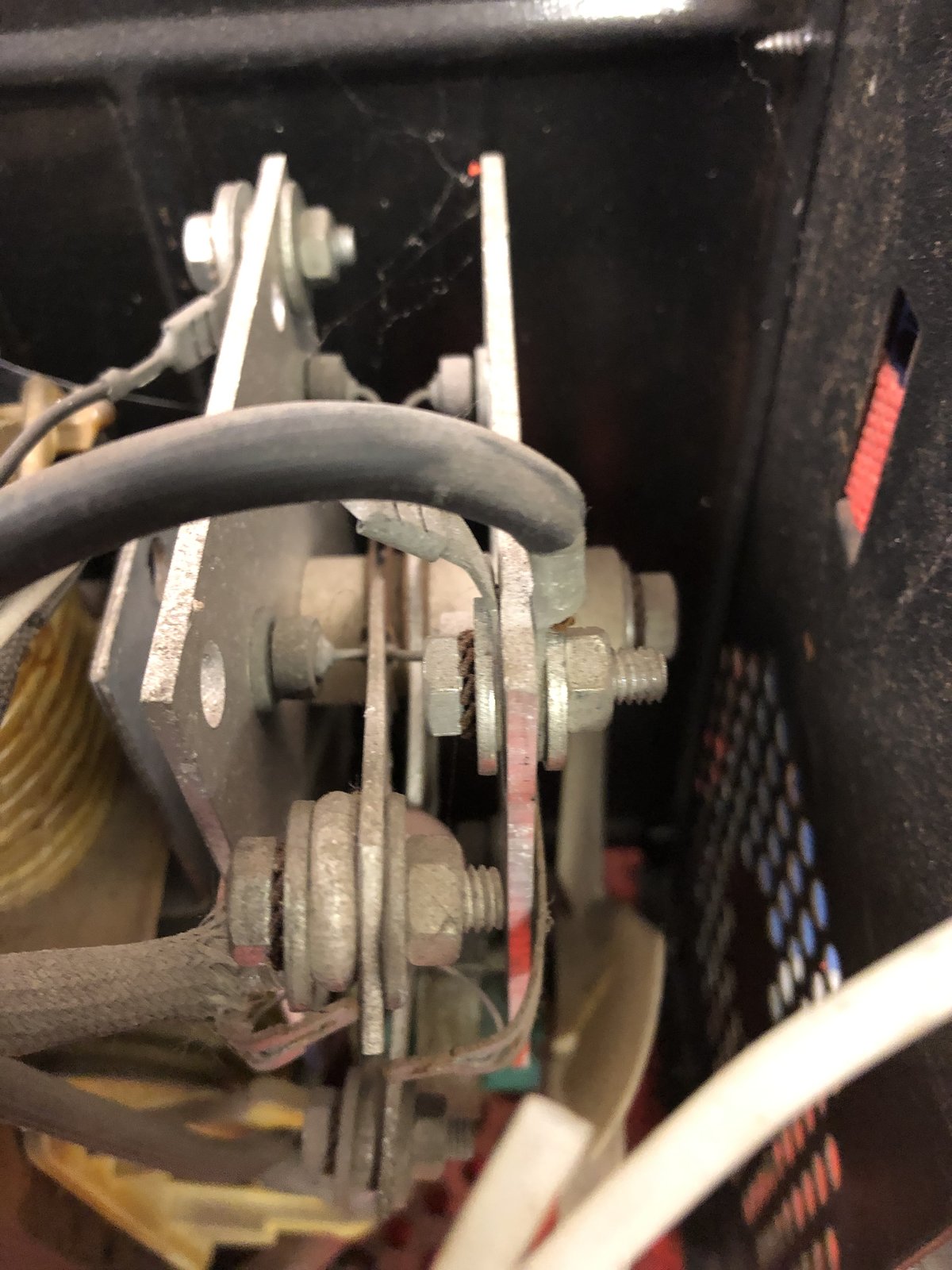

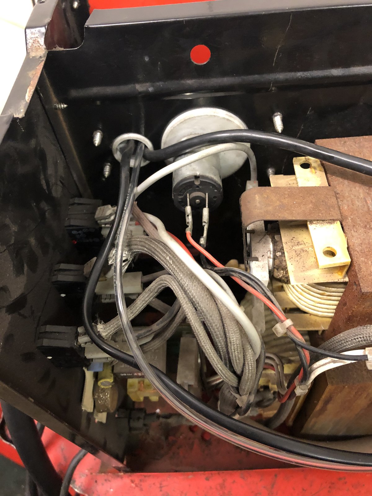

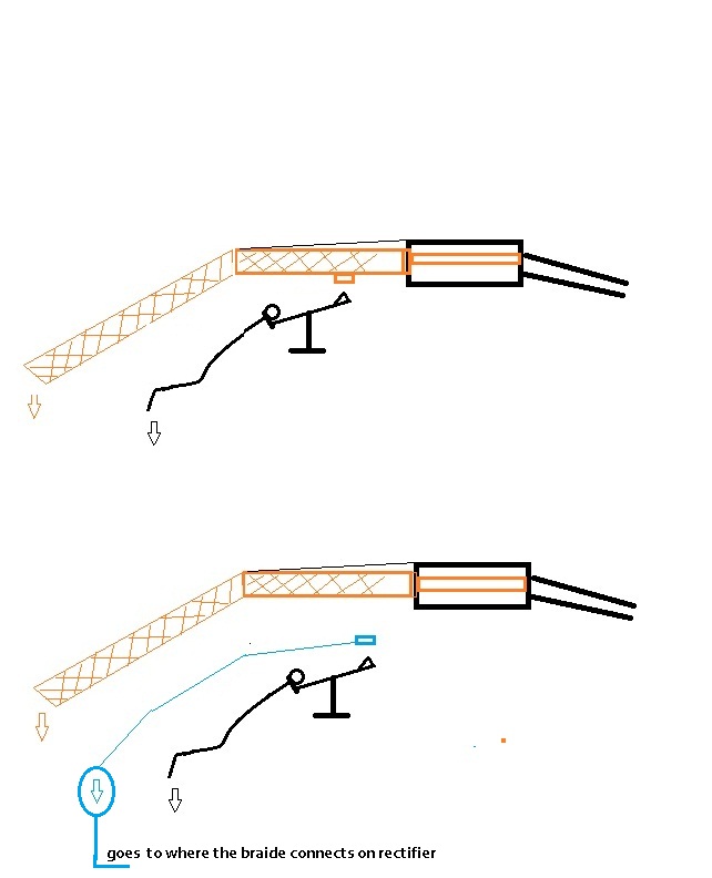

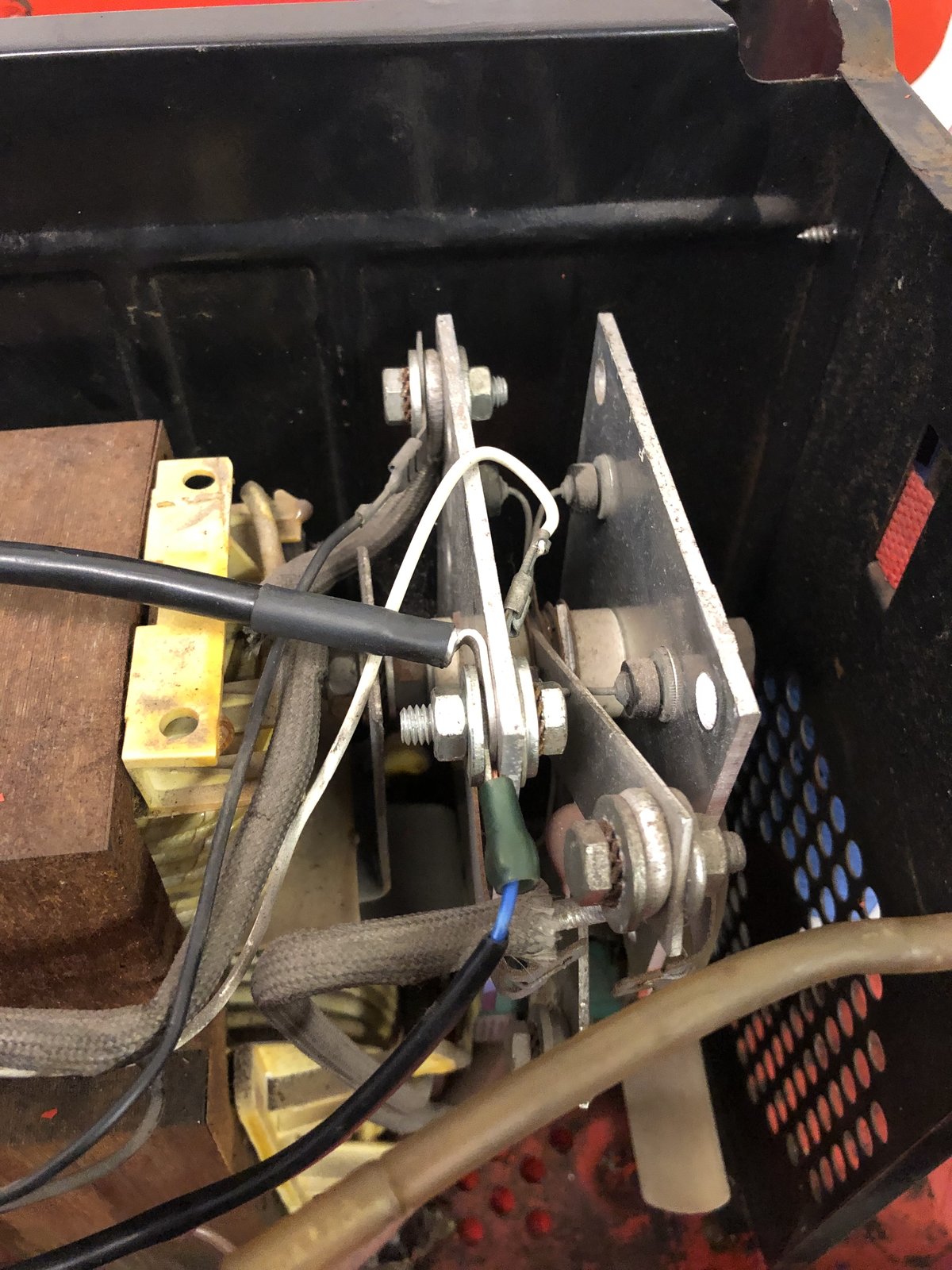

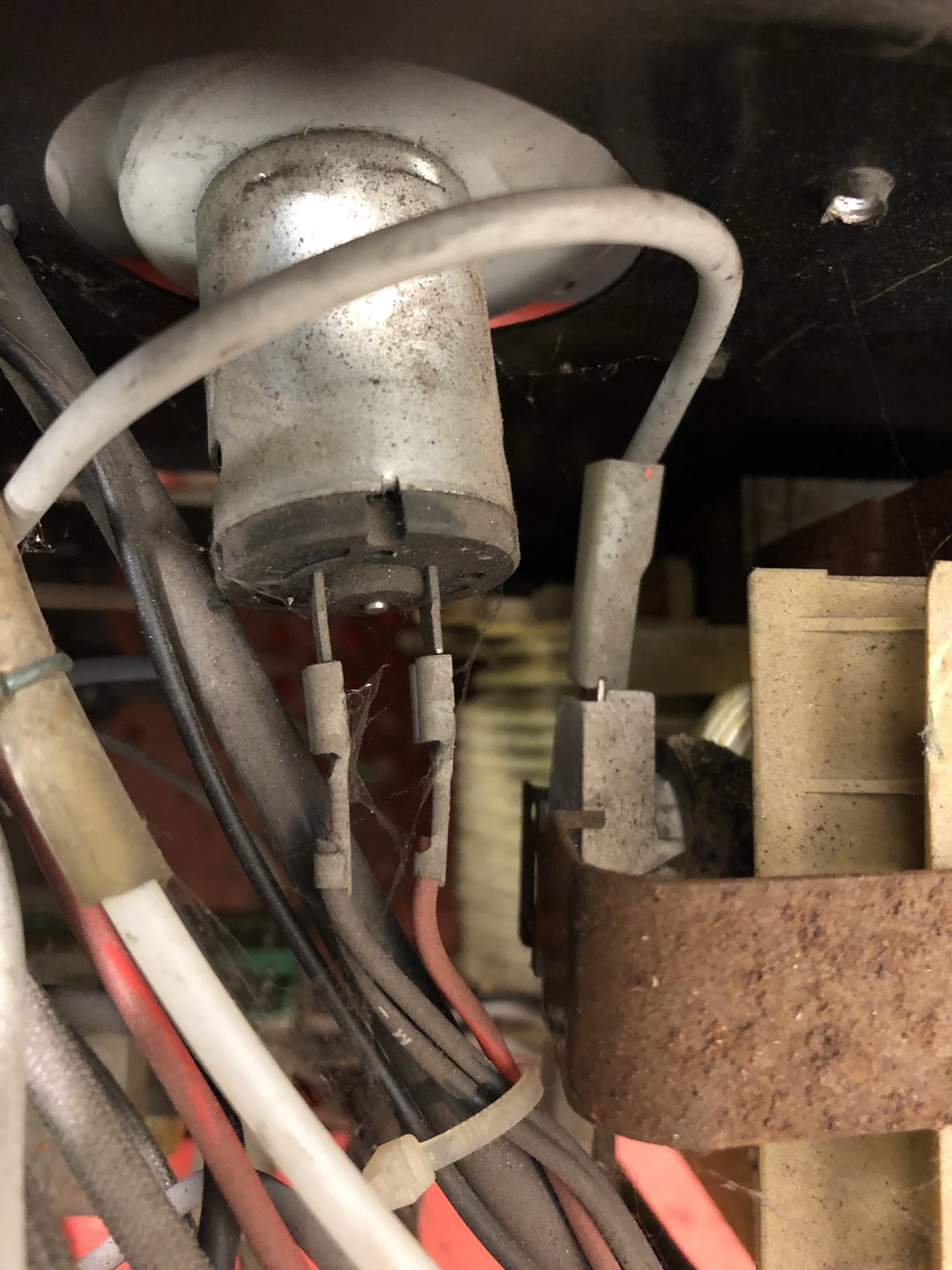

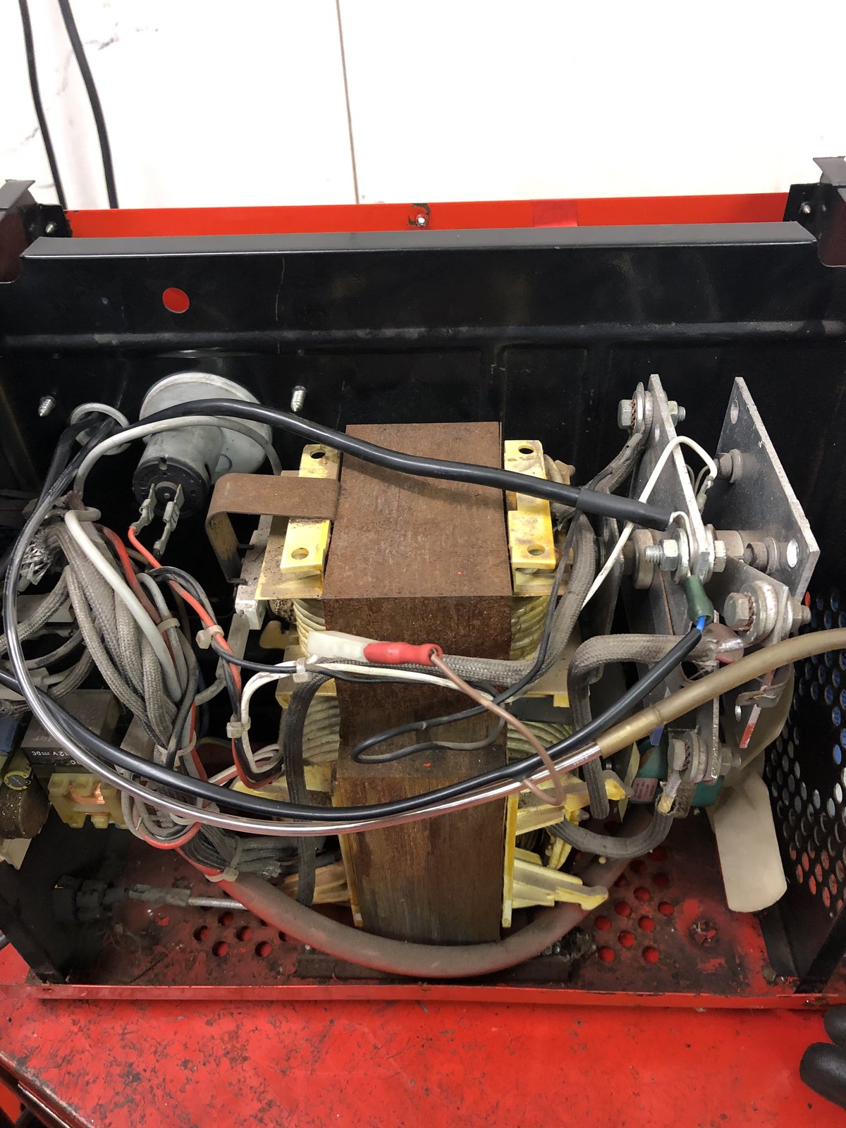

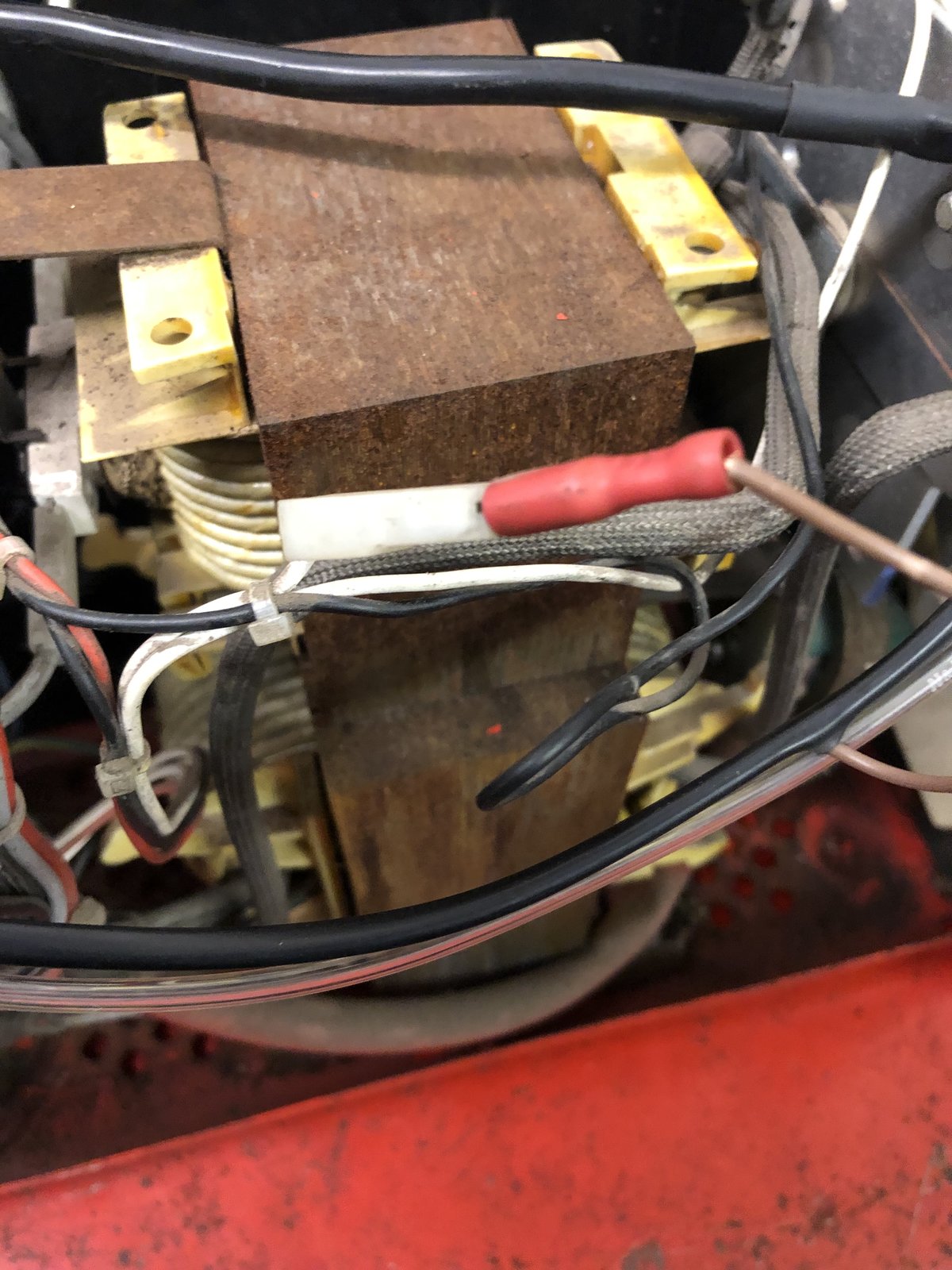

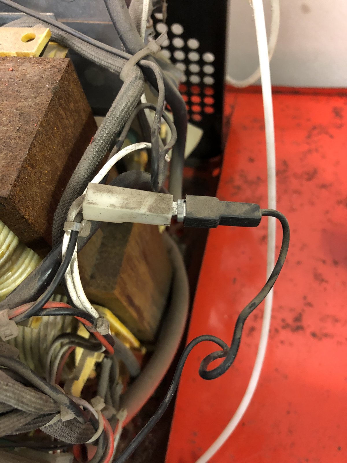

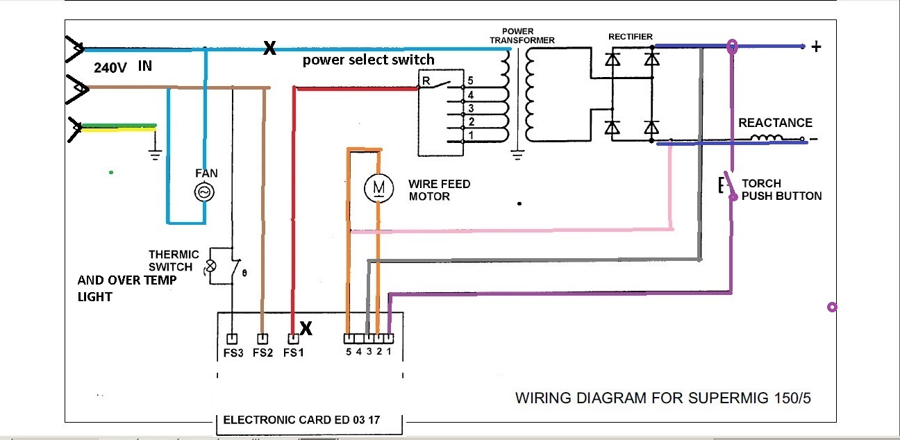

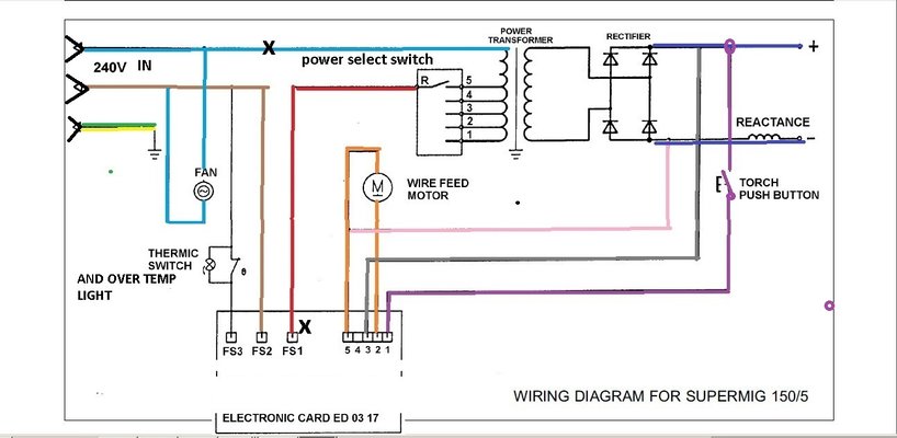

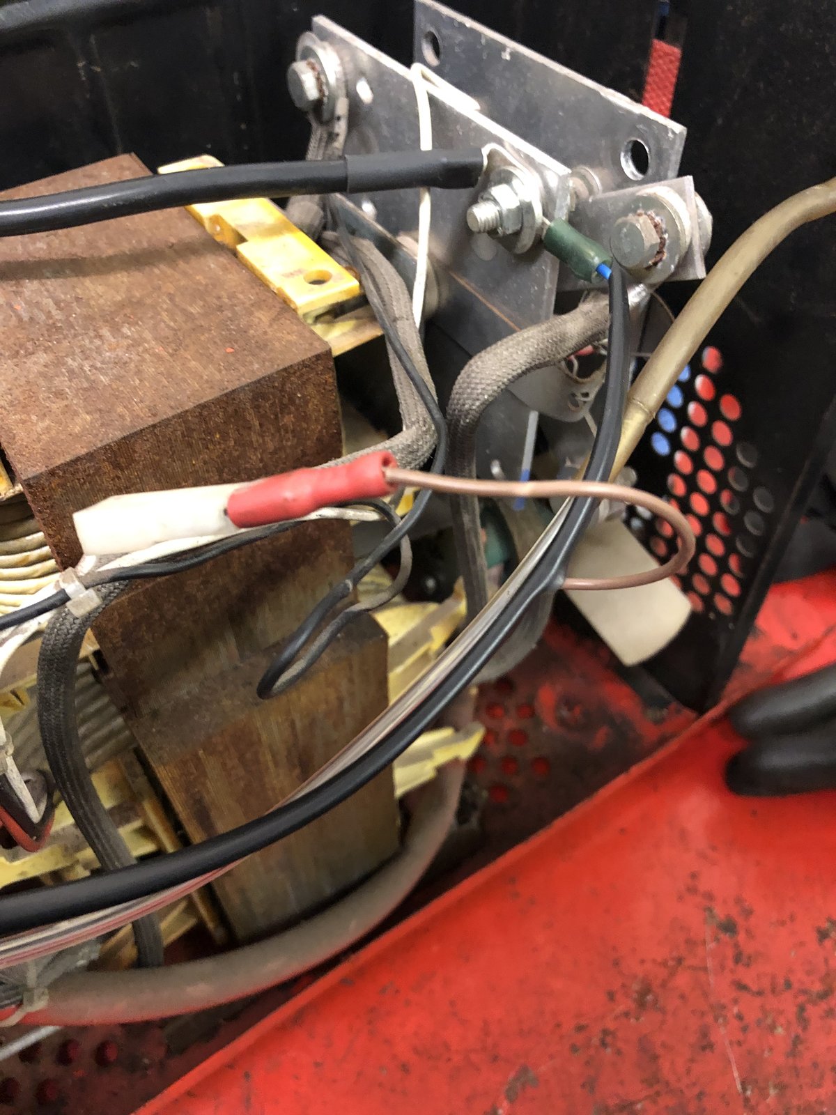

Hi everyone,I have a sealy 100 mig welder which the hose as gone I bought a new one but when I took off the old one it had one wire and the new one has two wires has anyone had the same trouble and fixed it I’m stuck please help me ,I have put some photos on to help

) shows at the top your original set up and the bottom shows the extra wire (blue in pic) going down to rectifier.
