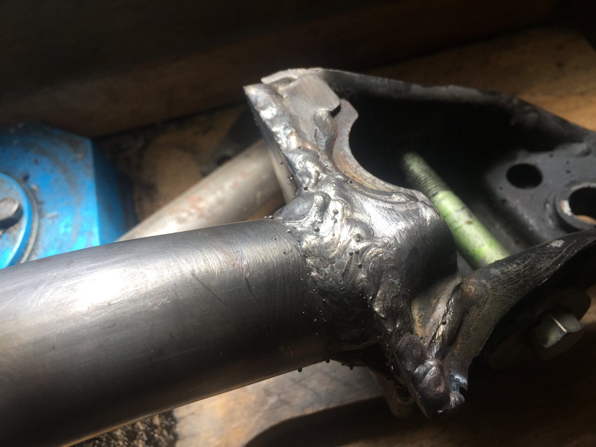

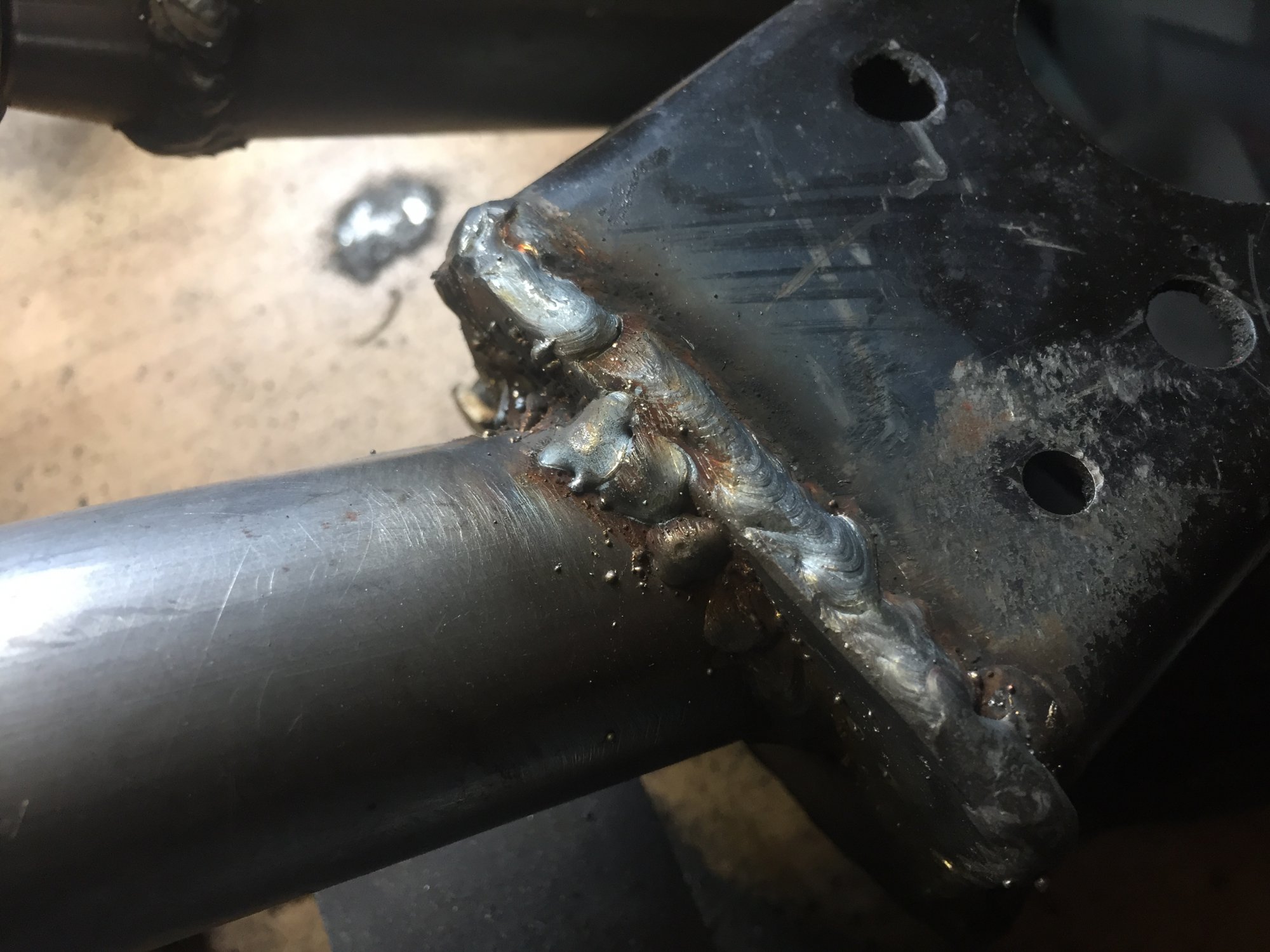

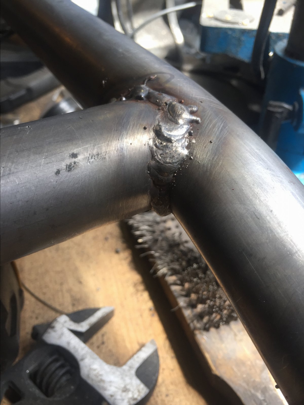

The wire feed is inconsistent, leading to uneven splattery welds and eventually a jam. If I strip the entire wire length from the torch and replace the tip il get a few seconds of consistent 5/10 seconds of welding beffore the problem starts again and it just gets progressively worse.
I've ordered a replacement steel liner and a replacement euro connector for the machine, but after that... what else? The motor? The feed pcb? How much effort beffore I just bin it and buy a new one
