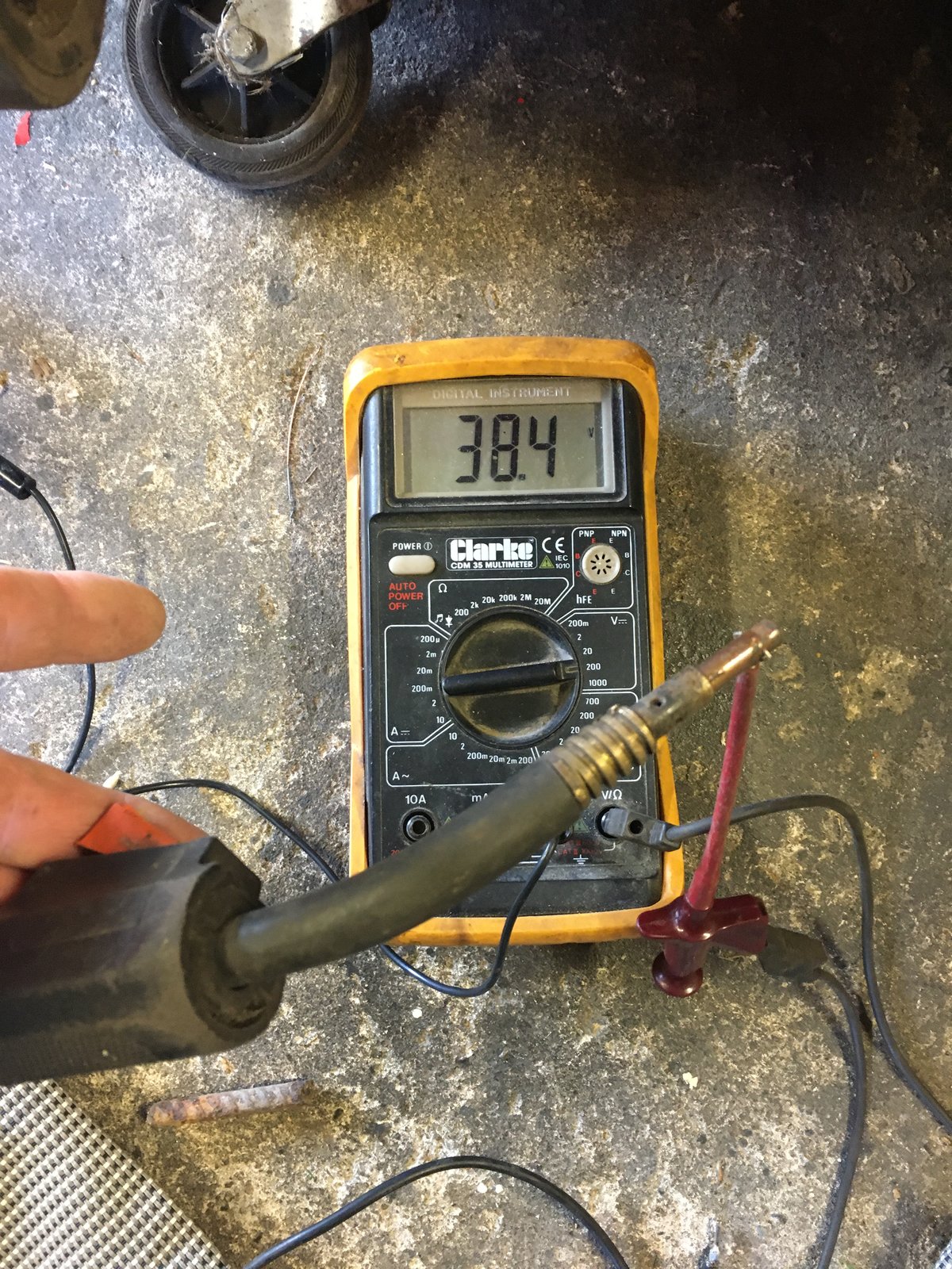

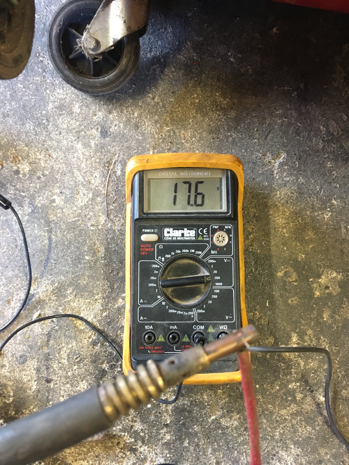

I've acquired this Supermig 170/1 with a fault. All seems to work ok, switch on, fan works, pull trigger wire feeds. But when you try and weld,it seems as there's not enough power, it just burns back the wire each time. I checked the diodes out, and I thought they seemed ok, could it be a transformer problem, if so, can I fault find it.?
