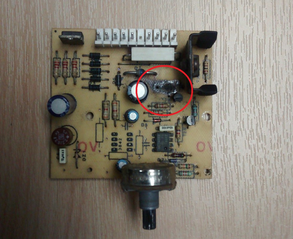

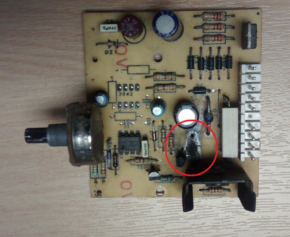

Hi all,
This is my first post, but I've browsed for a while
I recently bought a Sealey Supermig 130 with a broken control board and I was wondering if anyone who had one would care to take a pic of their board as I need to replace one component but it had charred and I couldn't tell what it was, and the board is charred where the part should be. I can repair the PCB easy enough and fix it as long as I know what part is missing.
See photos:
Cheers,
Jake
