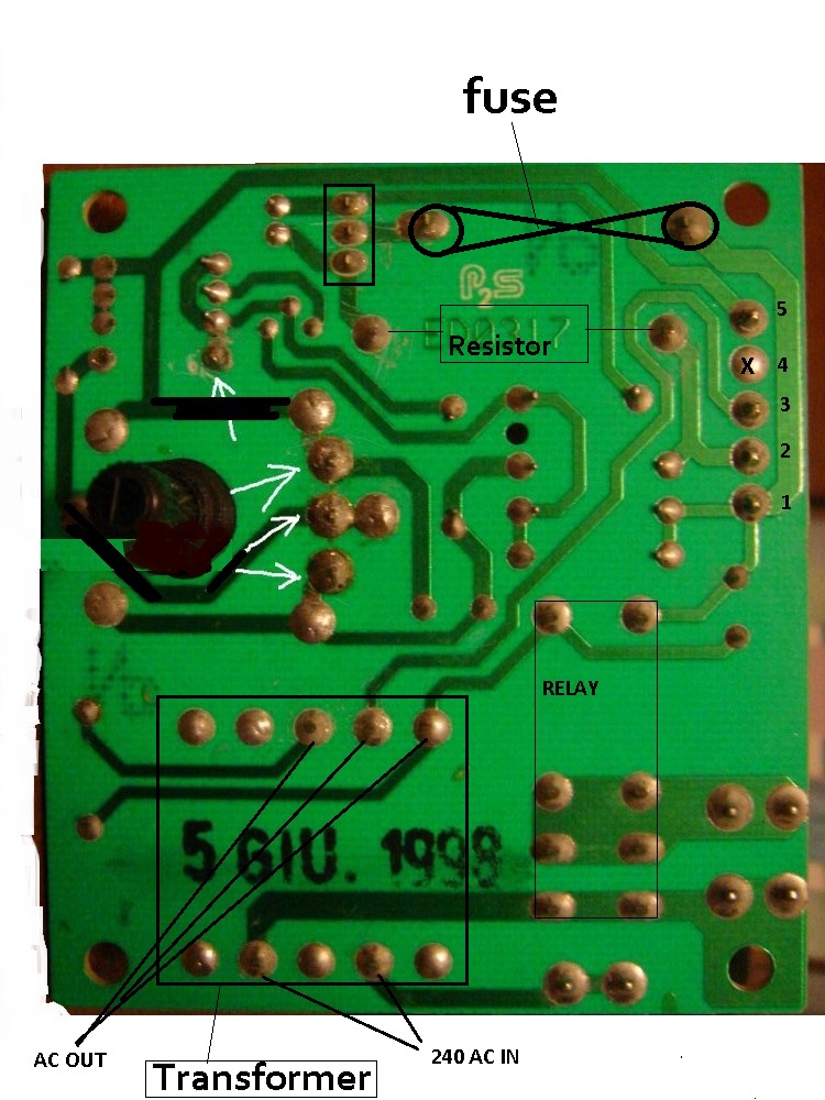

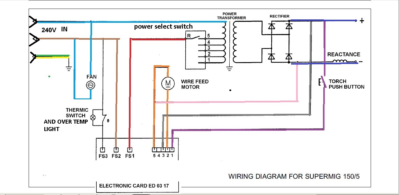

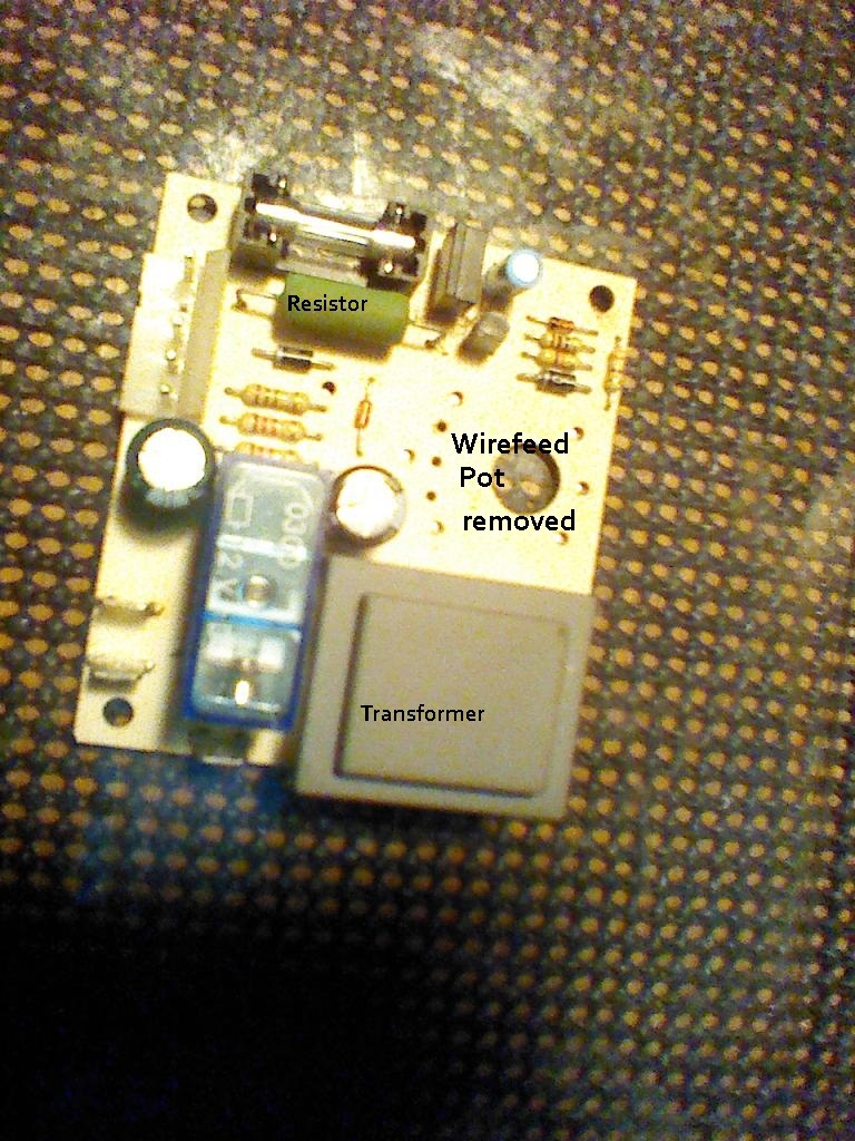

Just borrowed an old (but almost unused) Sealey 150/5 to make some gates. Was working fine for 1 day, then wire would not feed and it blew the 1.5a fuse. Eventually replaced with new fuse - still not feeding! Took out PCB - clean/no burn marks but Relay clicks when triggered (but no burn marks on relay casing).
Wire spool is ideal tension & wire not sticking BUT motor will not feed wire out.
Losing will to live! Can anyone help a mig virgin please
