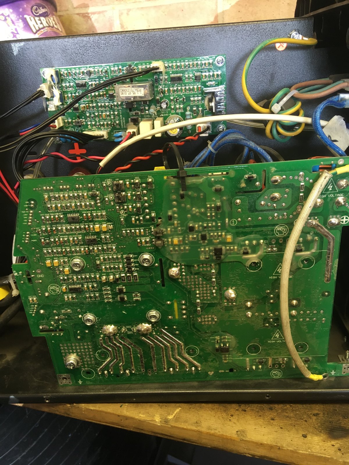

Hi everyone -first post here and I’m a bit of a novice!!
I have a Sealey IMIG 160, and it’s stopped working.
I’ve read some really helpfully threads on here but not sure what the fault. Symptoms are:
turn on, powers up, fan kicks in. All seems fine.

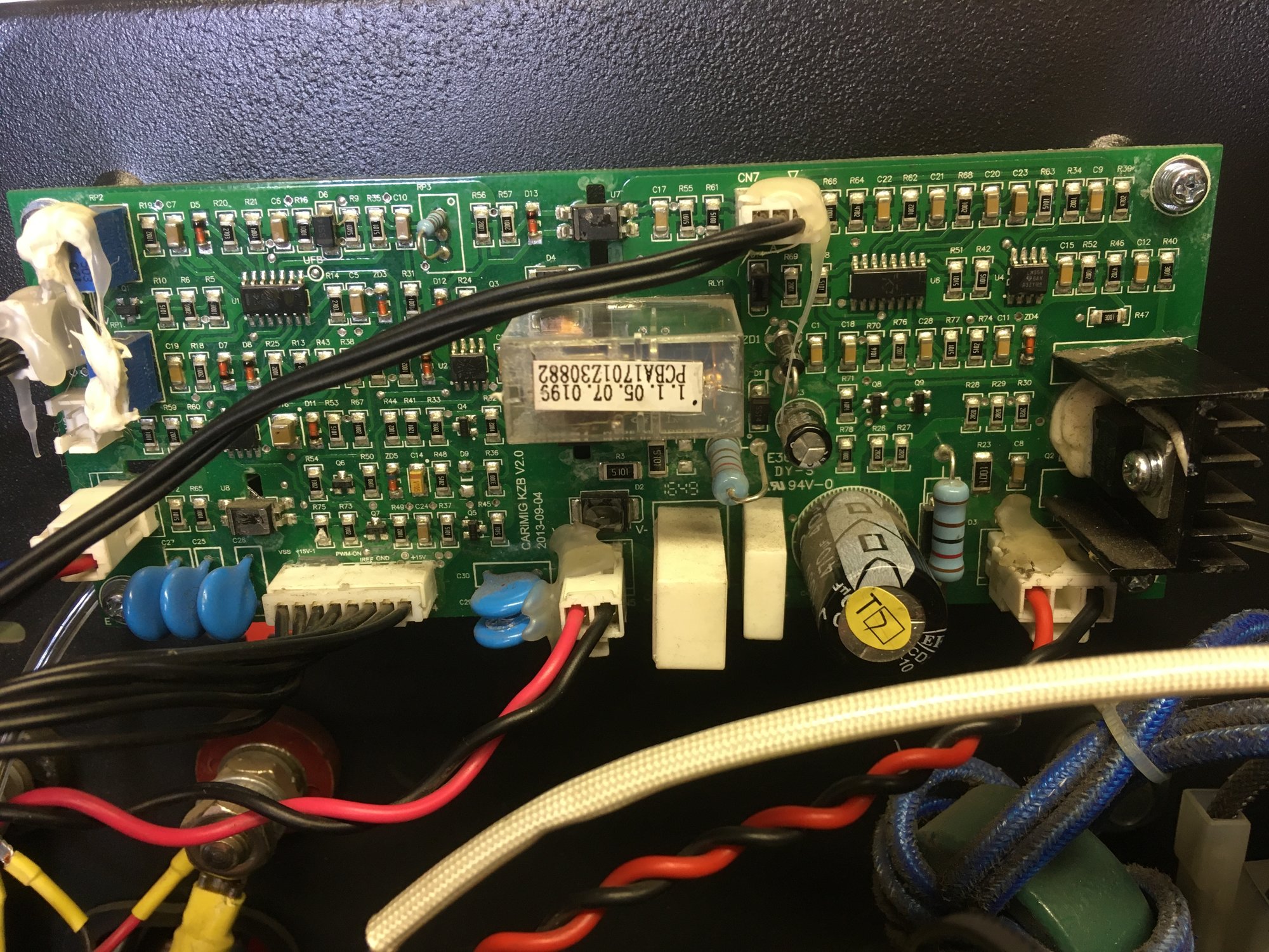

- press the trigger, can hear the relay click, but no current and no wire feed.
- I’ve opened it up and the relay looks fine, but a bit lost beyond that.
- the wire feeder works off a separate 12v source.
-there is no current at the Main +’ve connector Inside the machine, although power is making it to the big circuit board.
any ideas/ pointers?
Thanks!
