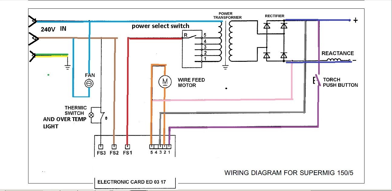

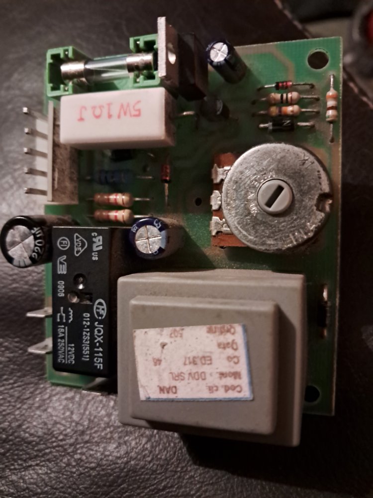

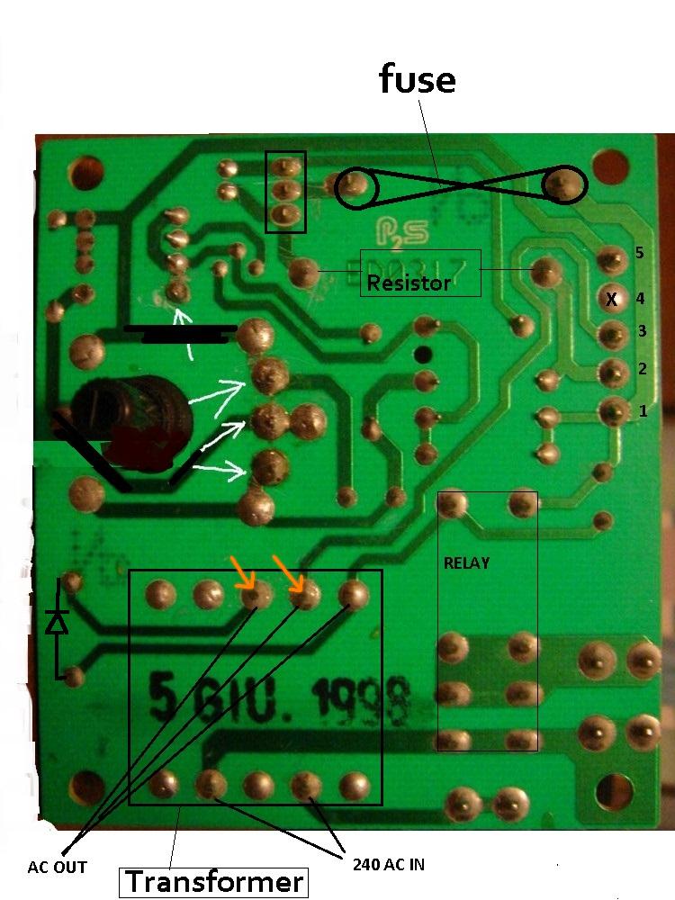

Hi all I've just registered on this forum and hopefully someone can help with my welder. It's a sealey mig welder 150/5 had it for 10yrs or so never had any problems. Last week I set it up to do a little job but unfortunately it didn't work.
So when pluged in and turned on the fan runs fine ,however when the trigger is pulled there is nothing, no wire feed no clicks just silent.i have taken the case off the gun and the wire is all connected to the trigger so I'm thinking mabe pcb but would like some input from someone with a bit more experience in this field than I have please
