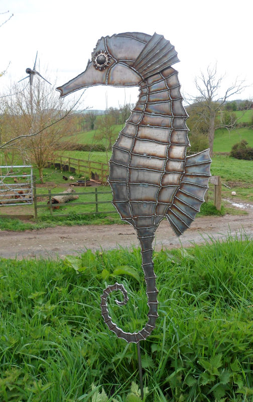

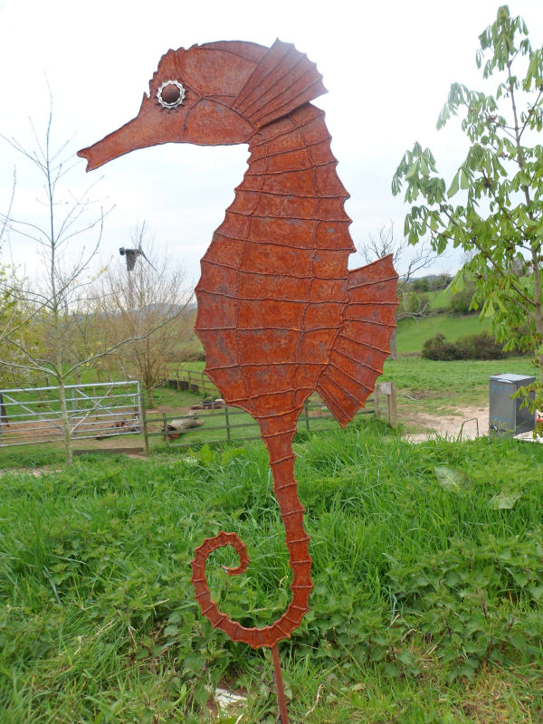

I finished this on Friday and have put it outside with ammonium chloride to get it rusted before I varnish it for her. I finished up being quite pleased with it and can see myself making more stuff in this simpler style.
if she does not like it she goes in the slurry pond and I will sell it for more than she is paying.
The body is made of 1.6m mild steel, the seahorse itself is about 1m tall.. I draw the lines on with chalk then weld over them, ignoring most of them and letting it happen freely. Then go around the edge with the plasma cutter. This gives much more definition and texture. Also a quick way to work. Probably three hours to make the body and cut it out.
The single leg goes onto a an 'H' shaped platform of box section and extends up the body to give some stiffness.
