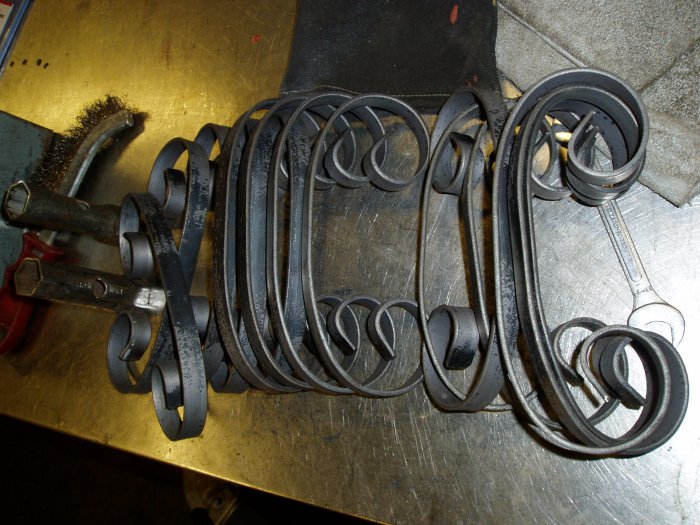

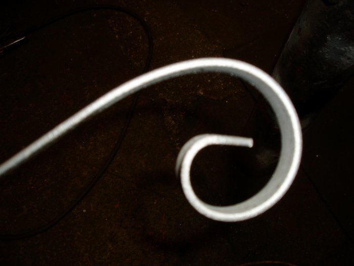

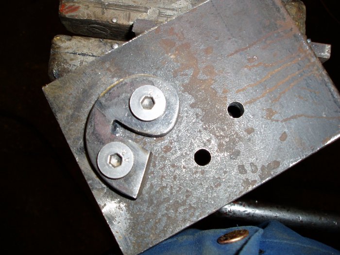

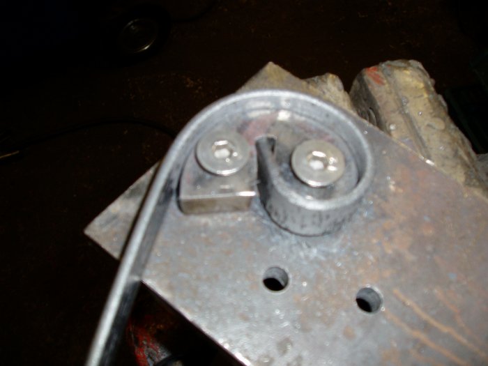

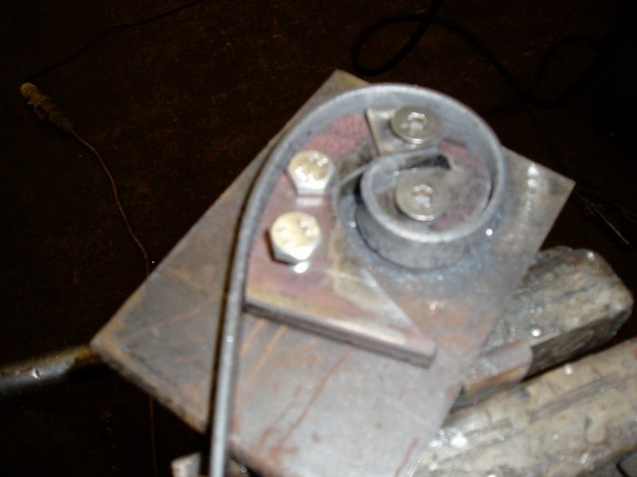

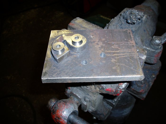

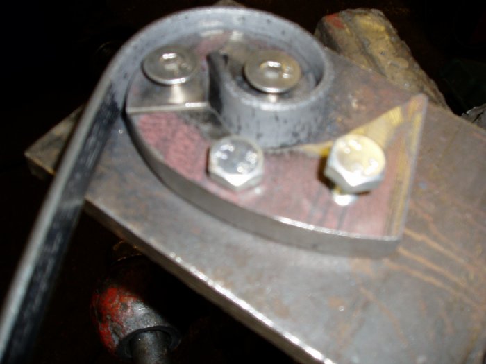

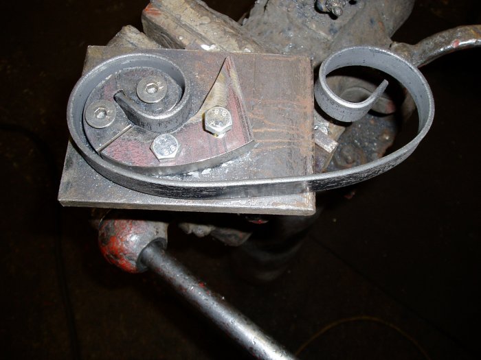

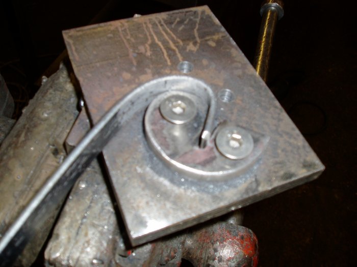

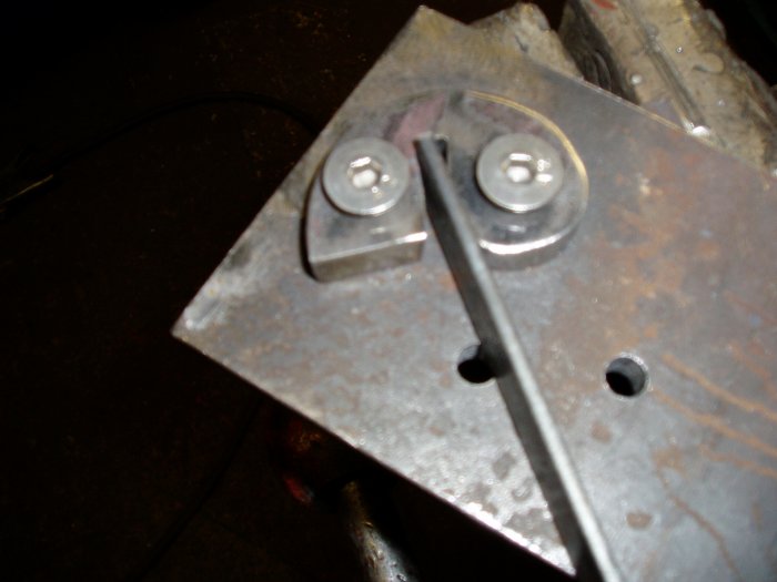

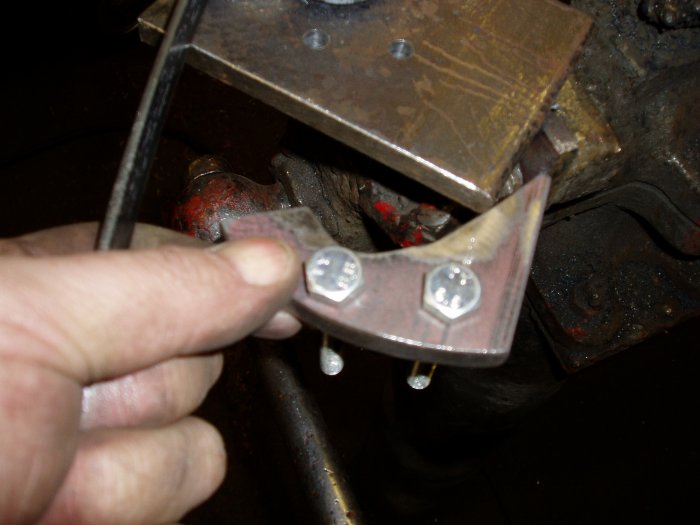

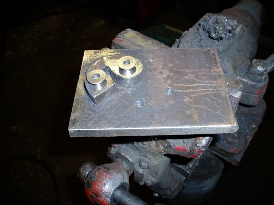

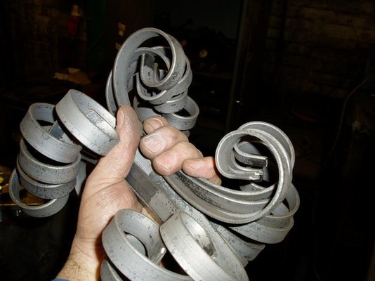

Made this little scroll jig today , very simple !
Drew around an exsisting scroll then cut out the shape , transfered to metal and cut out shape with oxy / acety , then smoothed out with the grinder , cut the shape in half and drill and bolt to plate , hope it might help someone !
