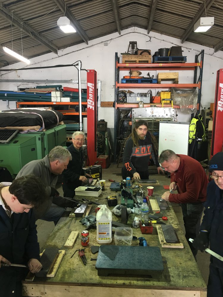

I am guessing it's just down to surface area. Maybe rougher underneath?Im interested in how the hell you get epoxy to stick to what is effectively one of the slipperiest materials known to man? Im well versed in how epoxies work & used lots but in my trade ptfe was used in high grade release agents. Is there some kind of pretreatment to the turcite?
I recently used some cheap chinese clone Turcite with a special epoxy glue. The sheet (green) has a brown-ish back side, made for the glue to catch.Im interested in how the hell you get epoxy to stick to what is effectively one of the slipperiest materials known to man? Im well versed in how epoxies work & used lots but in my trade ptfe was used in high grade release agents. Is there some kind of pretreatment to the turcite?
Corona treatment, plasma + grafting of polar groups. Or etching of PTFE with metallic sodium and ammonia solution. There are other ways etcIm interested in how the hell you get epoxy to stick to what is effectively one of the slipperiest materials known to man? Im well versed in how epoxies work & used lots but in my trade ptfe was used in high grade release agents. Is there some kind of pretreatment to the turcite?
