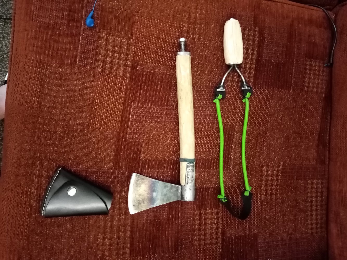

The little axe or scrapchet as it's known made from 6mm mild steel with an inch of carbon steel welded for the cutting edge and the body welded to a pipe for the eye. The end of the shaft is drilled for a fire steel complete with home made leather mask. The handle incidentally is from off cuts of Ash that is supplied to Morgan cars my mate in Lincolnshire got that for me.
