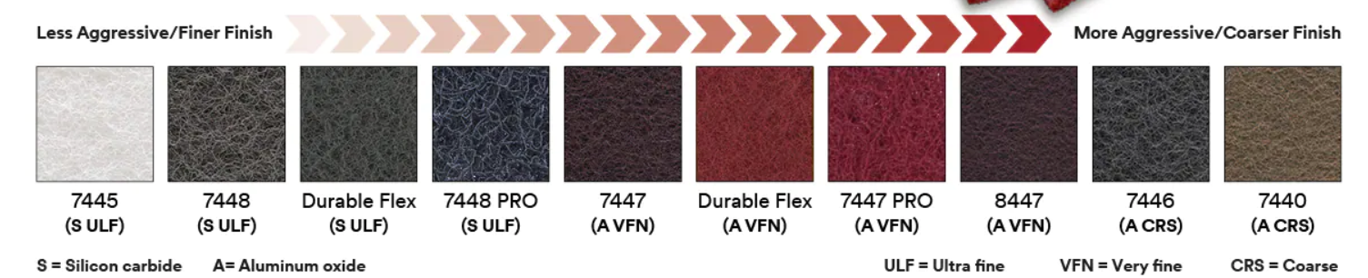

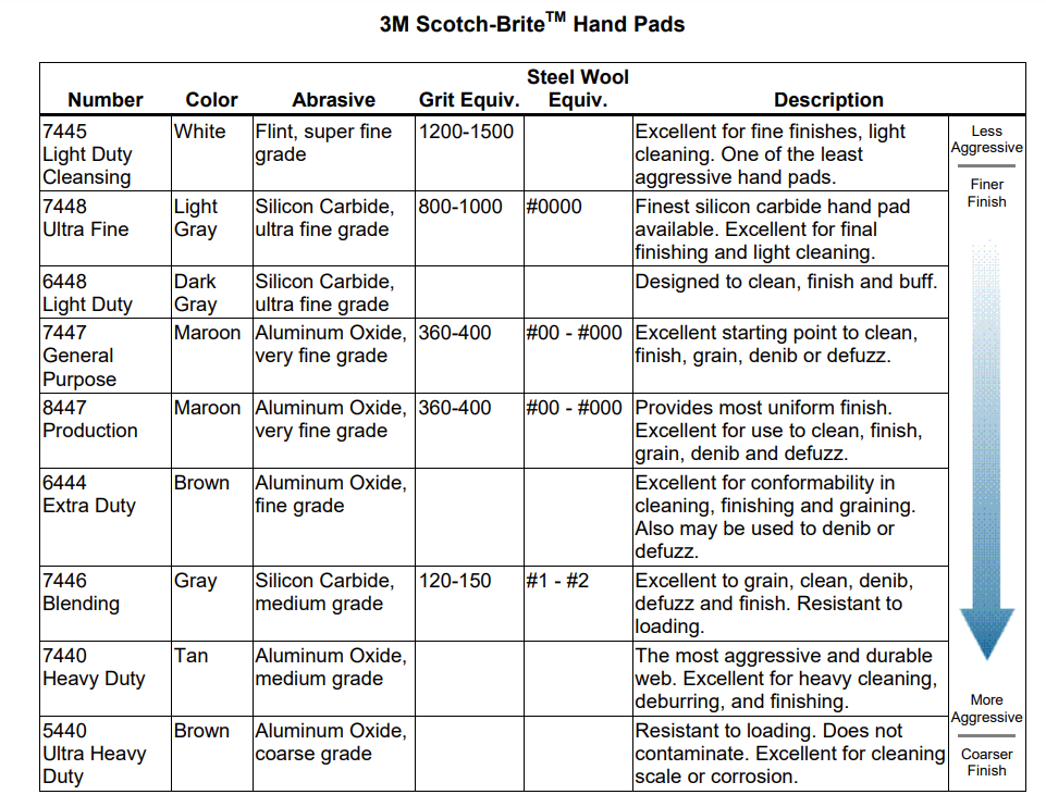

I use Green Scotchbrite on cylinder heads (properly cleaned afterwards mind).

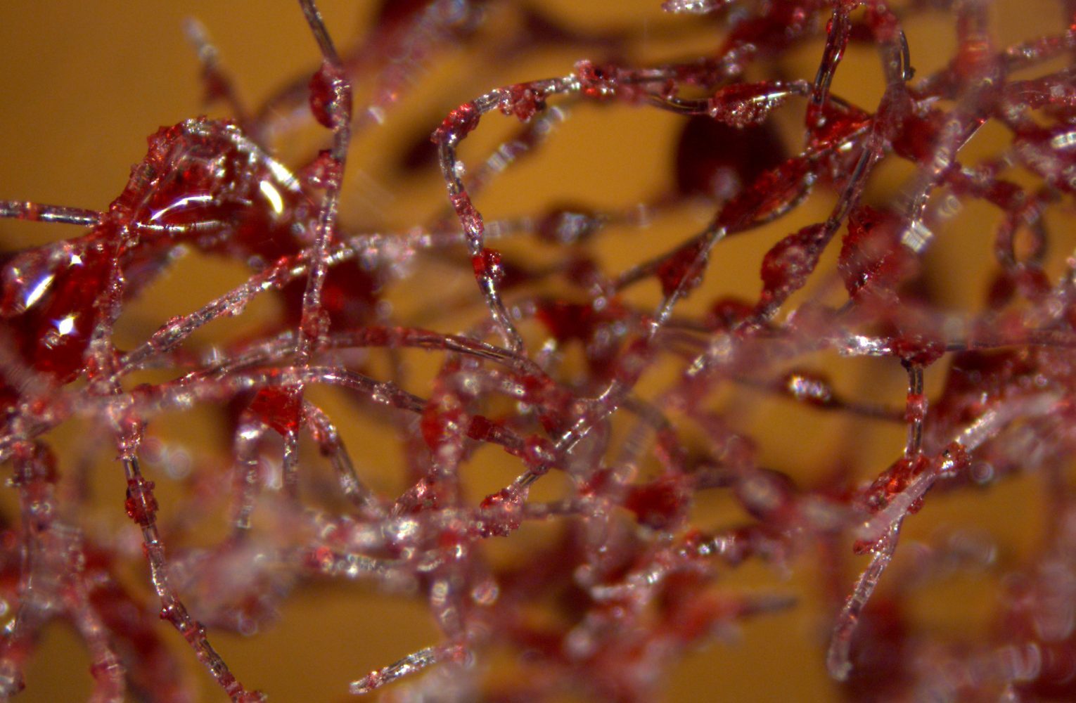

You have to watch out for the dust it sheds as well really.
Honda recommended wet and dry for cleaning car cylinder heads at one point iirc. Have used sheets myself on glass with good results.
