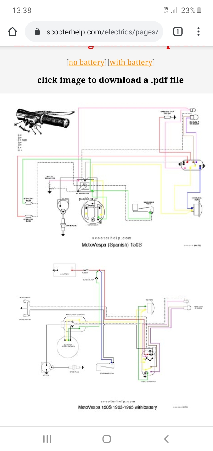

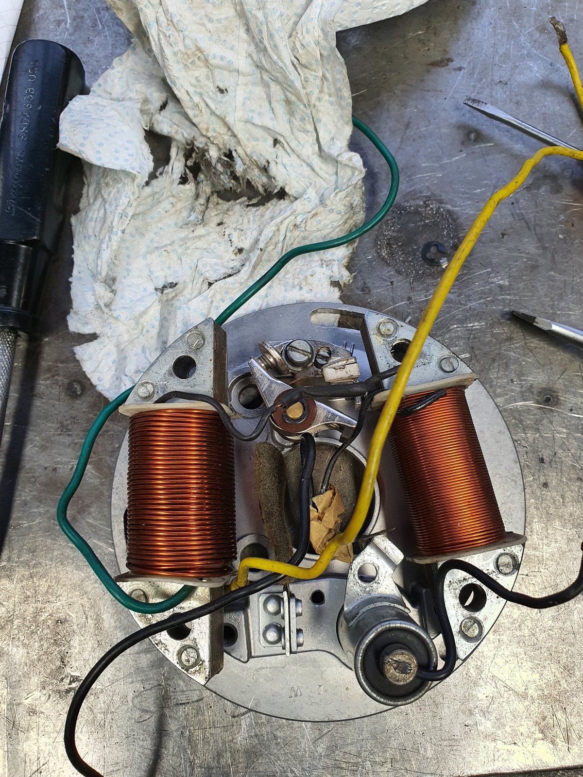

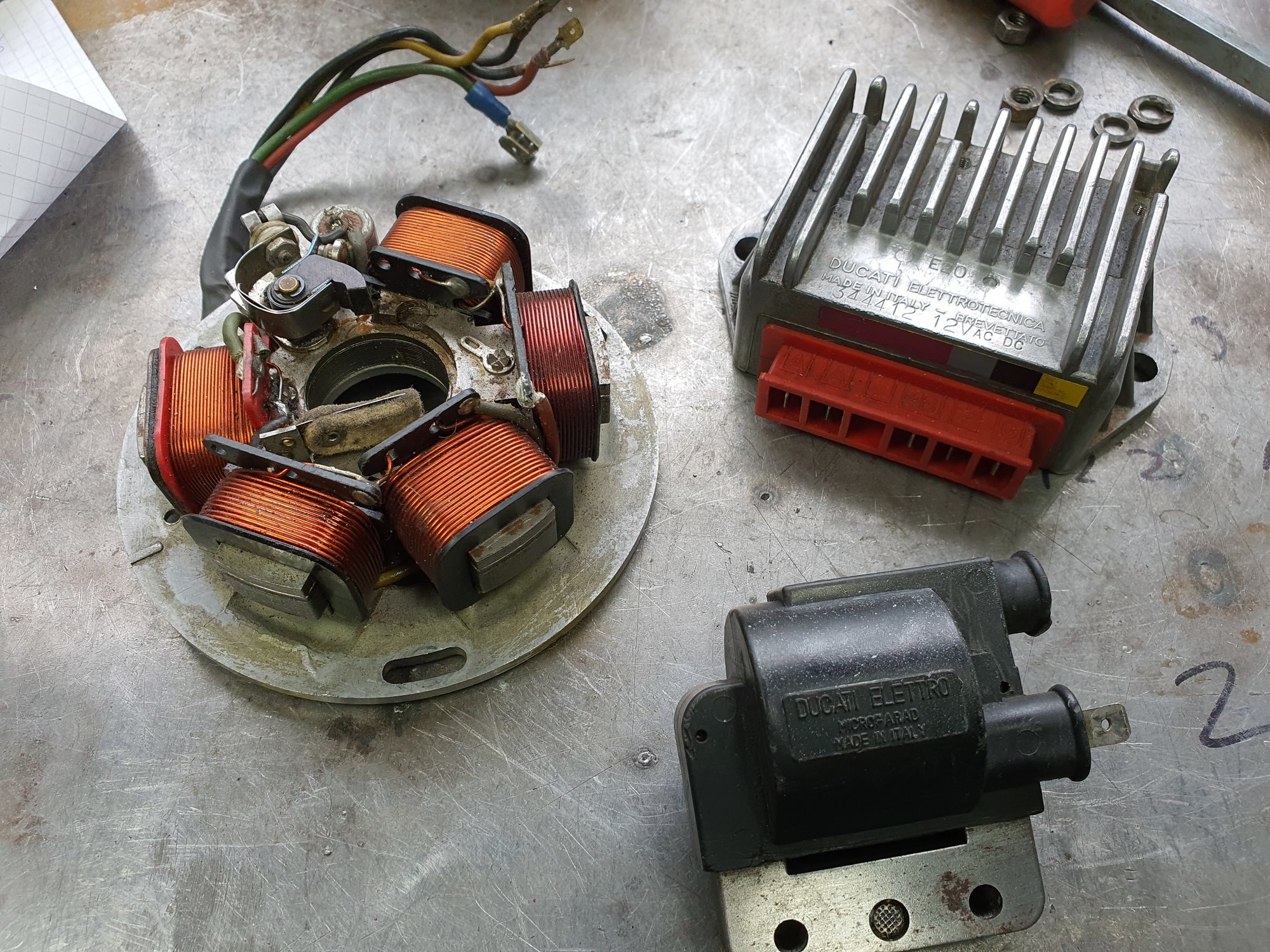

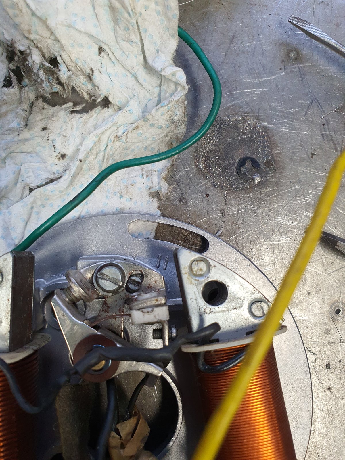

6v to 12 v converter?
Worth looking into, I used laptop power converters to run 24 volt engine electrics on 12 volt for some camper vans.Just need to work out how many amps you're running.
2 seconds on google to find a converterNot sure if its possible.
It would work, but transformers are manufactured for specific frequencies of input.Surely if it's an AC coil then a small step up transformer will supply 12v
That's it, max power out from the stator plate ( amps x volts = watts ) stays the same, but the converter changes - increases - the volts.My stator plate can't make more power with out extra windings now can it ???
Or will the max power stay the same but the converter just changes the volts ?
