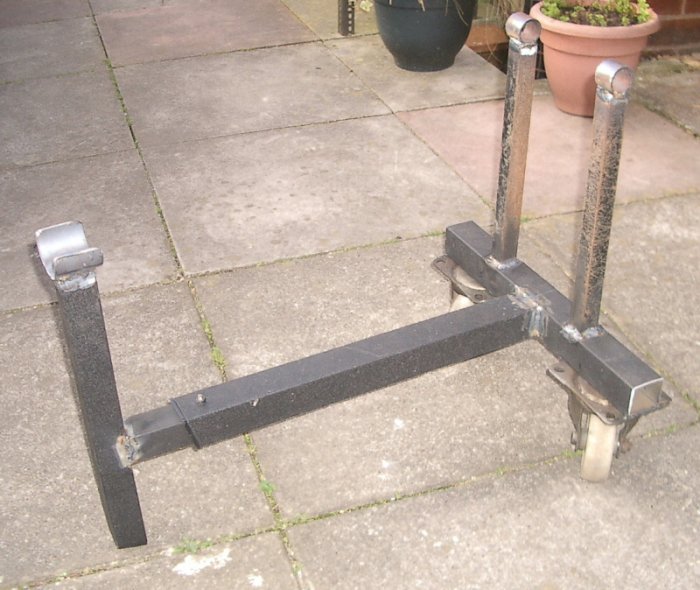

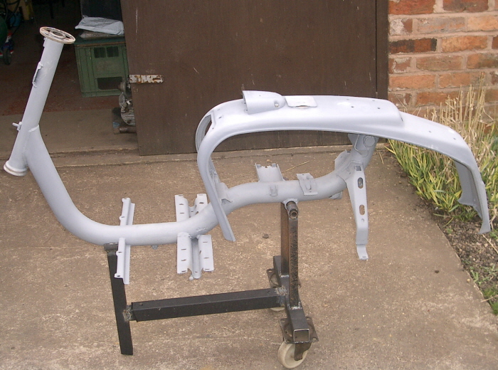

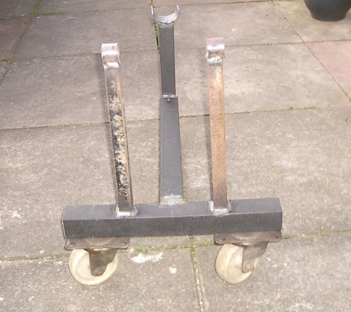

I am gradually rebuilding a Lambretta and the frame is ready for painting so I will need somewhere to stand it when it's done and the engine goes on the bench. I had some old speaker stands in my usable offcuts so I recycled them and came up with this frame modified from some pictures on the net. The engine mount goes through the two holes at the back and the frame rests in the front.
