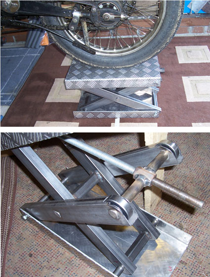

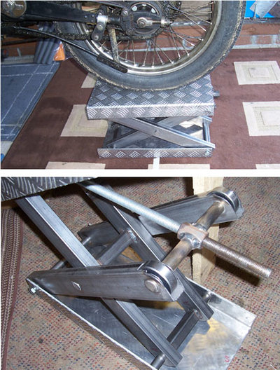

Hi All.
I often work on cars, my own, and customers. Nothing big or heavy.
In order to save my poor old back and my dicky knees I'm making a set of four adjustable ramps/lifts, and this week was testing time.
I had my own (scratch built) Seven on them over the weekend so that's them tested to 650kg
so now I have the confidence to
try a customers pride & joy on them. It's a 1923 three wheeler worth (he says) £30k so I'm just a little nervous to say the least,
but all was well when I looked in the workshop at 6am this morning. (Phew. Mops brow)
When I've worked out the inevitable mods I'll treat them to a coat of paint; well maybe.
The top pic shows them at 270mm high, but they should go to 450 (ish)
Whatdoyathink?
Cheers,
Paul G

, put a couple of pegs on each chock and drill holes in the plate to locate them and stop them slipping
