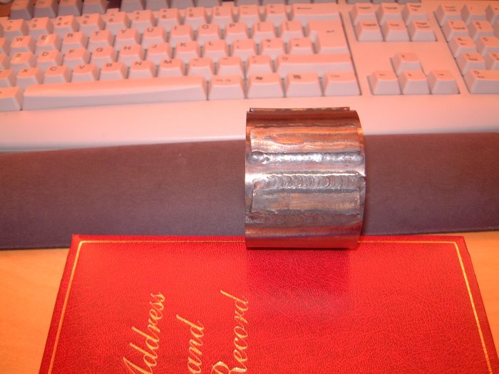

I remember paying good money for stuff not up to that standard!
Looks like you've lost the gas at the extreme bottom right hand (maybe pulled away too soon).
One tricky thing which might explain a little scale is keeping the hot rod inside the sheilding gas while out of the arc when dabbing. Maybe a bigger ceramic might help?
