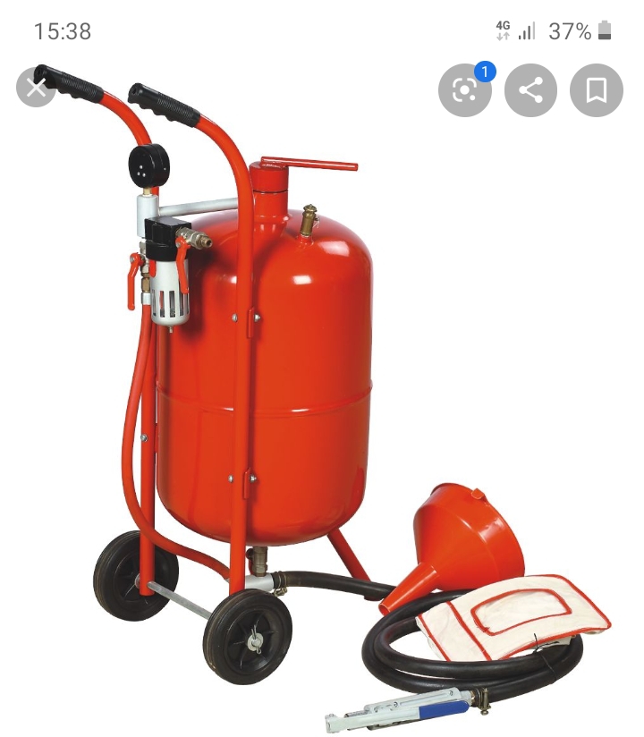

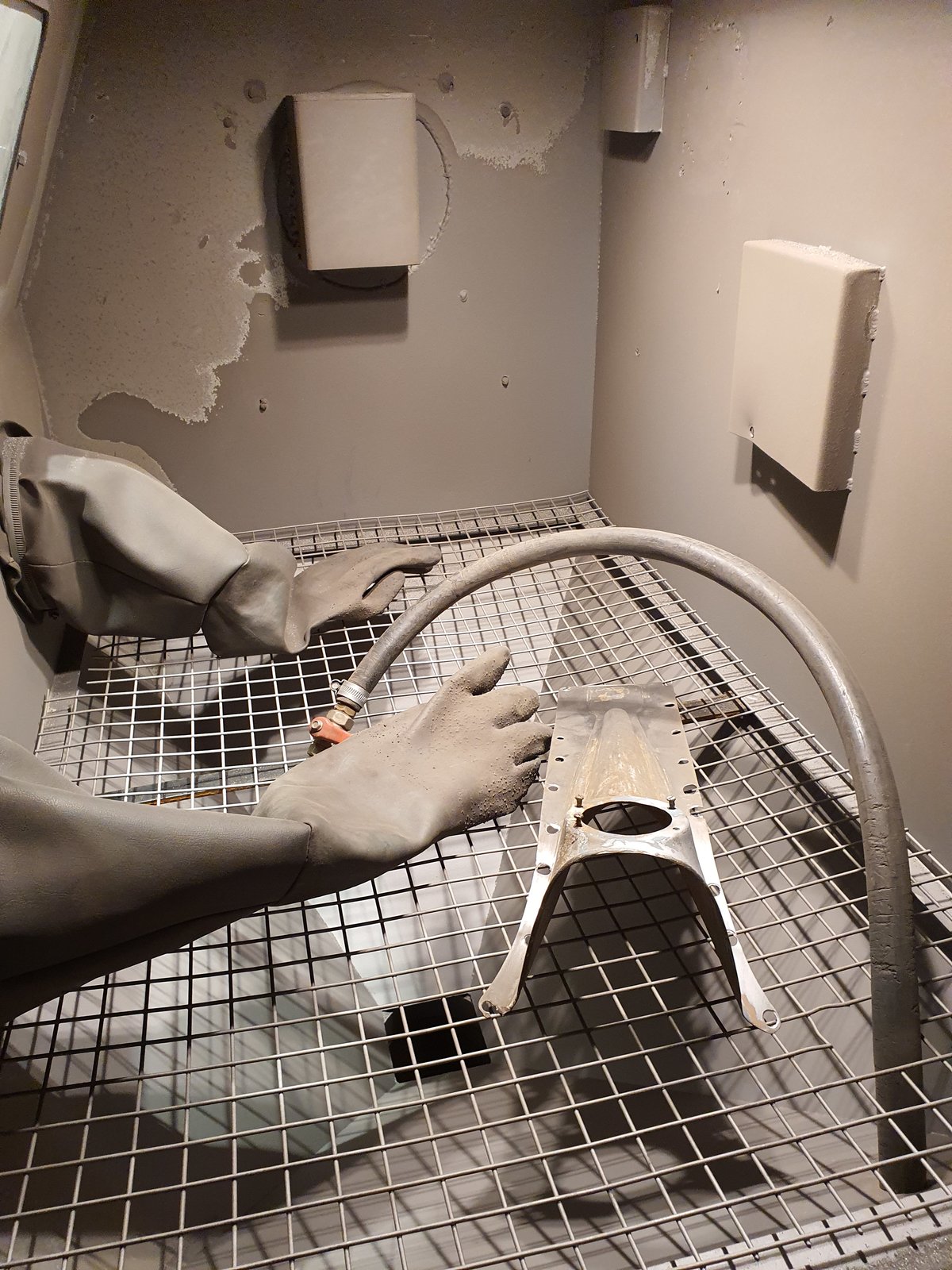

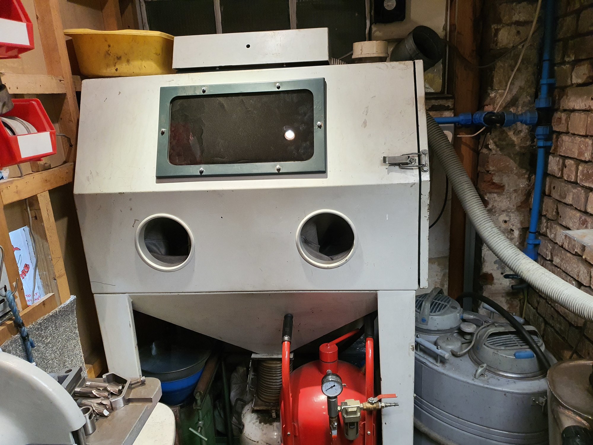

steel shot or chilled irons ok but it gets damp sticks to the inside of the pot and goes rusty then builds up . if its in a cabinet and you can recover it use aluminium oxideI've often thought about using steel shot in my pressure pot and cabinet to reduce the amount of dust.
Does it work well?
I was worried about the weight of the shot compared to jblast
