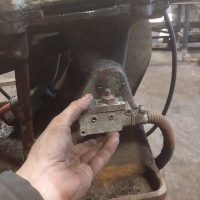

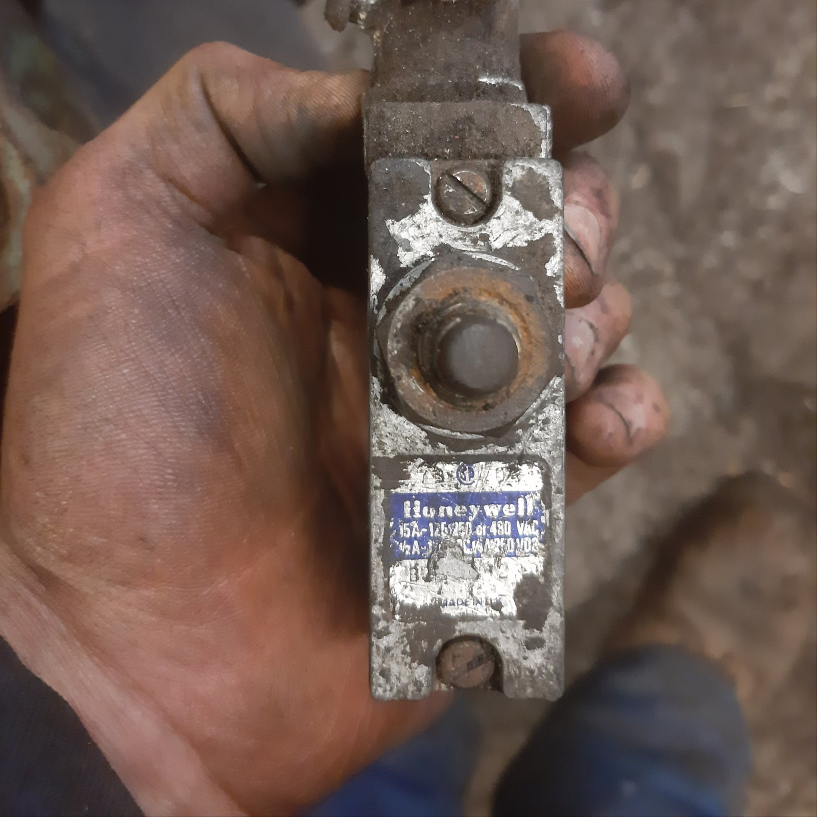

Annoyingly I can't make out a part number, just some bits of half scuffed up info saying something like "15A 125 250 or 480 VAC, and then A250 VDG" underneath...?You are looking for Limit Switch
A possible is
https://sensing.honeywell.com/switches/specialty-limit-switches/BZG-BZH-series
can you read the info on the switch,.
