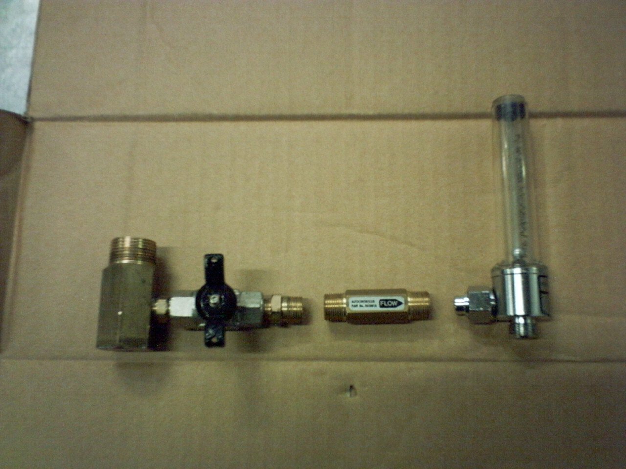

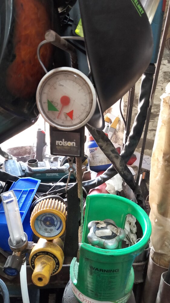

We had to fit tamperproof flow controls to the production welding booths at work because if there was anything they could turn up to "max" they would, thinking it would make their job quicker
Typical set up, the tamperproof bit in the middle.

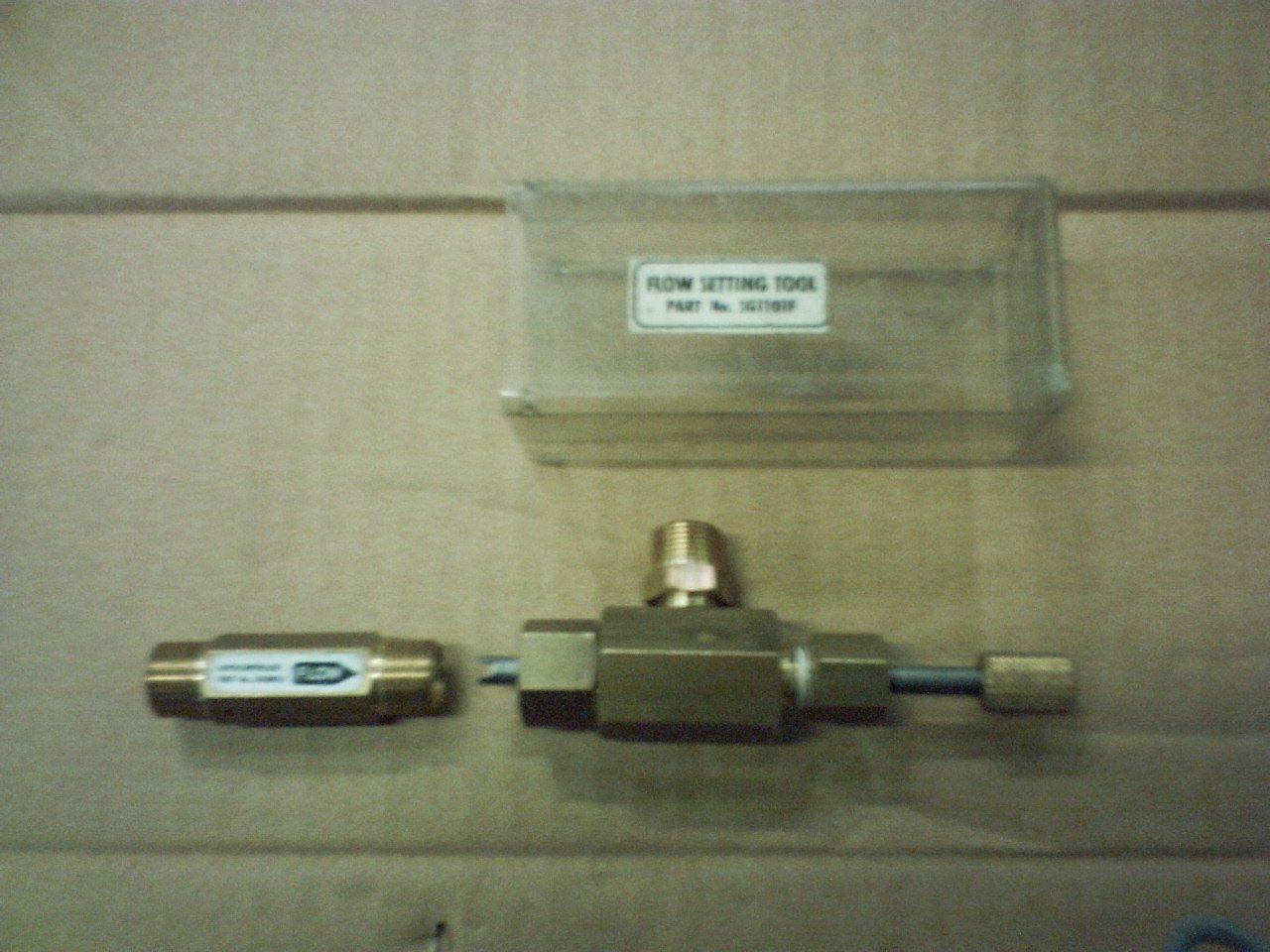

and with the setting tool we used
