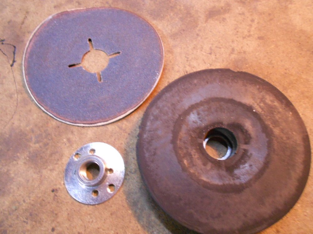

S Stoneward Member Messages 60 Jan 5, 2016 #1 Bought these on eB*y, but they are a poor fit on the grinder spindle, as the hole on the blue sanding disc is larger than the spindle diameter. Is this normal and about as good as it gets, or is this the wrong tool for the grinder?
brightspark Member Messages 41,684 Location yarm stockton on tees Jan 5, 2016 #2 if u have a load just fit the disk on loose - spin it by hand and then true it up till its right tighten and off u go its not going anywhere
pedrobedro Man at Matalan Messages 13,132 Location CX near Chesterfield Jan 5, 2016 #3 The screw in boss should locate those discs not the threaded spindle. The flexible backing pad looks like it's seen better days.
