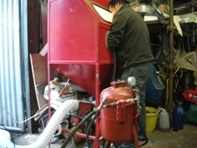

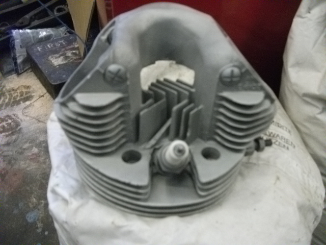

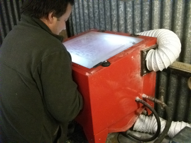

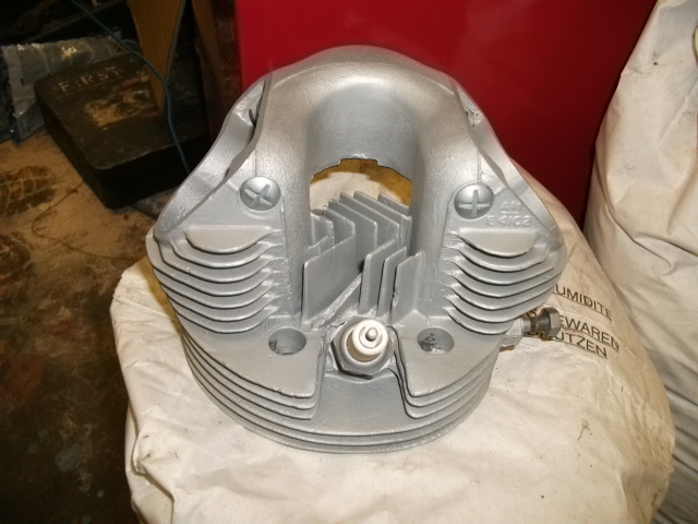

heres a couple of pictures of my mate using my gear to clean an ally head up .1st it was sandblasted using fine sand with all machined parts covered up .a nice clean finish . then was beadblasted in small cabinet to pein the surface giving a smooth satin finish
