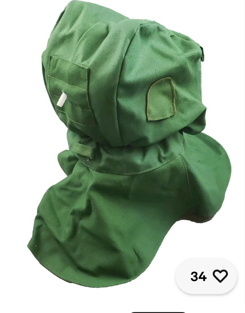

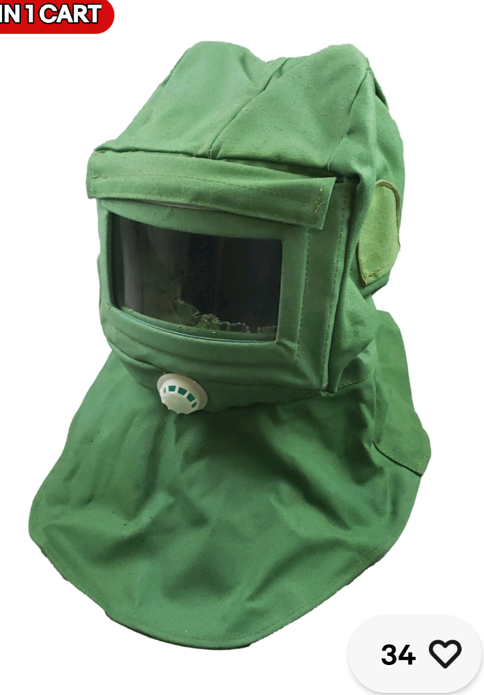

is the mask an air fed blasting helmetApologies I'm not the best at explaining so I've got a sandblasting mask a compressor and a blasting pot what fittings do I need to connect up the mask
possible 2 comps 14cfm and a cheap pot with a 3mm blast jetThanks for your advice I'll look into getting everythingyour breathing is all 1/4 bsp you need a bit more 1/4 or 6mm flexi pipe than the blast hose, a male PCL to hose barb.
On the pot a filter for breathing (this is not any old filter it takes any oil out) a small regulator + the bits to connect which are mostly male to male - sizes may vary. Mount it all on the pot, 1 PCL quick release with male 1/4bsp going into the breathing filter.
That should get you close to what you want.
