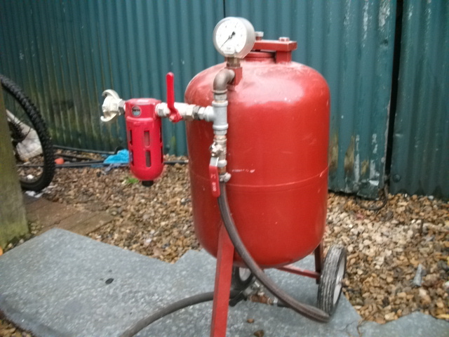

dont bother with the tap on the end of the blast hose just fit a carbide jet and regulate on off at the water seperator. the valve underneath just needs to be slightly open to regulate the sand flow. pressure needs to be about 90 psi for eficiency but will work on a lower presureSo you just connect the air hose into the connector on left side, have some sand in the tank, open the valve under the tank and open valve on blast jet, and fire away? will it get enough pressure ?
the pot is pressurised otherwise there is no way of introducing the sand in to the blast pipe unless both are at eaqual pressure . it isnt a syphon gunOk, but do you have air pressure inside the tank? or only from the hose to the valve underneath.
