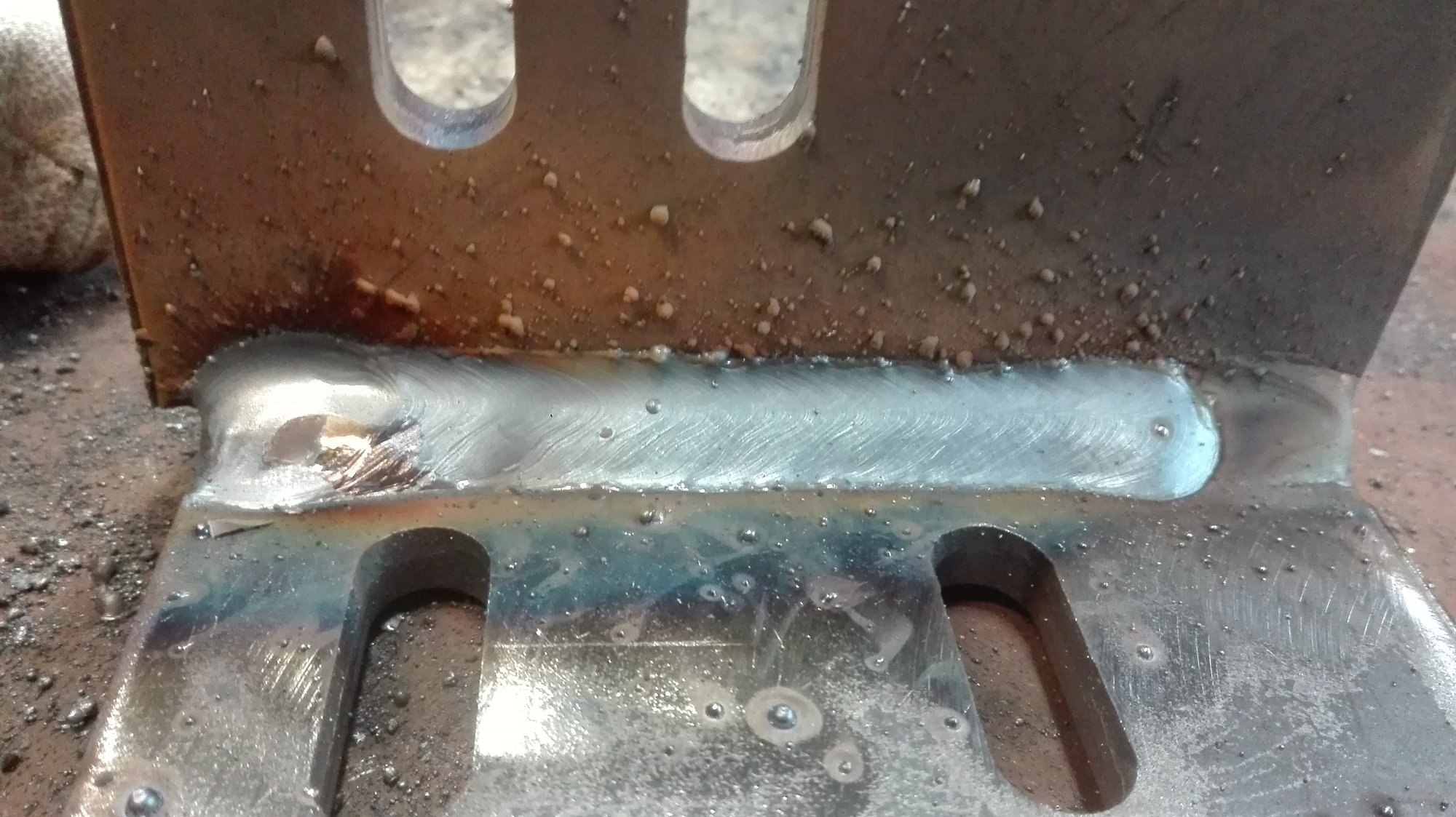

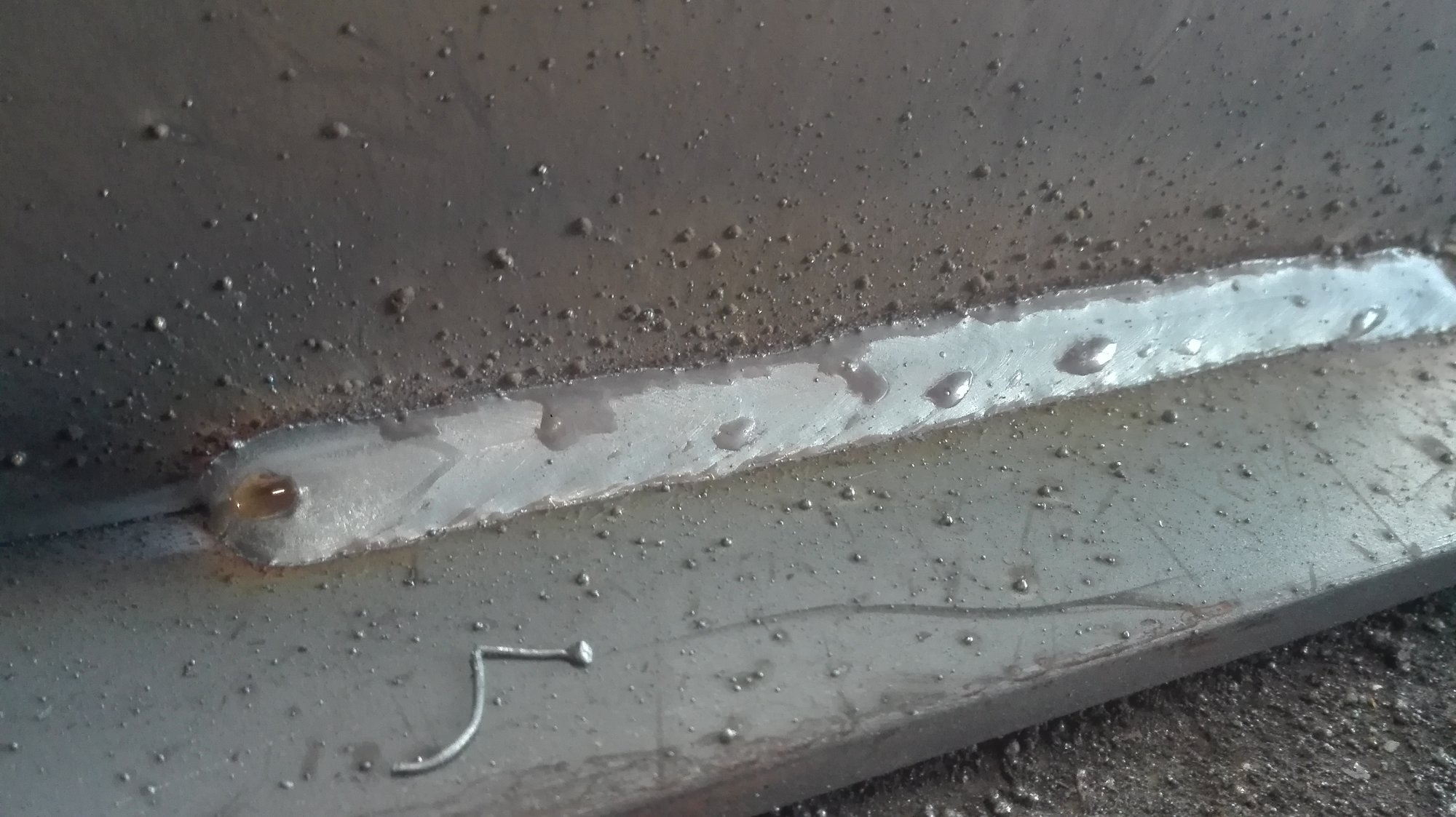

one was OMIX, it was just alright second was ArCO2 18 and i couldnt get it into spray at 29-32 voltage range.
so thats how it was seconds before i run out of gas.

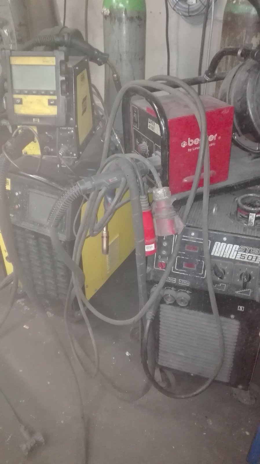

then i turned on the "posh
" welder with pulse and superpulse it was on pulse, and ArCO2.

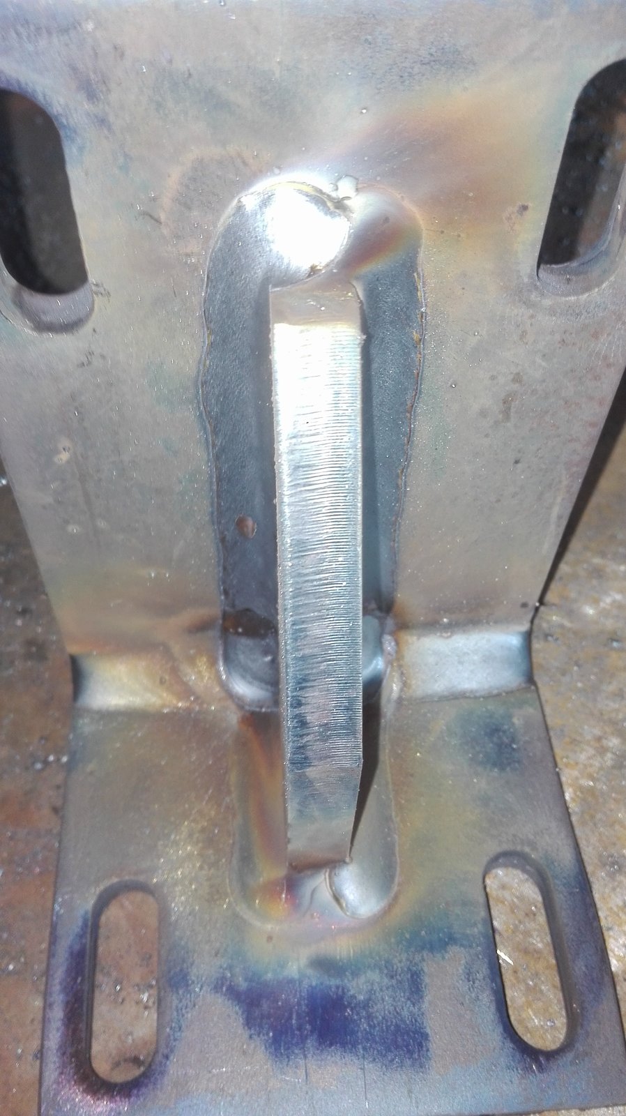

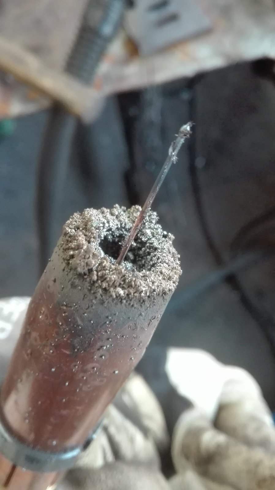

picked up the torch and saw this.
SERIOUSLY? i got rid of that stuff, changed the contact tip and it welded like S* on pulse.
for both machines, set for spray and pulse it was on globular transfer side. why?
2 different bottles, same results.
