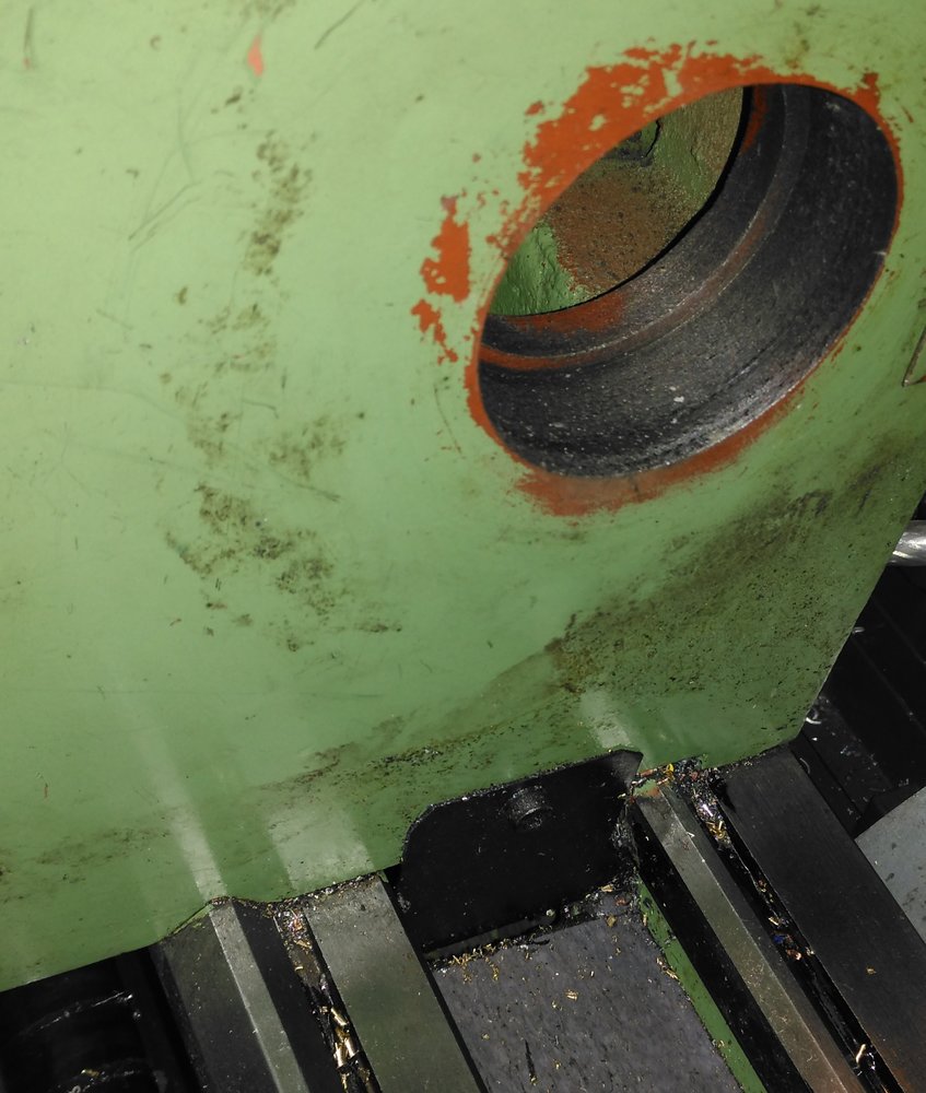

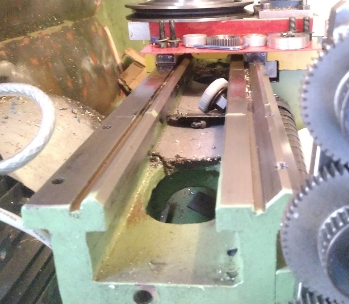

Try to keep lathe clean, protect the ways, and new felt wipers recently, and plenty of oil but somehow not enough. Ive got some newish score lines on the flat part of my bed and think there is hard swarf trapped under the saddle, so it needs to be stripped and cleaned, and I will check the apron gears while its off.
I dont remember if there are locating pins or just screws, if or how I realigned it last time. Is this going to mess up the cross slide alignment?
