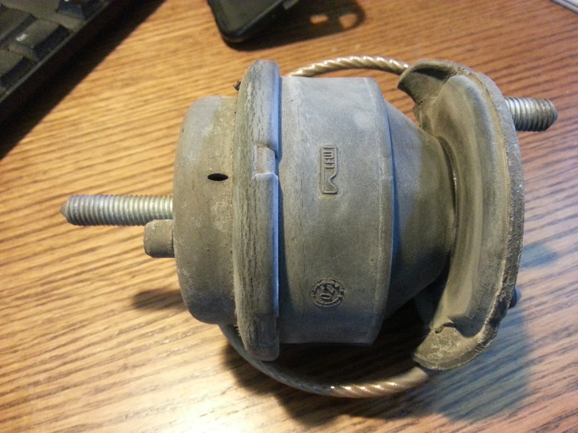

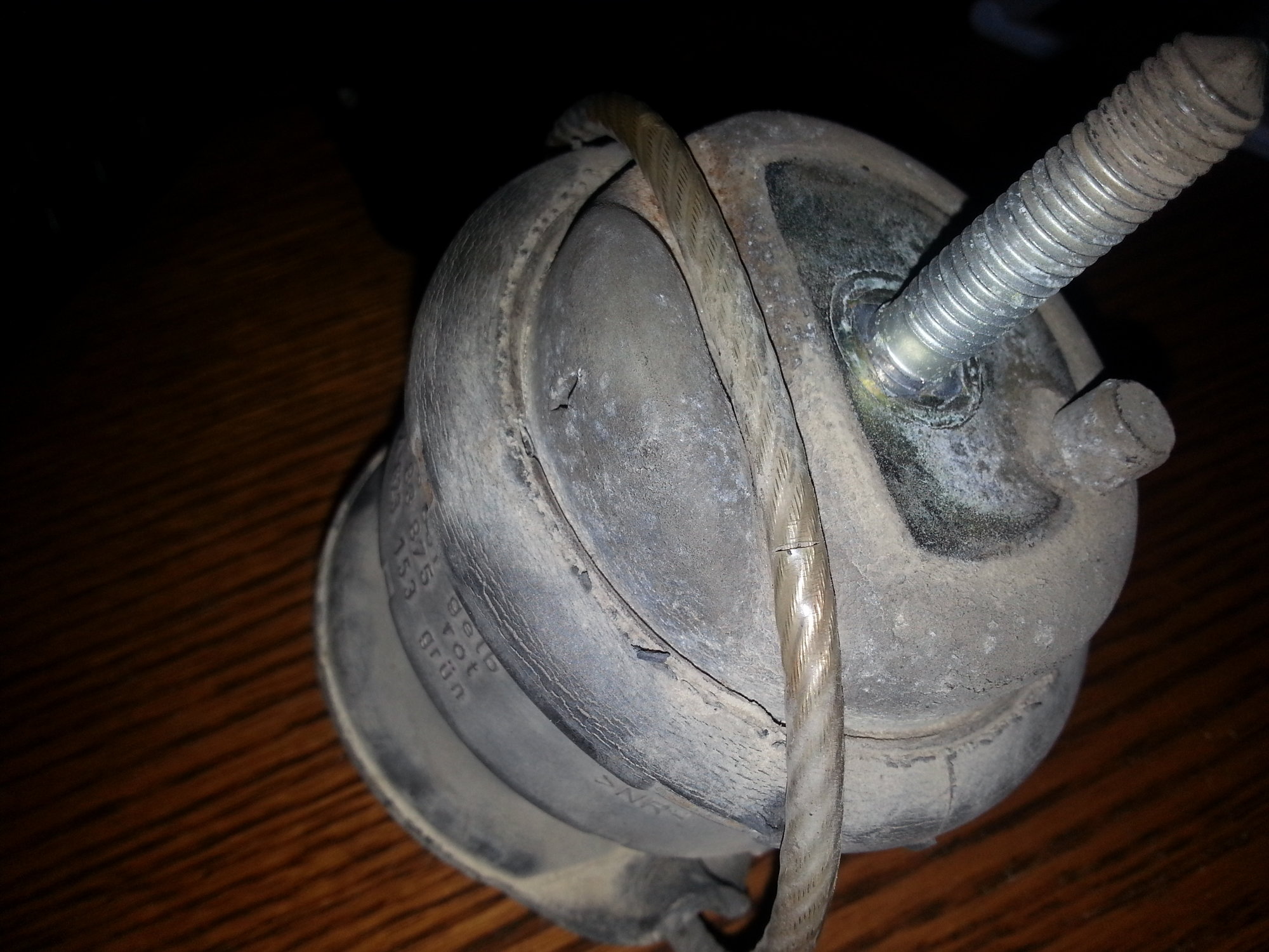

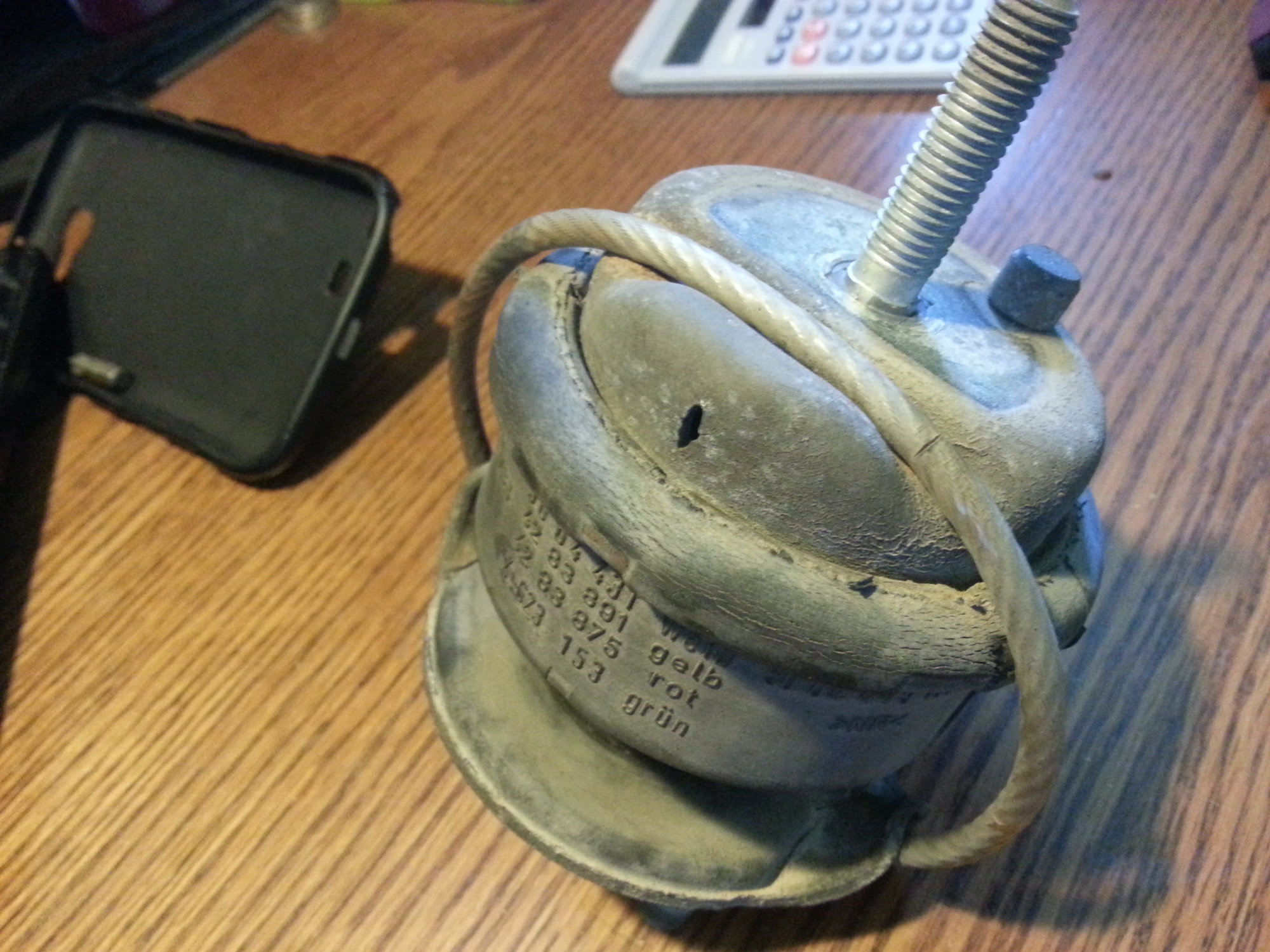

It'd be internal, they do sometimes leak the fluid out if you can see it, but usually the only sign is the upper cone has flattened out a bit like yours there.
If you can grab it in a vice and bear up and down on it with a bar or something you can sometimes feel the slop/play in it by hand if they're bad.
