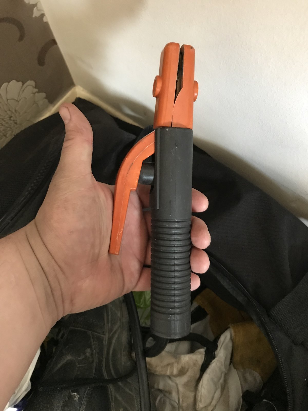

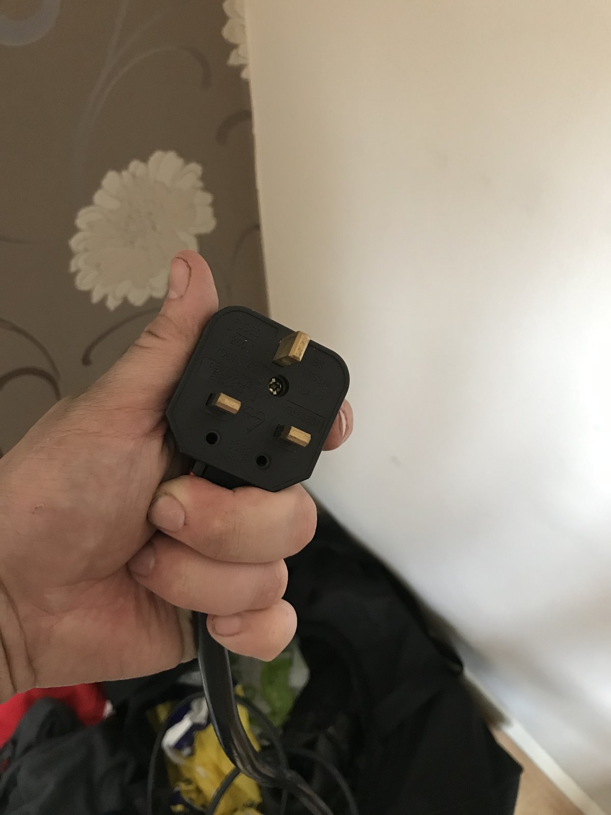

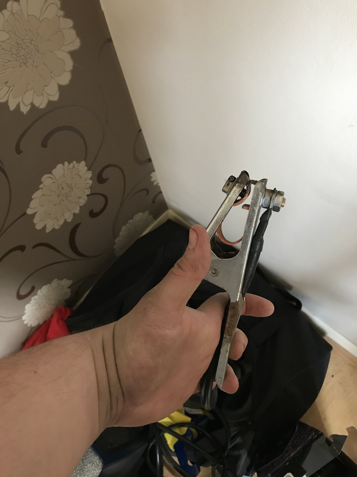

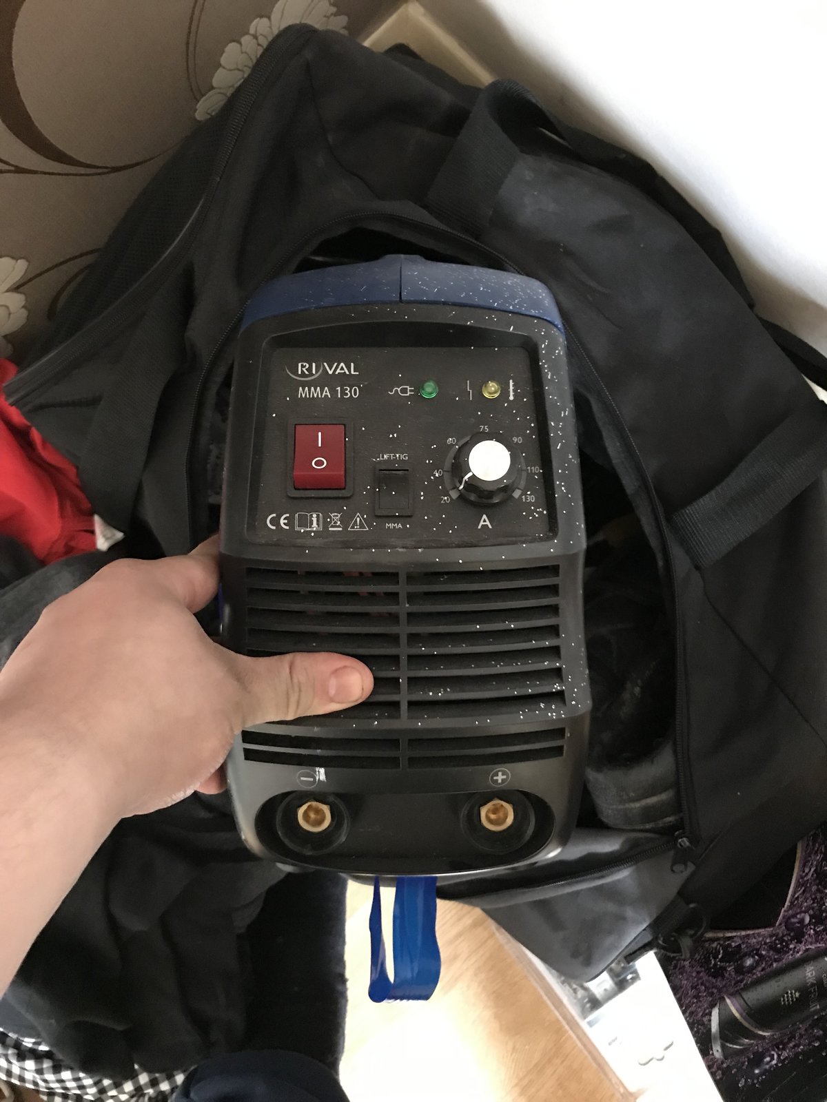

Hi has anyone else used one of these sets for stick welding,mine seems to run pretty ****ty ,is this because its on a 13A plug or..?
Like ..hard to get the arc going and when you get it going ..hard to maintain itwhat do you mean exactly?****ty how?
Are you running the welder with an extension cord?Like ..hard to get the arc going and when you get it going ..hard to maintain it
what brand would you reccomend mate il keep you posted of the outcomeHave you tried decent brand dry rods? I have a box of diy shop special rods that do that, swooped to decent rods and the problem disappears.
Esabwhat brand would you reccomend mate il keep you posted of the outcome
