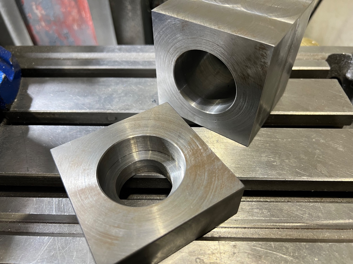

S Shiny Steve Member Messages 314 Location kent Yesterday at 5:06 PM #1 Any one else suffer from this disease, it’s incredibly irritating. These were machines last night and left in a warm dry factory. IMG_2391.jpeg 443.6 KB · Views: 36
Pete. Member Messages 14,839 Location Kent, UK Yesterday at 5:08 PM #2 I keep a spray bottle of duck oil thinned with brake cleaner. A quick spray stops that happening.
BrokenBiker Member Messages 11,231 Location Newport, South Wales Yesterday at 5:40 PM #3 i spray all my machined parts wit light oil if they are to be sat for any more than a few hours
Erie Fred Member Messages 5,951 Location Erie, Pa USofA Yesterday at 6:16 PM #4 I recall reading of this many years ago. Has something to do with your Ph level.
S Shiny Steve Member Messages 314 Location kent Yesterday at 7:46 PM #5 Good idea Pete I normally give things a dose of dw40, all my woodworking machines get there tables waxed at the end of play time.
