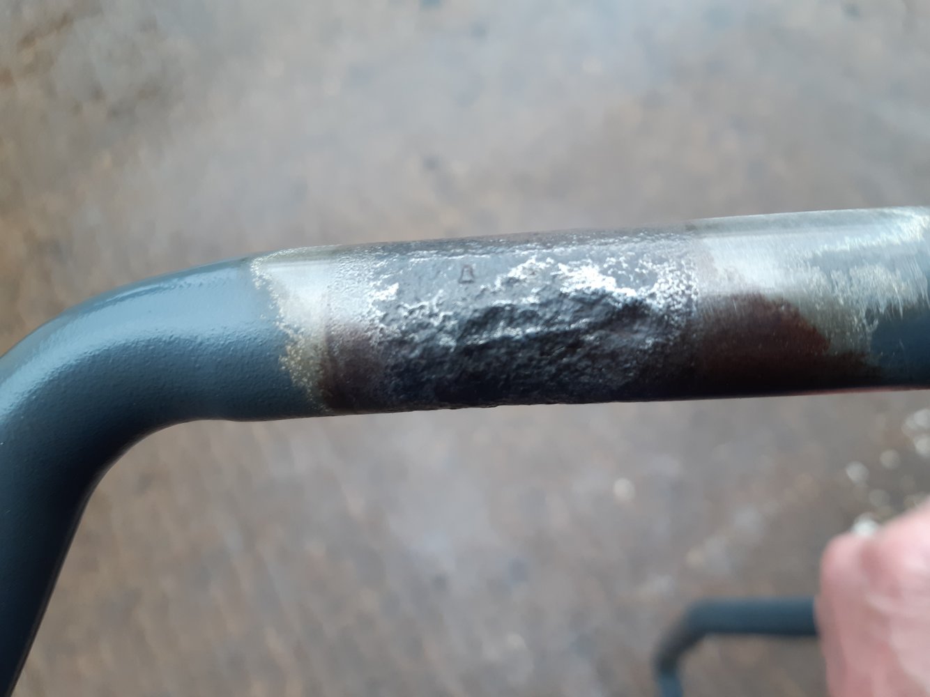

crevice corrosion, trapped moisture between the clamp and the pipe. Fairly common, relatively easy to fix though, make sure the joint is dry and coat with a wax type coating, can't remember the name of the stuff we used to use offshore, but was like a parafin based wax...
will have a dig and see if I can find the name of it...
