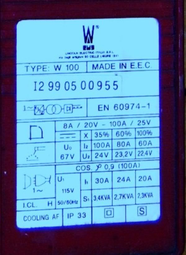

I was thinking of my small 110volt Lincoln 100 amp arc inverter ?
lincoln inverter specs
just cant seem to find my manual on the Lincoln website. Otherwise that'd be the first port of call.
Someone has asked me about whether or not its ok to run an inverter welder off a generator, "as its supposed to be bad for the electronics" ? First ive heard, but does anyone know if its true ?
