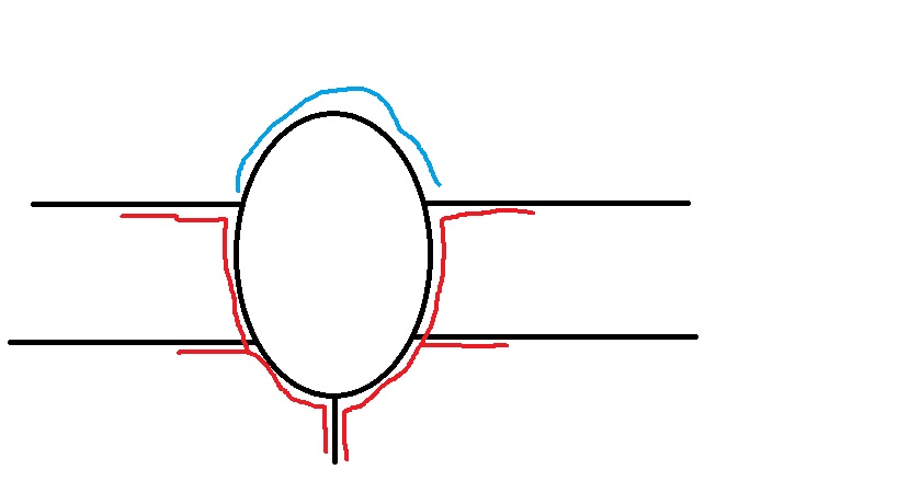

Any advice?
I've got a belt driven compressor with a 120L tank as well as an additional receiver tank of 150L in the loft
space already
working area is 3.5m wide by 5.5m deep
I'm going to run the ring in the loft space rather than under the ceiling (cooler up there)
I'll be using steel pipe threaded
Plan on 4 drops each with isolator valves
And a valve arrangement to bring the additional reciever tank into play or leave it out of the circuit
I read that drops should go up before going down less chance of moisture in the air
