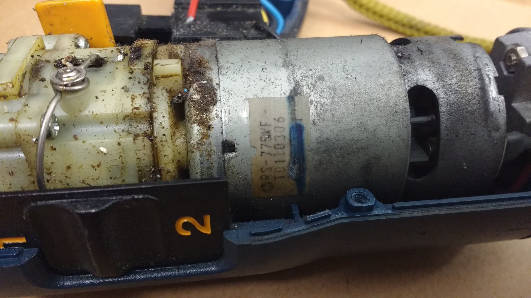

Mate has an old but heavy duty, 12V Ryobi drill. Originally 12V Nicad.
I was looking into making it run on his DeWalt 18V Li-ion batteries.
The motor is an RS775VF. From what I can make out they have a nominal voltage of 12V but will operate between 6 & 36V.

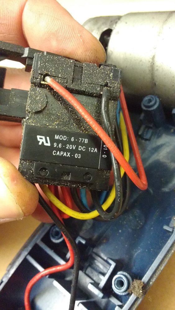

The switch on the drill says it's good for 20VDC. As I understand it an 18V Li-ion will put out something like 21V. Not sure if this will be an issue?

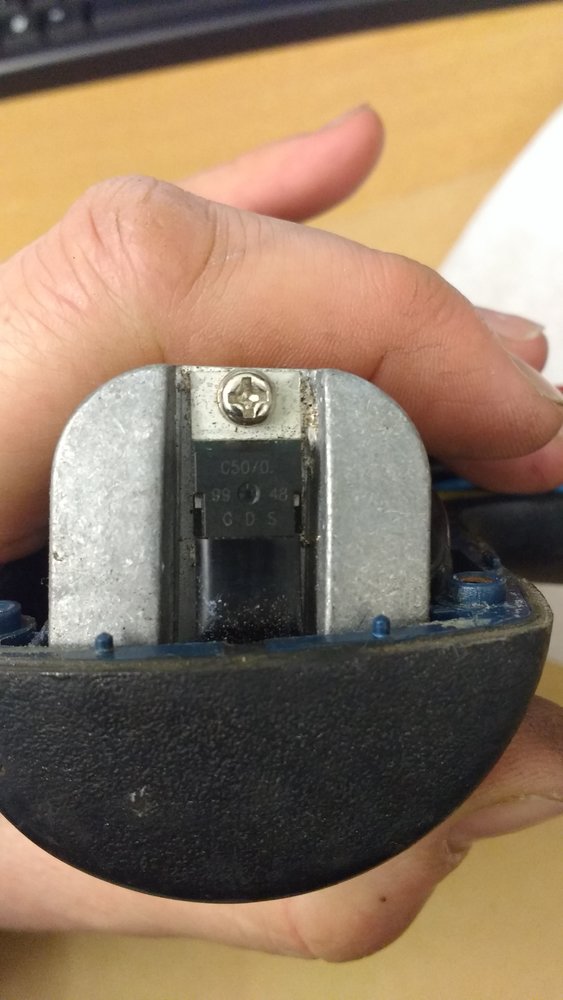

Lastly what I assume is a voltage regulator. On it printed it says "C50/0 99 48 GDS":
Seems the switch assembly (that incorporates the regulator on a fly lead), is common to the STP 1201, 1401 & 1801 models so 12/14.4 & 18V.
Just tried running it on an 18V Makita battery and it seemed to run quite happily.
