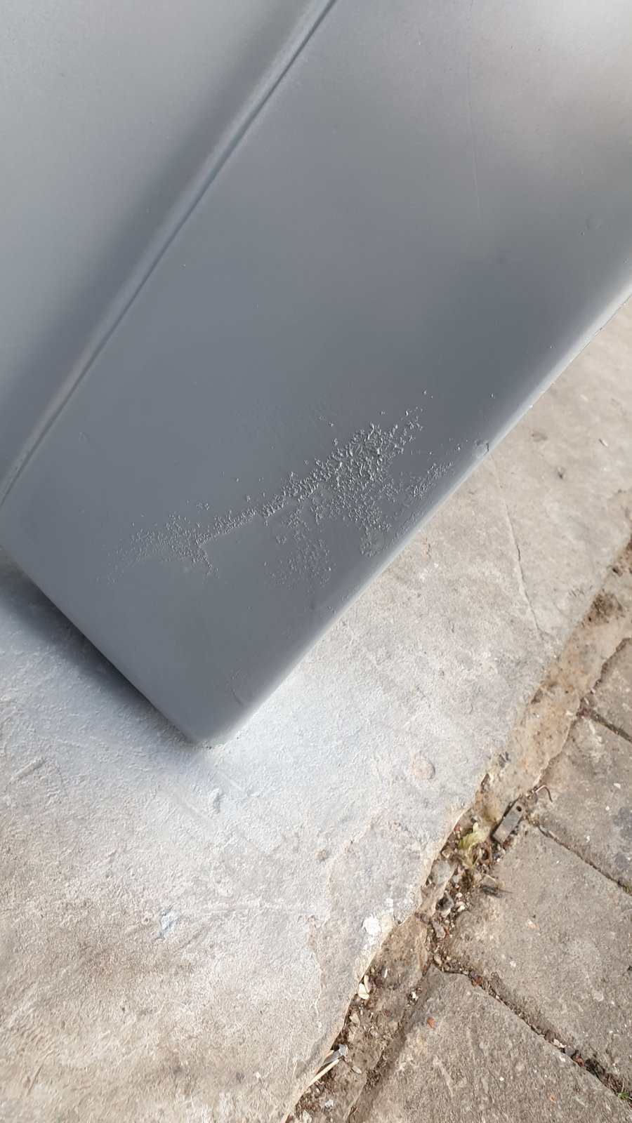

My best guess from the picture and my personal experience would be that it is a paint reaction.
I've had it before myself a few times wasn't sure if I was on too thick or old paint interfered but I solved it by scraping and then re-priming but lighter coats rather than laying it on quite wet.
