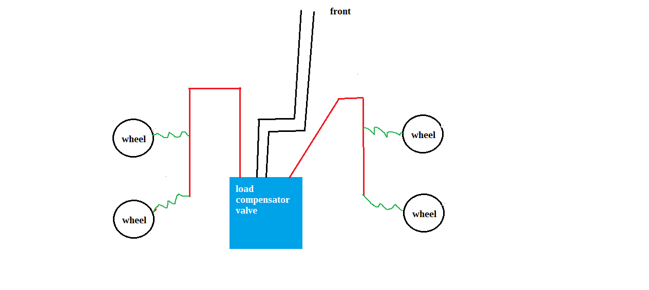

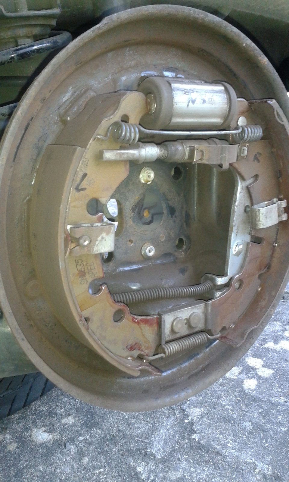

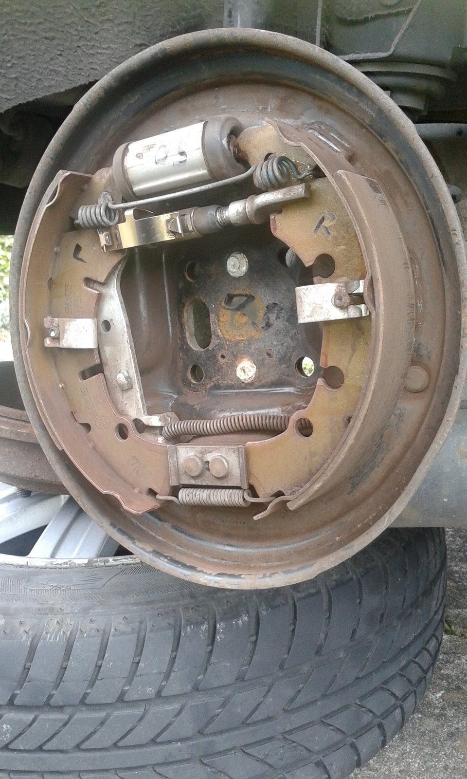

I realised since fitting my suspension that actually moves (instead of the seized old stuff) that I have not seen how far it compresses with a car on the back, so I put my old Vauxhall Astra on the back and noted that the suspension went down about 3cm, I slid underneath the truck and found that the actuator arm on the load compensator valve had not moved at all from the 'fully off' position.
I whipped the car off the back and jacked the rear wheels off the ground then used a block of wood to jam the brake pedal down, found I could rotate all of them by hand with some force.
I then wedged the load compensator to 'fully on' and found that the wheels were locked solid.
so I guess the suspension doesn't compress enough to actually operate the load compensator with a 1200kg car on the back.
