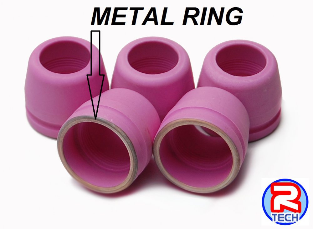

Hi do any owners on here know the generic model number of the red torch with yellow trigger guard that is fitted on the p50HF? (i don't have one yet else i would look!)
I am trying to find out if you can get 3rd party consumables but can't find a torch that looks the same online (there are similar but with a different style of head on the torch)
It appears from pics at least that p40hf (WSD-60P) tip and electrodes would fit the p50HF? Anyone know if this is the case? I appreciate the ceramics are different (the p50HF having a metal strip on the back) so would also need a 3rd party source of these.
Cheers
