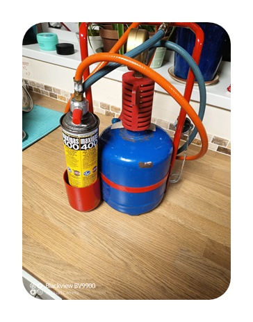

I saw this little piece of kit and bought it.

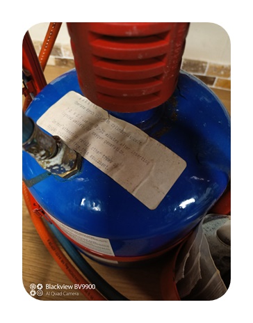

I've been able to look at it closely and the oxy tank, the blue one, was used with solid oxy-pellets to generate oxygen. They're no longer available to buy, can't think why!
Haven't taken the top off the blue tank yet, needs an evening without work to have a play.

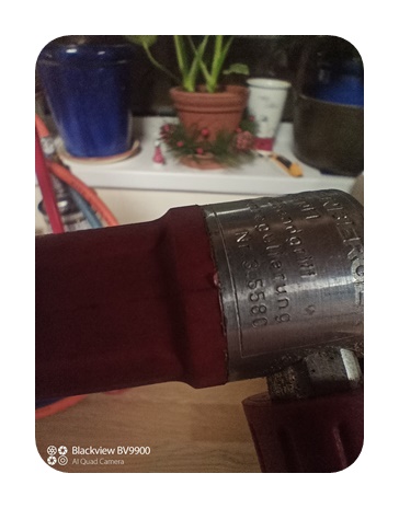

The porch is a Roxy-Profi 35580.

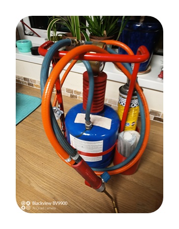

Has one regulator for the maxi gas but the oxygen just plugs straight into the blue cylinder.
What kind of usage does the small oxygen can give, and should I be able to swap out the maxi for propane using the same regulator?
The rest of the frame is good and if I can find a source of oxygen to refill the blue bottle, I'm questioning what about a regulator for the oxygen?
If I decide to go with 2 x small bottles then I may make the blue bottle a tool and rod storage place. Cut the top off and use it as a lid and make a storage container for bits, rods, maybe a spare can etc.
All input welcomed, and have a great Christmas.
