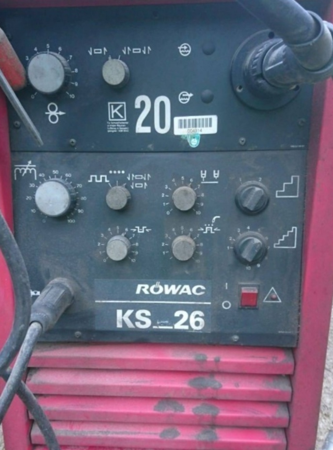

Greetingsto all, I bought this device but I can't find the user manual anywhere, does anyone have a pdf to send me or can explain to me what all these marks mean, thanks in advance!

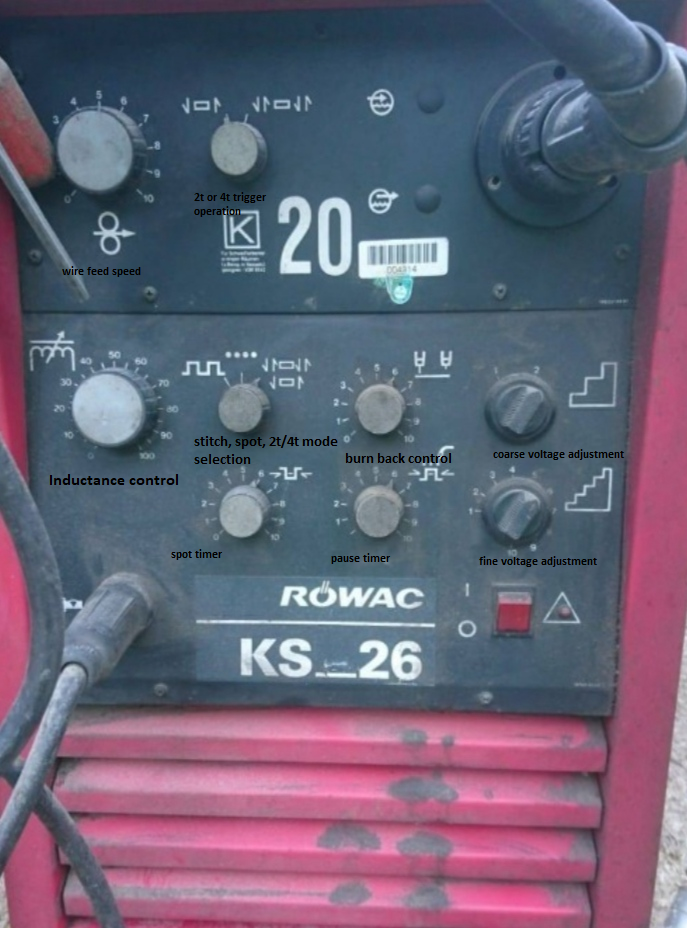

This, basically, let us know what bits of this you understand and we can fill you in on the rest (or you can google it), also i may have the timers the wrong way round
