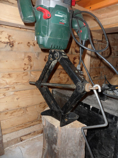

I use my table router quite a lot and it drives me mad crawling around on the floor trying to get the height right.
I looked on the internet at commercial lift thingies and screamed at the prices.
Looked at the home made versions and laughed at some of them. beautifully made hand cut wooden gears, all sorts of weirdness.
Then cycling to work I saw a car jack in the hedge got to work and chucked it in a corner. Found it a few weeks later and thought hmm it go up and it go down.
So I did a brutal lashup intending it to be a temporary thing.
Perfick.
The only problem is not winding it up too far and lifting the workbench.
The log is bolted to the floor.
Chunko'.
