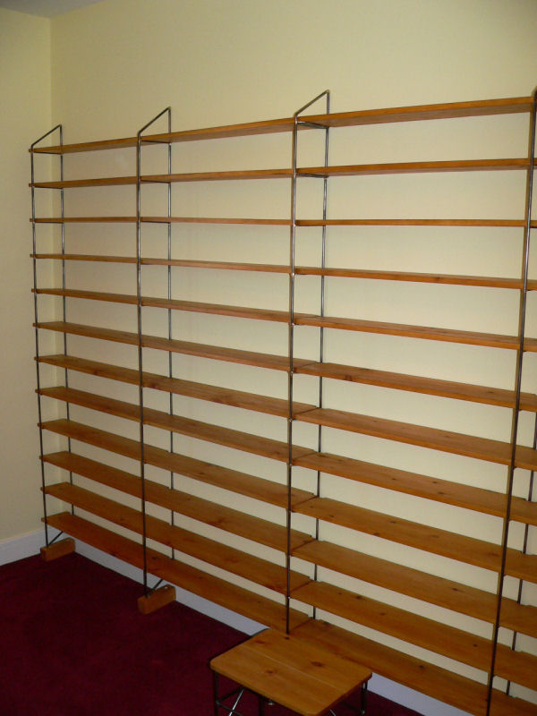

as well as sculptures I also turn out bespoke shelving units, mainly for Cd's etc. I use wooden shelves and brazed steel frames, I have made dozens of these things over the years.

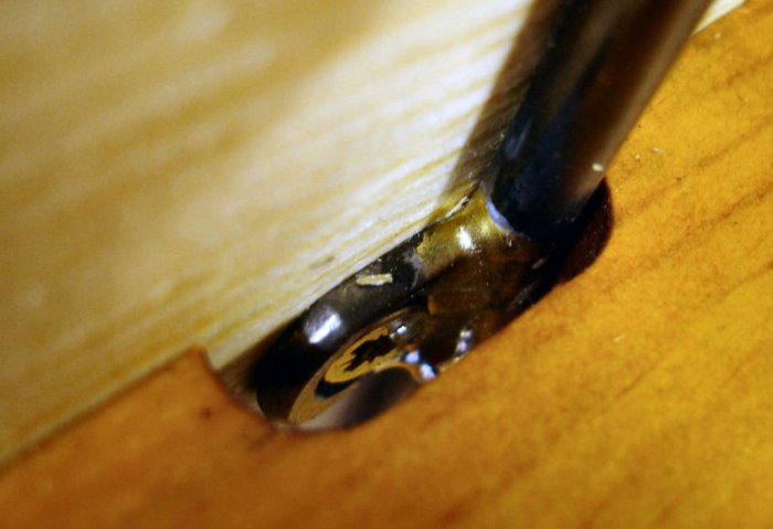

I bought a new router a while back and some new bits to go on it, it used table mounted for one specific job. making a smal groove in the back of the shelf for the frame to run inside.
The groove is about 10mm wide and the same deep in the back of each shelf where the frame passes, there is a good close up shot at the bottom of the page in this link http://www.coolshelving.com/page2.htm . Not a huge amount of machining but it has to be right.
Anyway. The old router bit was getting a bit tired, so I bought a new one, 12x30mm twin flutes. It splits the wood to hell, delayering it along the grain, I bought another bit today, made by Trend,just the same result. I faffed about for ages trying going slower, speeding up the router, working with and against the grain. but the same bloody awful mess.
The I put the old bit back in and perfect! a bit of overheating but hardly any damage to the wood. You could see a stream of sawdust flowing into the vaccuum extractor thingy, with the newer bits it is a cascade of ships all over the place.
Any ideas? one theory is that the new bits are too sharp and are digging in and trashing the wood.
To feed the wood in I have one end pressed against the back stop on the table and slowly rotate the timber onto the bit, this avoids snatching etc.
