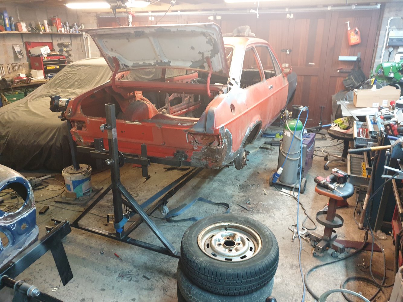

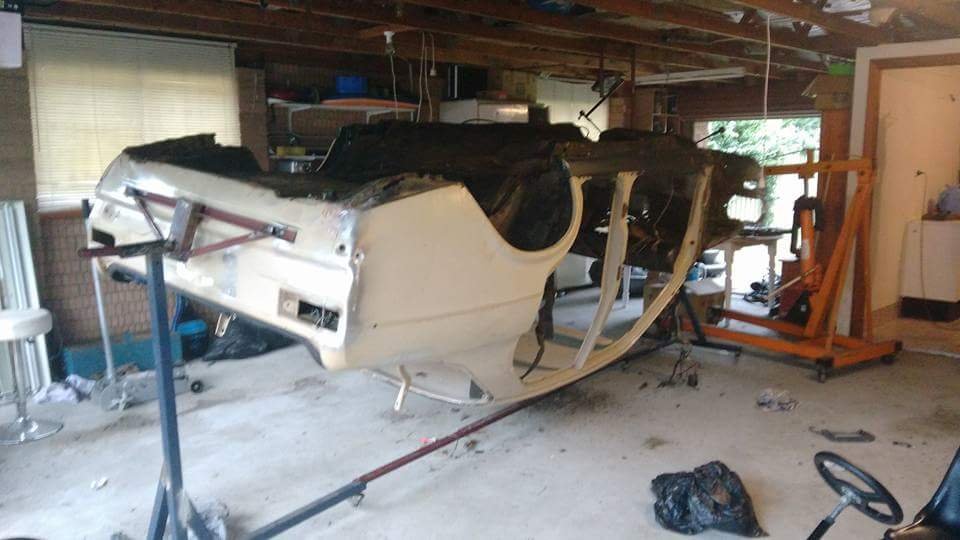

Great. What's your rotisserie like? Any regrets? And suggested tweaks. Just sketching up the plans for mine now.I wouldn't fancy having one on wheels without a brace but the pair I have with no wheels are fine without it.

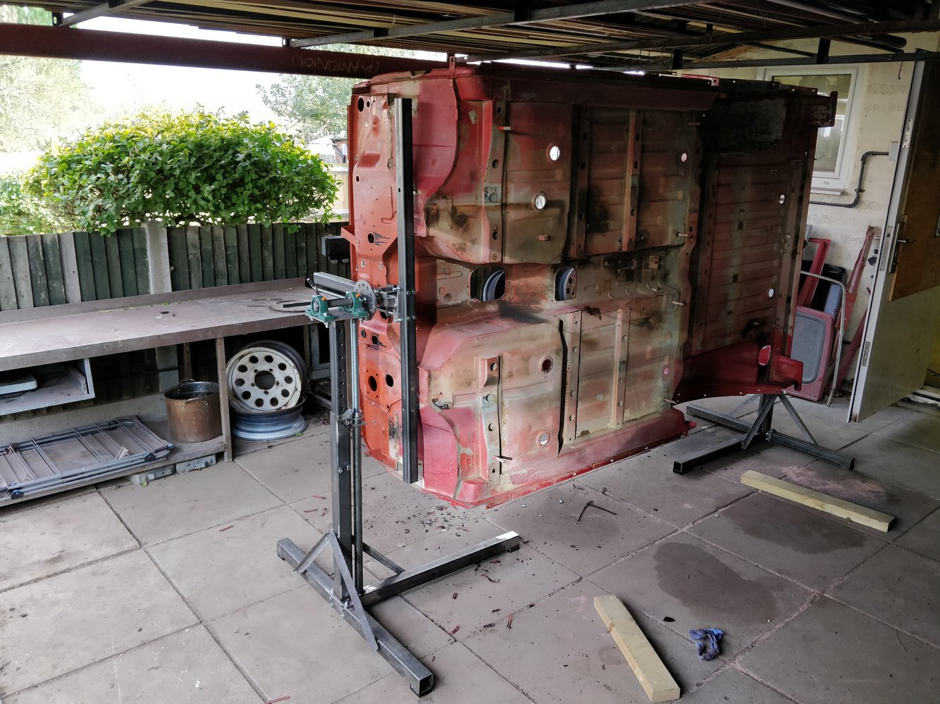

I was going to suggest two engine stands as a basis for a rotisserieBuilt mine from two engine stands , and unless I move the car in the garage the crossbar is unnecessary, but having the bar means moving the shell is far easier , I simply clamp a piece of 4x2 with a couple of g clamps then remove it once done.
Mine's the same - no wheels, no centre brace. I have a fairly rough floor, so I wouldn't fancy moving it about even if it were possible. I have enough trouble with the welder trolley snagging on the rough concrete.I wouldn't fancy having one on wheels without a brace but the pair I have with no wheels are fine without it.

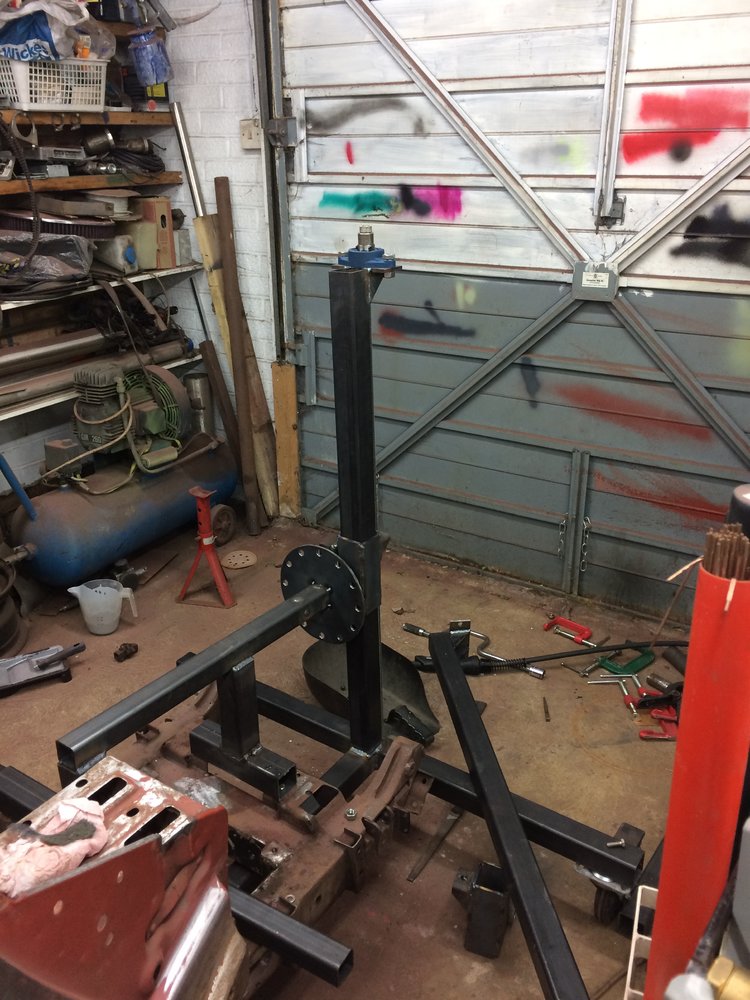

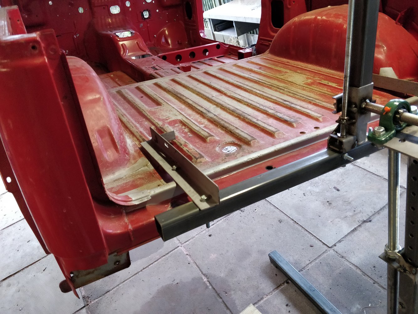

12mm stud on ours, impact wrench works wellI'd like to know what size/strength studding to use on the cross member levelling set up. Most seem to be raised / lowered using an air ratchet on the end of the long stud:
