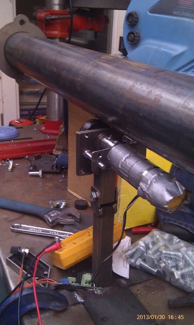

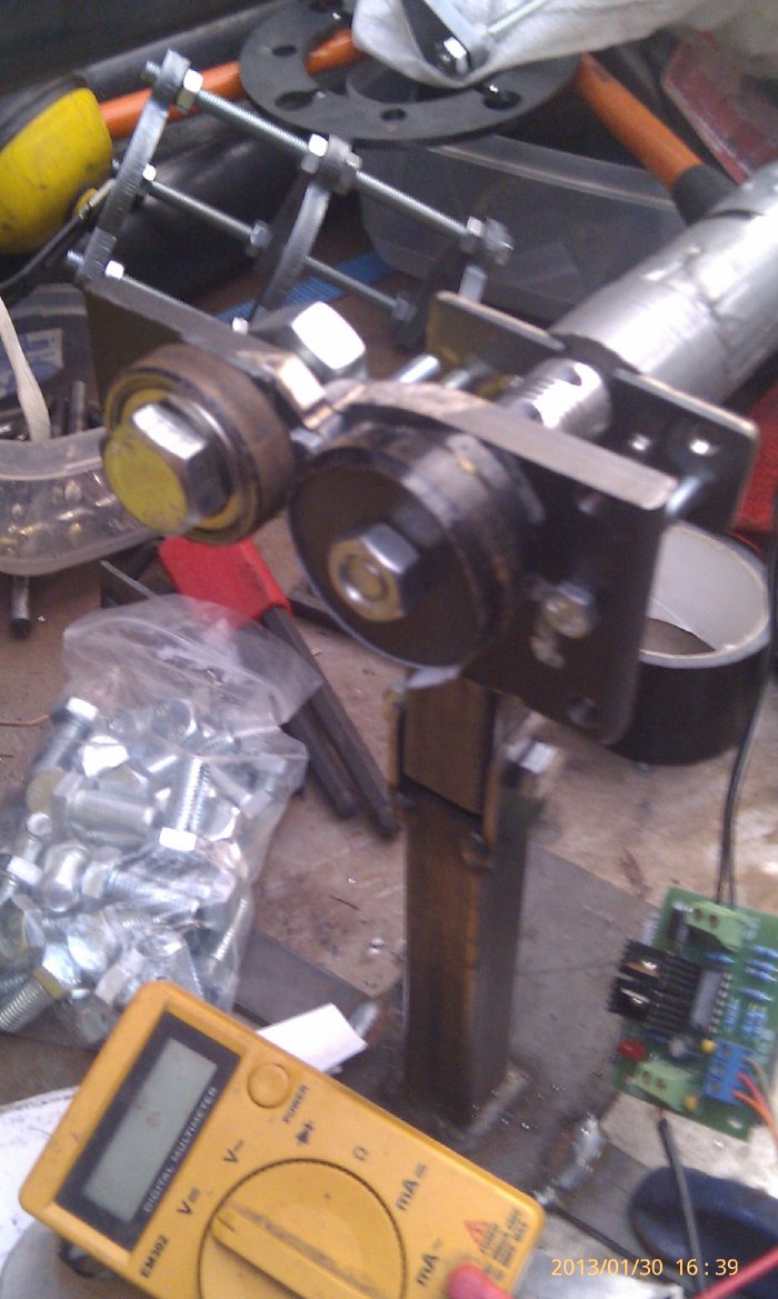

I'm looking for a solution to a rotating tube/flange welding jig. Flanges are welded each end to a 4m length of tube. The tube is supported, at thirds, by two sets of rollers - one set has a small dc motor that rotates the tube. As can, hopefully, be seen in the pics. It works "okay" at the moment and produces nice welds. The problem is I have a steel disc as the drive wheel attached to the motor and was using the contact between the disc and the tube to complete the welding circuit. The wheel started getting a lot of pitting due to the high current and small contact area which meant the tube started to slip - not good. The same pitting happens if the power goes through the bearings too - and the bearings start to get a bit "crunchy".. I assume the bearings and races are getting a lot of pitting.
I want to use a rubber wheel or something to drive the tube but also avoid routing the power through the bearings.. have thought about slip rings and brushes.. perhaps a copper strap that loops over the tube that the negative can connect to. Was wondering if anyone has come across a decent solution to this type of problem? Any thoughts greatly appreciated.
