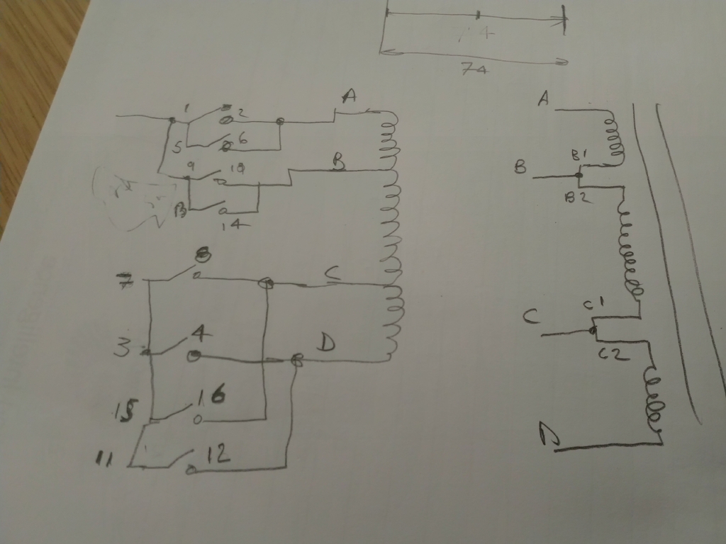

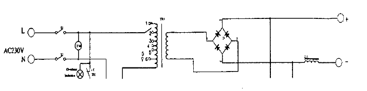

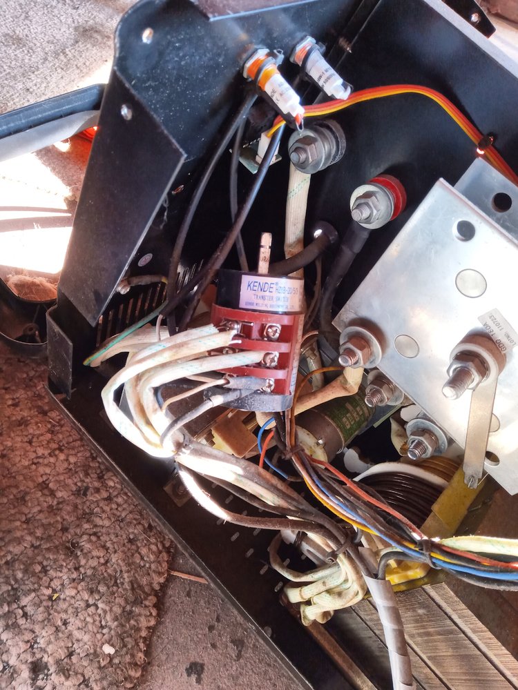

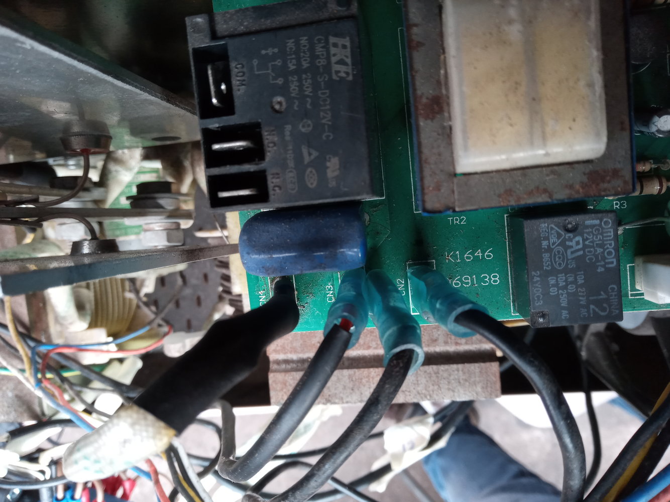

It looks OK to me CN3 & CN4 are just to the relay contacts. CN4 looks like it is the wire to the cold end of the primary, CN3 is a piggy-backed spade connector which is different to the circuit diagram we have.
Where do the two wires that are CN3 go to. One should go to the neutral but the other one ?
Also, can you confirm CN4 is direct to the transformer ?
