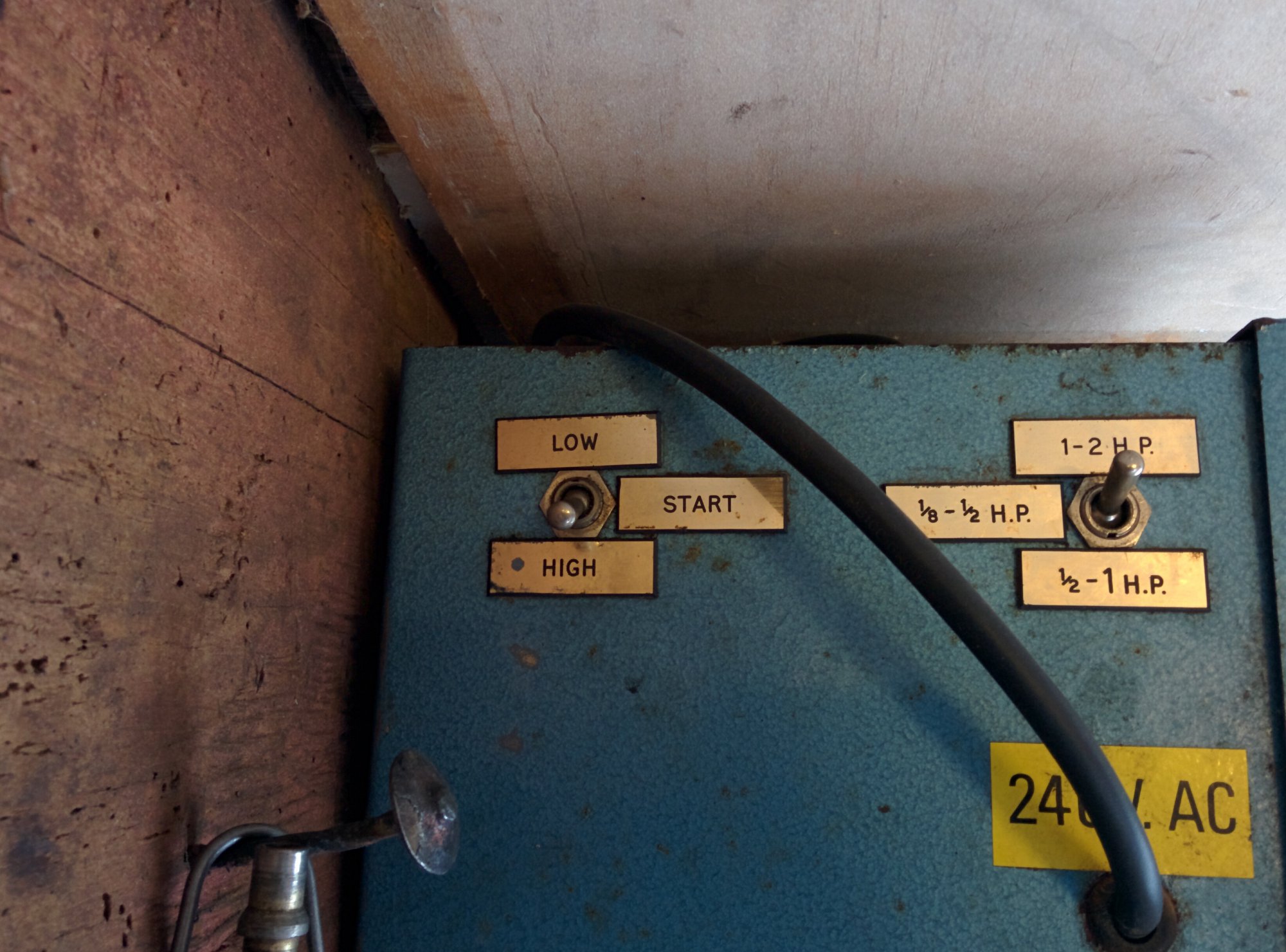

Having read the transwave thread, I got thinking...
I'm not ready to go into wiring diagrams or details just yet but had a few thoughts on my single to 3 phase system.
Currently I have an old, static 2hp converter connected to a small network of 3 machines. With a few clunks and hums, it starts and runs them fine, including one motor which is 2.5hp although I don't make it work at all hard. I don't run more than one machine at once.
-with a decent sized 3phase motor, could I use the static converter to make a rotary converter?
-if so, would this be "better" than just the static converter?
-indeed, would it be any different to running one of the machines on idle?
I don't intend to get anything that needs particularly sensitive electronics or is particularly huge. For now it will be a case of "ain't broke, don't fix" but will be interesting to consider future options.
Thanks
