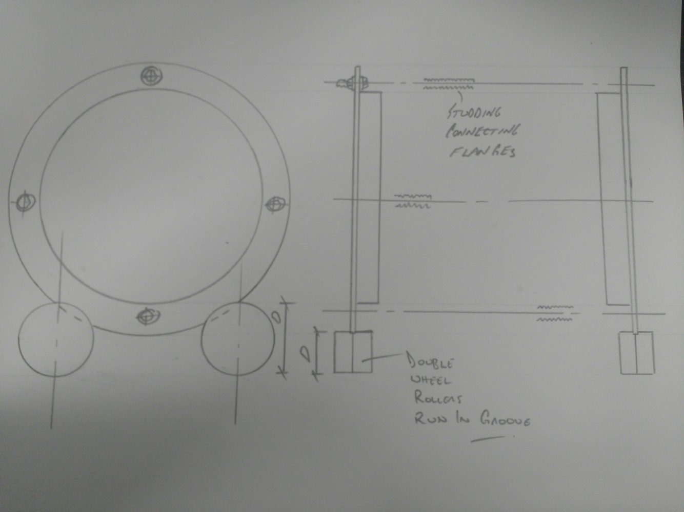

20 years or more ago my pal Paul had a simple 12 mm stainless mesh cylinder slipped inside his cement mixer protruding about two foot once secured in place , held in place with half a dozen short rubber bungees He had it raised up on pallets , the handles lashed it to a felled tree bole so it self emptied into the barrow without tipping too far over when tipped forward . Think he used the wood blocks off a big pallet to keep the screen clean .OK, a bit of autistic license on the roller diameter D, supposed to be the same!

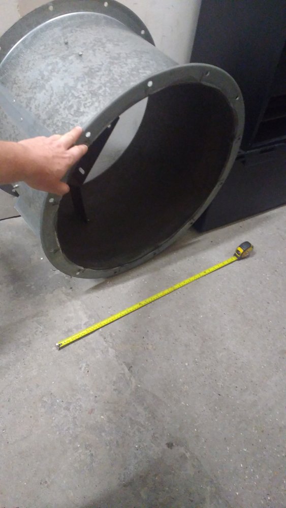

Rather than use the actual drum there are two flanges that might work as ends on the "cylinder". Linked together with studding.

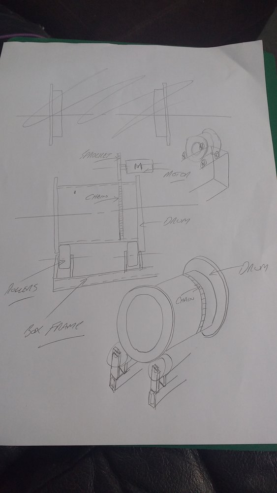

Mess around with a chain drive or just drive a roller(s)?
