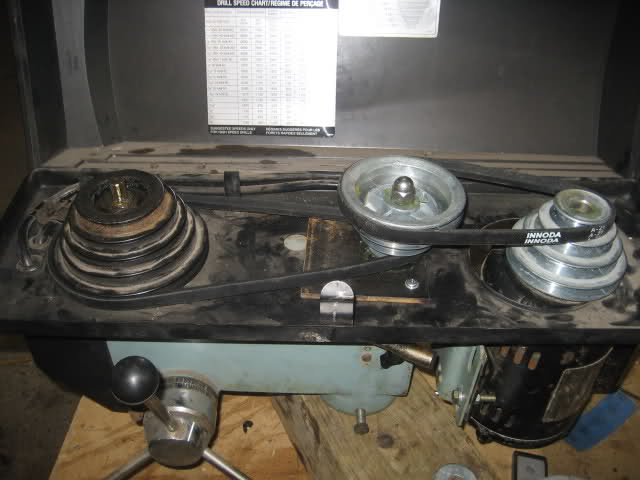

Do you know if I can slow down my drill press further? Its a draper 5 speed 2500 to 660 rpm. Need to get it down to around 200 for a roto to work well I would think.

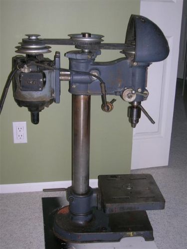

Can you show a couple of photos when you get a chance? What make of drill have you got?mine has a place to add a central idler step pulley - that gives me two-stage reduction (when i get round to fitting it)
