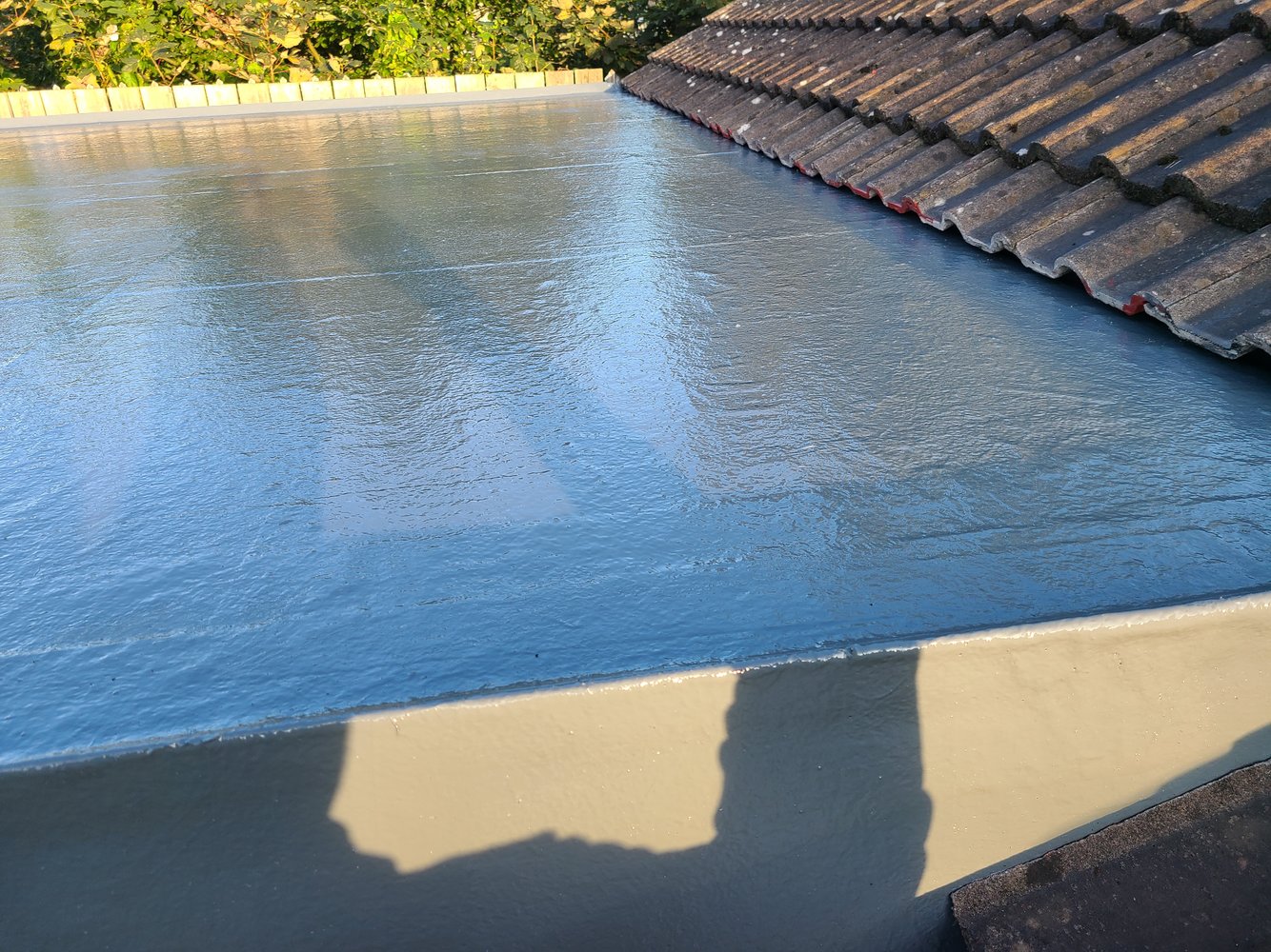

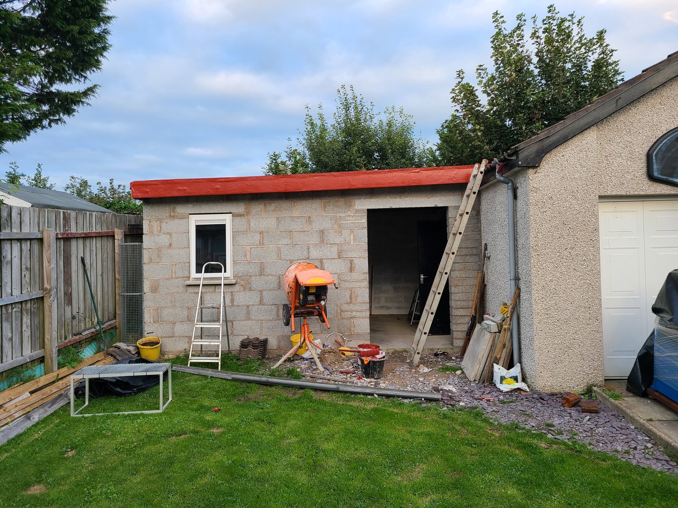

I've done a couple of GRP roofs. If you go on ebay, search GRP roof kit, there's two weights, 450g and 600g. I've only used 600g. The prices are all there for different SqM roofs. I think I bought the edge trims separate but usually discounted if you buy the kits.Out of interest and if it’s not a rude question, what sort of cost would that GRP run at?

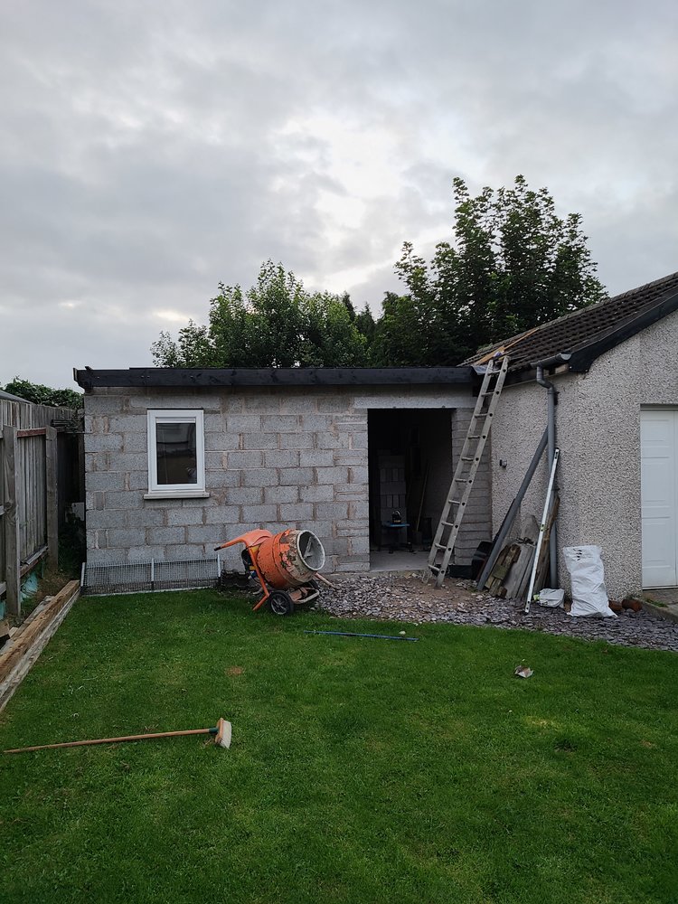

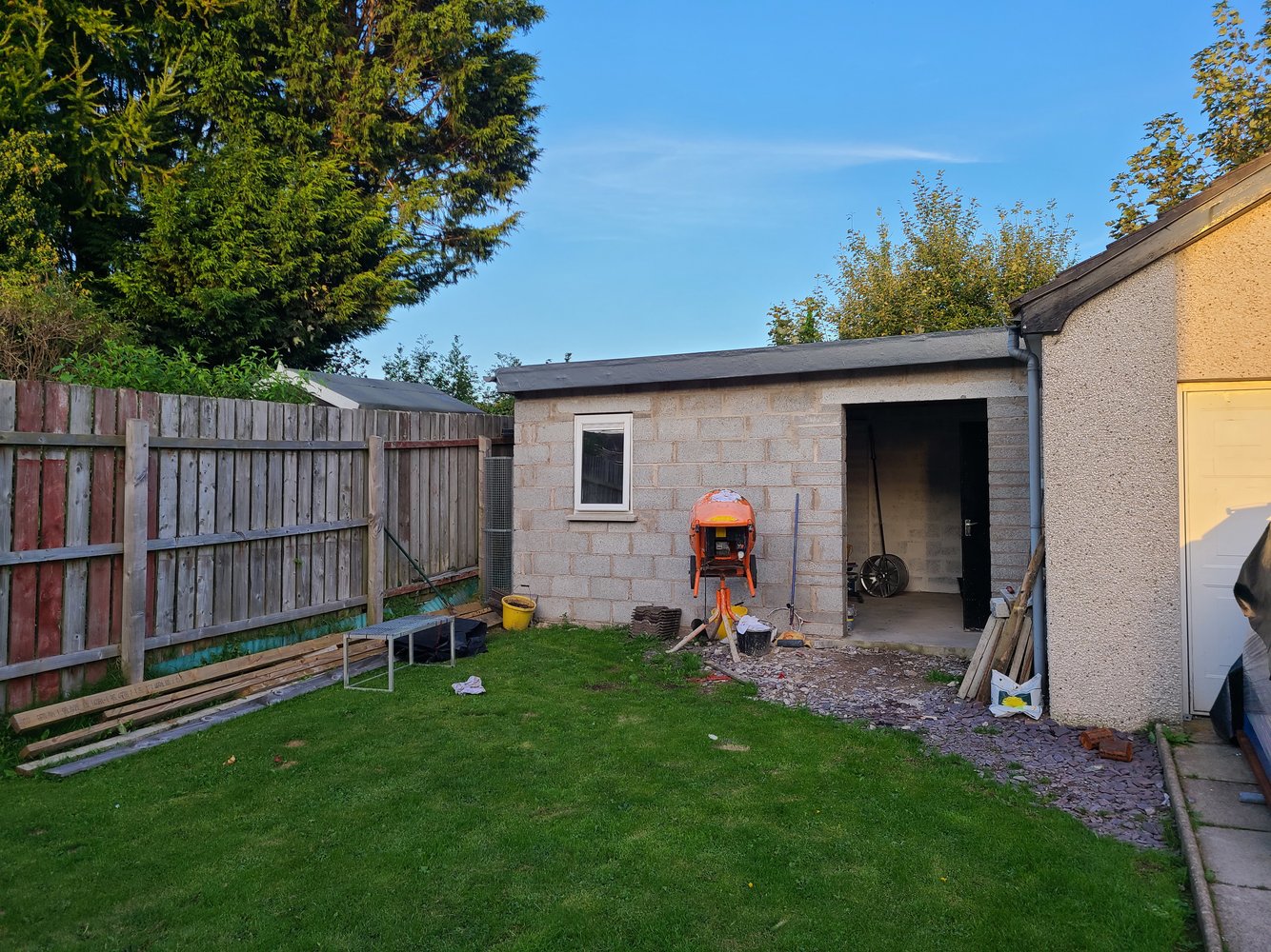

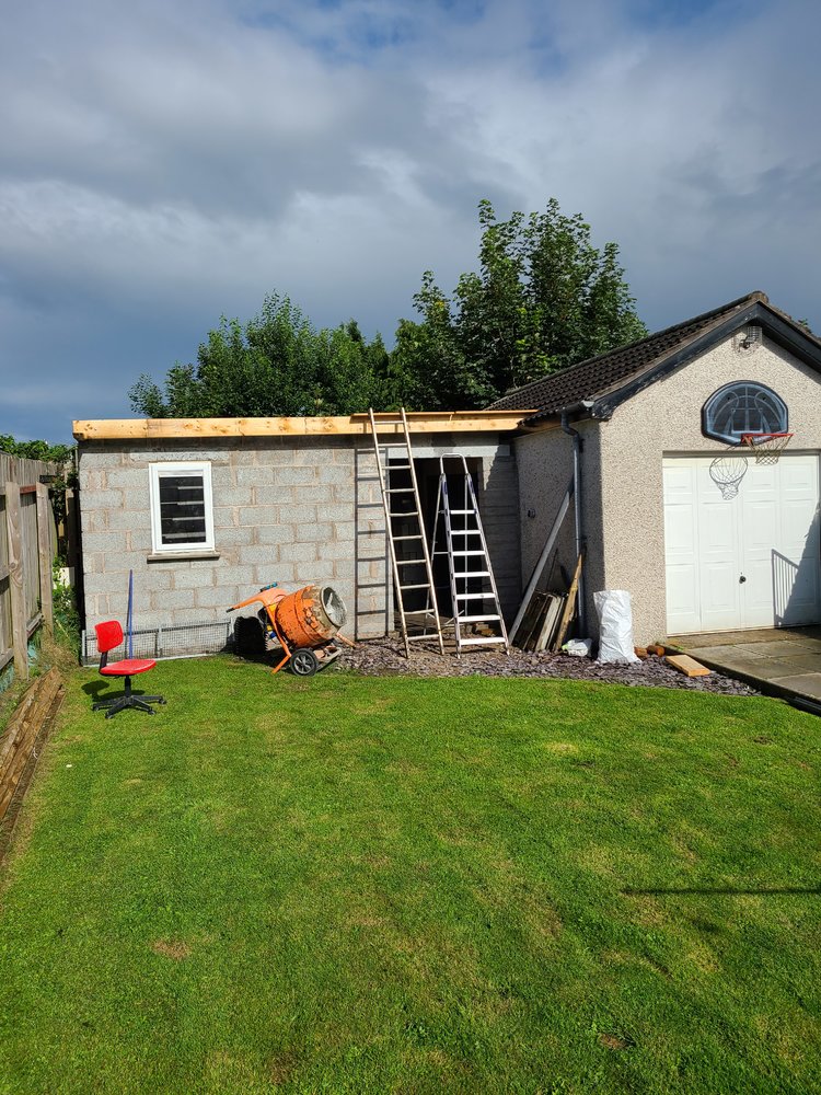

The garage/workshop at Wedg1e Villas is 30x9 feet or so and has felt over felt, it’s been patched that many tmes. Could do with a proper job.

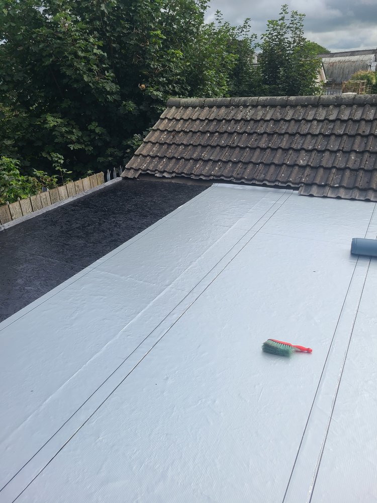

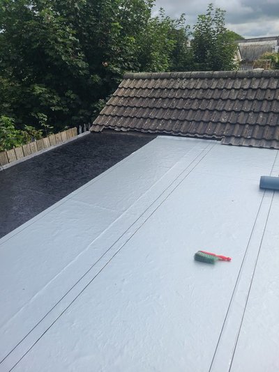

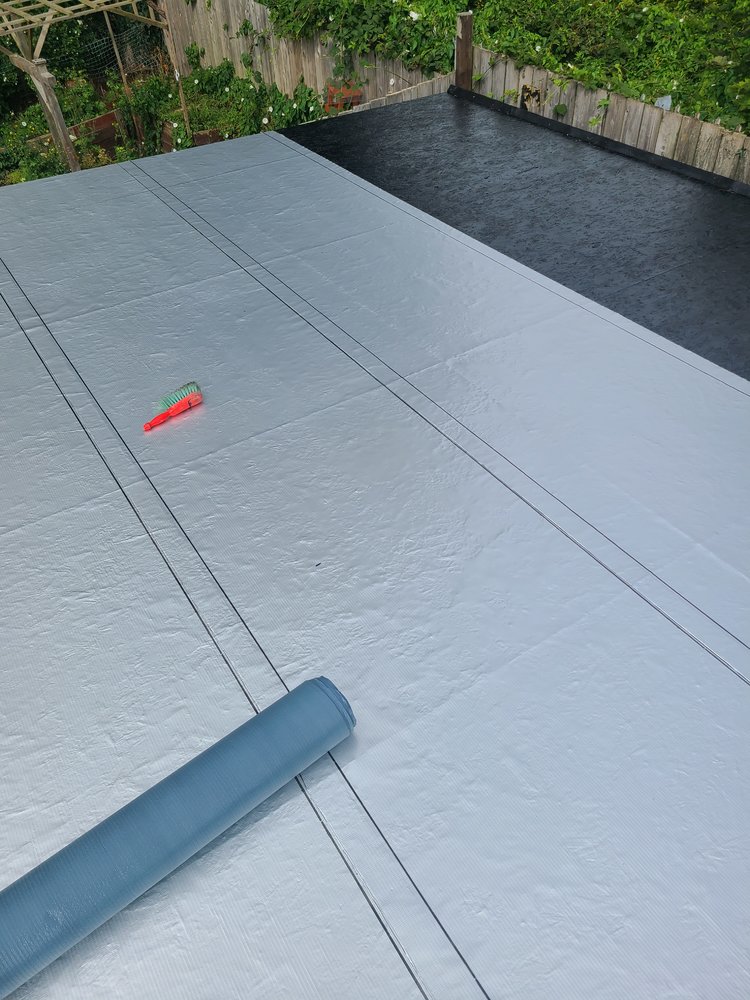

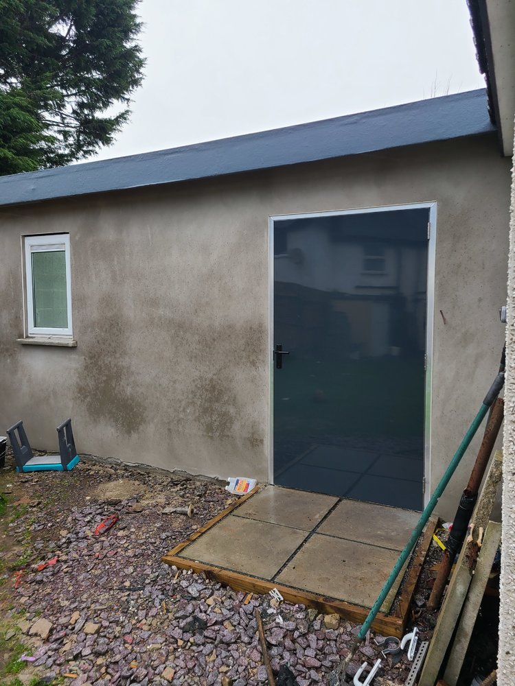

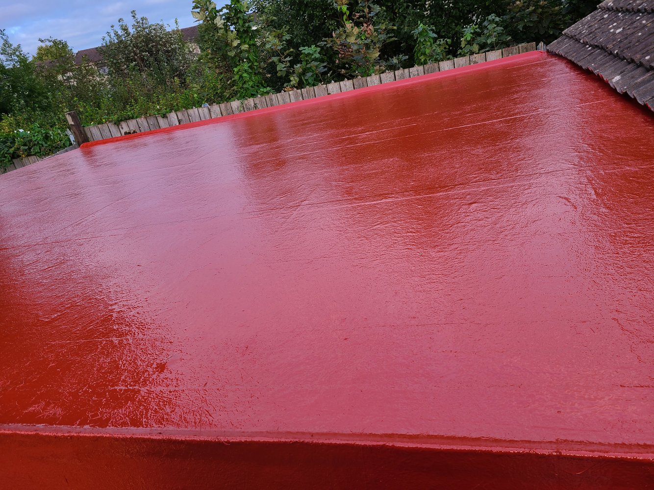

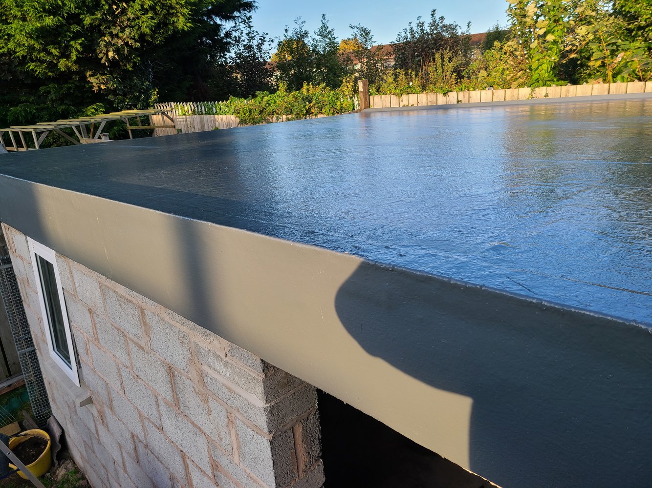

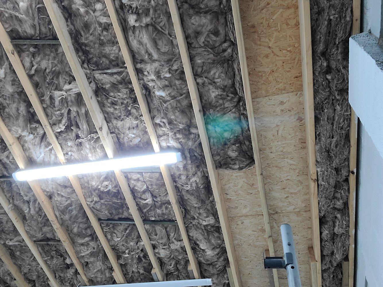

Hmmm. This looks a little different to what I've done. Is this still GRP chopped strand mat?The only Catch is, there is a bit of work involved
View attachment 419612 View attachment 419613 View attachment 419614 View attachment 419615 View attachment 419616
Grp roof is easier to do this involved bitumen paint over the osb board, then lay bitumen backed foil, then repaint that with red base coat you lay fiberglass sheet on top the red paint soaks through, and run the roller over then 2 coats of top coat grey, it looks and feels good, sort of like painting a rubber
